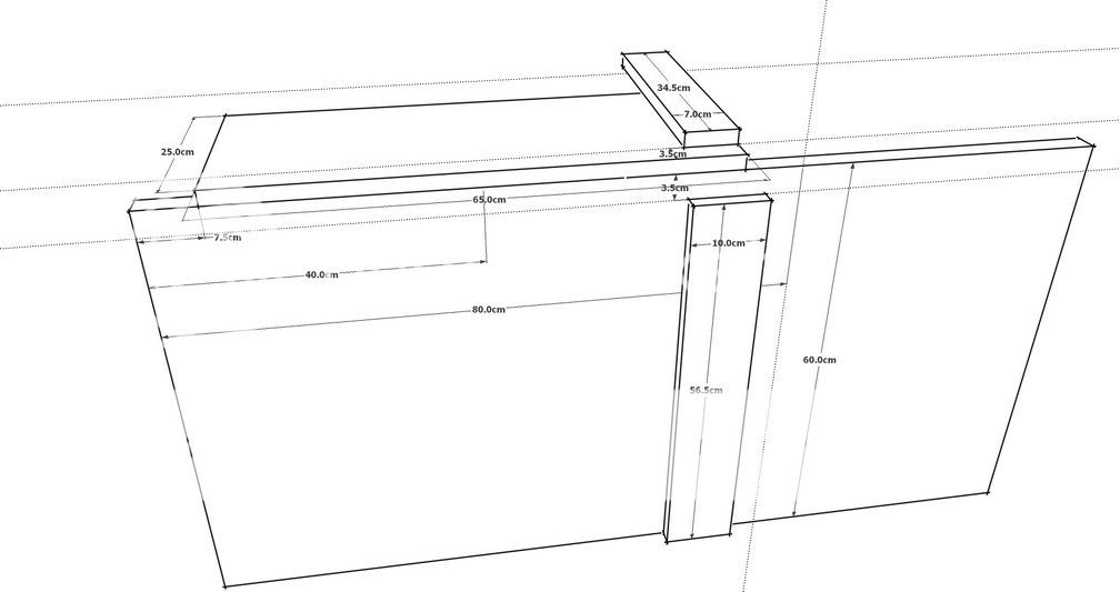

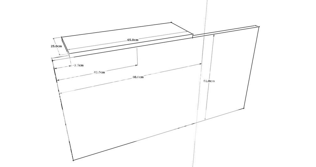

    Next I had to do a lot of research about bending acrylic because it's not to be taken lightly because the case itself relies on the bends. So I designed a bending rig.
    Only thing missing in the sketch are "stabilizators" which make sure the acrylic is bent where it's meant to be bent.

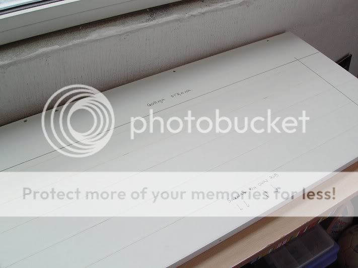

    So here is the first update. I started working on the bending rig.
    Taped and marked the cuts. The text says "top side" and "bend over this edge"

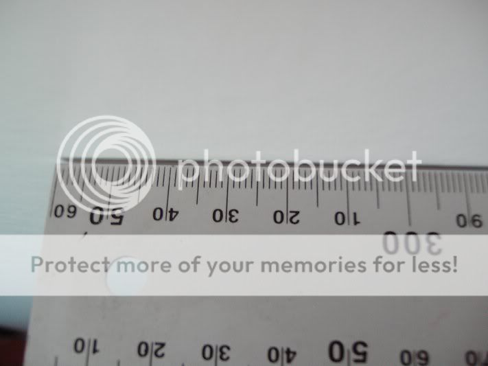

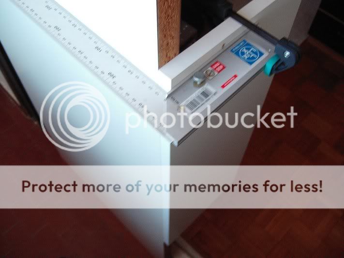

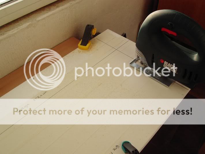

    Next it was time for some cutting. I tried to make the cut as straight as possible (not that it matters) just for practice.
    Cut!
    Next please.
    This one ended up more straight. I'm gettin better.

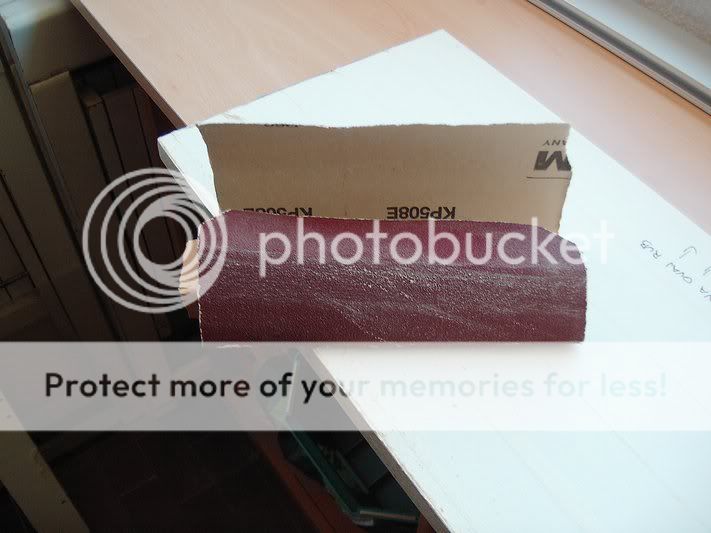

    Then sanding. First the edges.
    Next I noticed some bumps on the edge. (sorry for my poor macro skills)
    So sanded that too.

    Some nice sawing skills. But when i need to saw acrylic i just use a straight piece of wood as guide. This way i get always straight lines.

    @BlackWhizz I acctually tried that before but as I have a cheap jigsaw I found out that the blade isn't parallel to the base :grr:

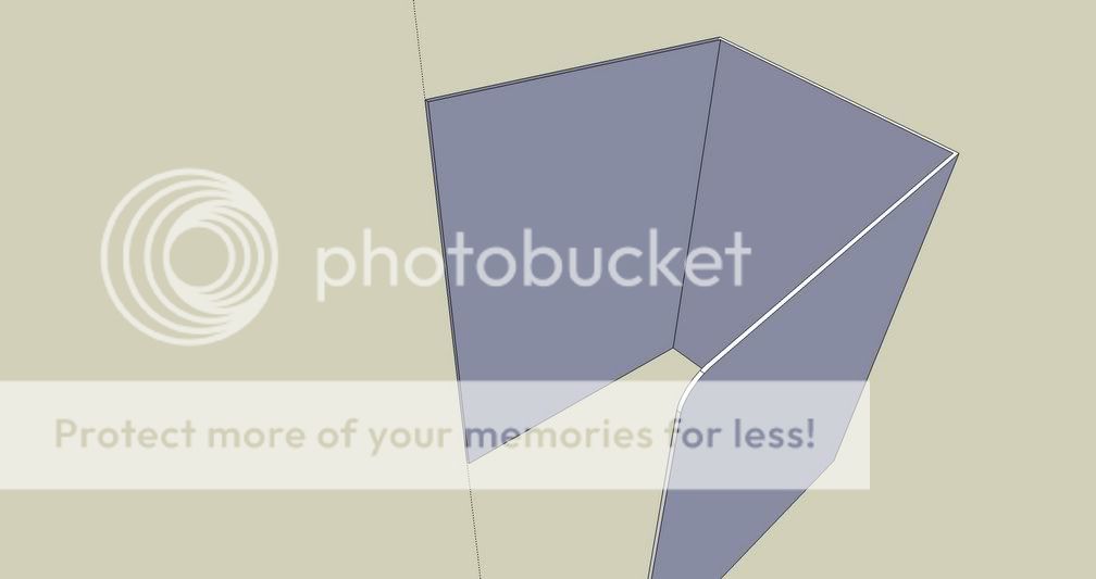

    @Editor22 Yes I've been worried about that but here is what I've come up with.
    As you can see those "stabilizers" (call them as you wish) will keep the acrylic aligned at all times so bends won't end up looking like this

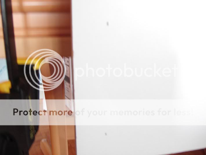

    Got back from vacation a week ago so it's time for new updates.
    I actually did this before I went but didn't have the time to write it.

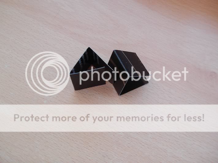

    I just inserted some carton between the 90 degree metal holders and the wood because it wasn't 90 degrees. Sorry for the blurry pictures as my hands get shaky sometimes.

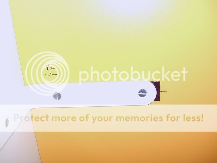

    A close up
    As you can see there is a bit of clearance which annoys me.
    So nothing a bit of carton (thin one) can't fix
    Cut down to size so it doesn't stick out.
    And here it is.
    And now it's better.
    Still a bit of but that doesn't matter.

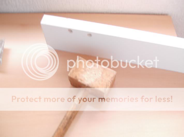

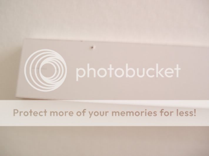

    Now the update from yesterday. I screwed down that plates of wood which will make sure the acrylic lines up correctly.
    I used the leftovers from cutting that wood plate from the first update.

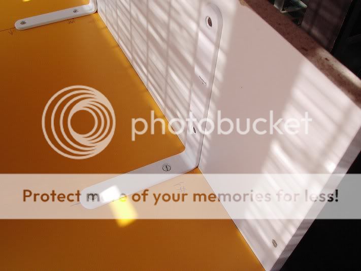

    First I clamped this aluminum profile I got from who knows where to make sure it has the space needed as it will hold down the acrylic while I heat it and bend it.
    Then I realized there was a bump in the wood so hammer time.
    Then I marked it for drilling and punched the holes so the drill doesn't run away.
    Drilled and a screw already in.
    Next the bending rig got two holes.
    And screwed down.
    This is a poster about Excel but it'll serve a higher purpose.
    I used it to mark a line where the other wood aligner goes but didn't have time to screw him down.
    So the only thing left for me to do is the other aligner and then I can finaly proceed to the actual bending.
