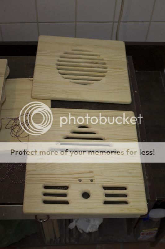

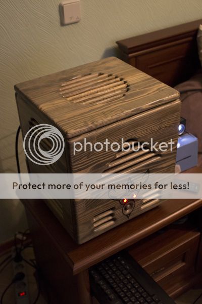

    Hi everyone,
    just wanted to share my new wooden micro atx project that is well on the way.
    In enclosed photos you can see dry connections of the case. I a lot of sanding to do before staining / varnishing.
    Only photos for now...i will leave more detailed description tommorow (gotta go to work :duh:)
    After sanding

    Update - Detailed info
    MB.Size = micro atx
    Case dimensions in cm (without legs) HxWxD = 34.5 x32x29, 7
    Material used = 18mm pine board
    Design is a classic stack (MB up, PSU and HDD below).
    Side holes will have mounts for 140 mm fans.
    Mb is installed onto aluminum tube inserts that have engraved thread.
    These are glued in with epoxy.
    GPU can only be installed in slot 2 and therefore it’s speed will drop to 8x but I really don’t see that as a problem.
    Components that will go inside :
    MB: Asus Maximus Gene III (s.1156)
    CPU: i7 870 with Prolimatech Megahalems
    GPU: Radeon 7850 2gb
    PSU: Modular Chieftec Nitro BPS-550C
    ps…sorry i don't have detailed log

    oooo this looks really nice, did you do all of the cutting and shaping of it yourself?
  4. bxcounter
    bxcounter What's a Dremel?
    23 Jan 2014
    4

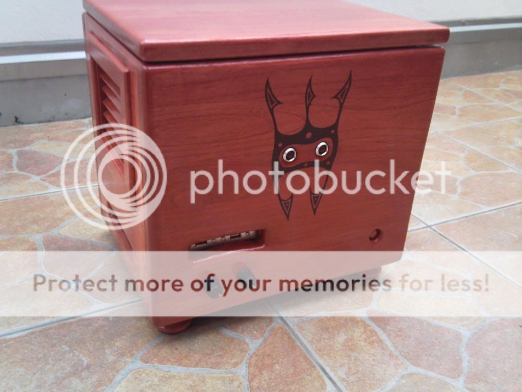

    Yes i did. My profession is carpenter so it really wasn't that difficult (although sanding can take a while :grr:).
    Here is a case i did a few years back:
    http://i806.photobucket.com/albums/yy345/bxcounter/Red Beast/Photo-0002.jpg
    ps..current case should be finished on monday

    Wow, that is some seriously nice woodwork there.

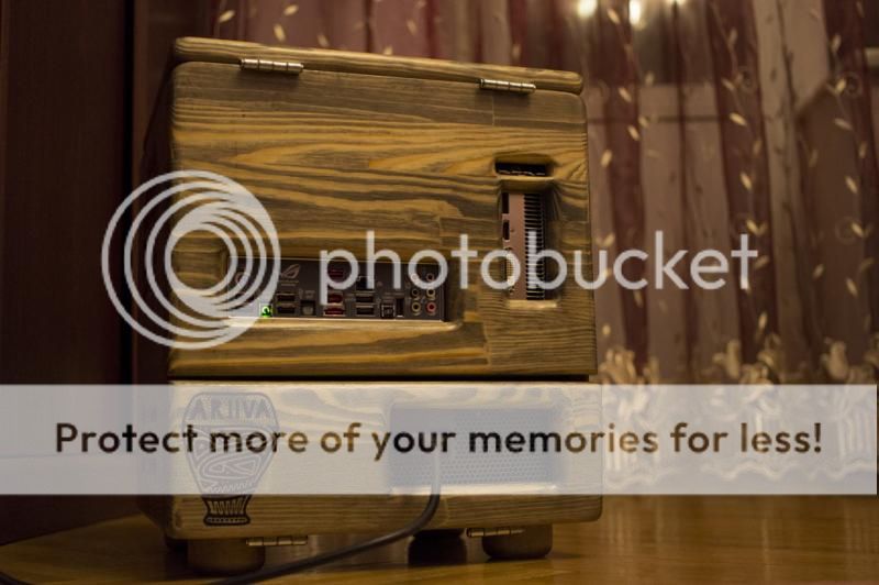

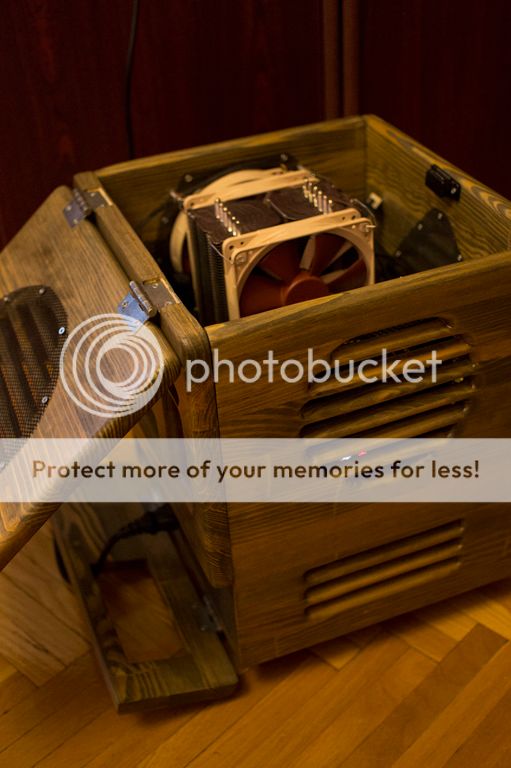

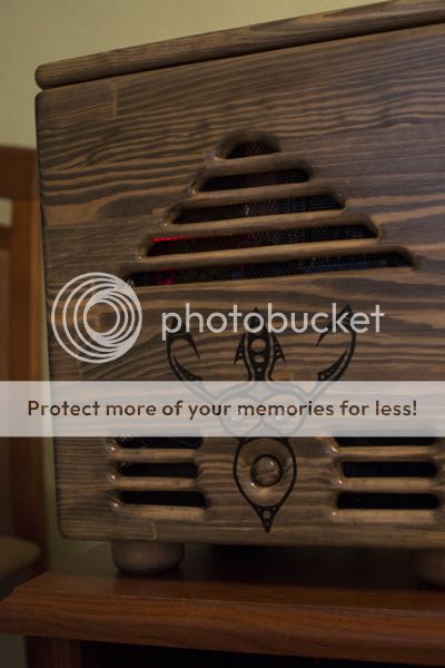

    So it is finally done (thanks for the support), well 98% would be more accurate, since I still have to align magnet holders that hold the PSU/HDD door in place and properly align the door itself. And install some simple led lightning inside. At least hdd led eyes work as planned
    ... so let me present you some info and shots...

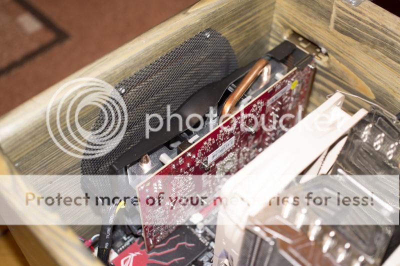

    Installed :
    CPU: i7 870 (@ 3.6 at the moment)
    COOLER: Prolimatech Megahalems (2 x Noctua NF-F12 PWM) + Noctua NFP14 FLX (exhaust fom case) + Zalman ZM-STG2
    Noctua NFP14 FLX is screwed in aluminum tube inserts with engraved thread (same as MB holder).
    ps…i suppose i will have it all finished up this weekend since i can't seem to find free time during working days :wallbash:
