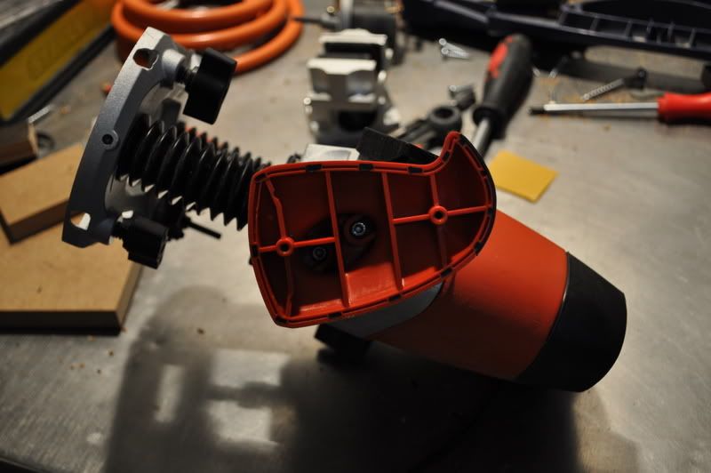

    motor mounted ! ( with a high pressure hose and some... erm whats the english word ? )
    Now the other way round, dissasembling the router !
    Cutting more boards for the spindle mount...

    Jubilee clips.
    Is there any/much play/wobbling in any of the assembly?
    I'm seriously impressed that you haven't had any problems - or you haven't shown us any mistakes!

    i hab a bunch of problems with the z achsis, thats why i did it 3 times :D anyway, did some more stuff, got some new gear :) pix soon !
