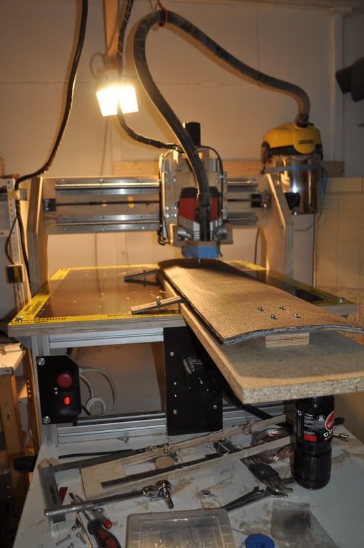

    jeah, im thinking of selling them, probably in a way like it is now, because its an ideal cost / precision tradeof, everything more rigid would be much more expensive, everything less rigid wouldnt be precise enough. Another good point is that the design is modular, I can make them pretty much any size required, were planning to extend this one to 2,5m on the y axis :)
    If anyones interested pm me...

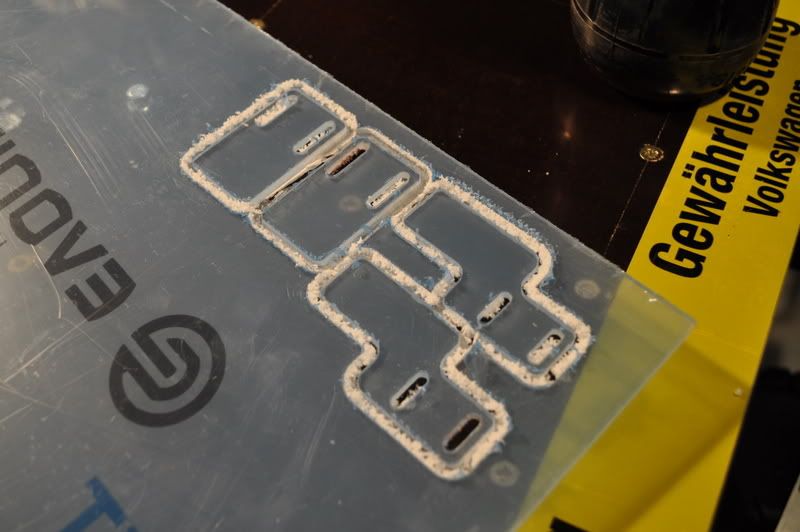

    some new pix :)
    Setting everything up...

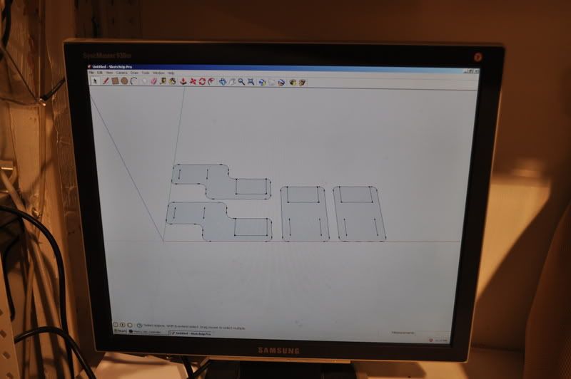

    Sketchup drawing of the parts

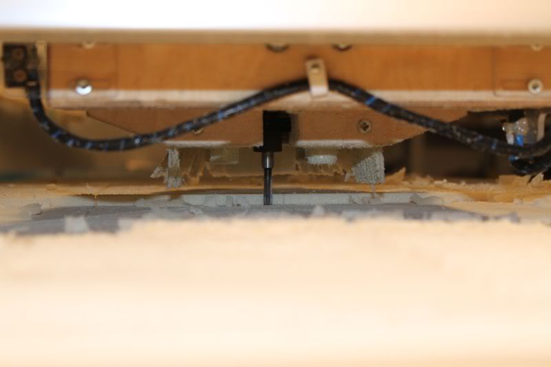

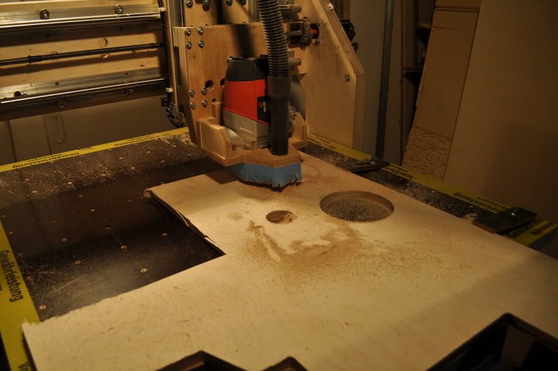

    Routing !
    Lets have a look :D
    Totally foobared the first sheet, routed it out of a different one ( which was actually a different material which worked much better)

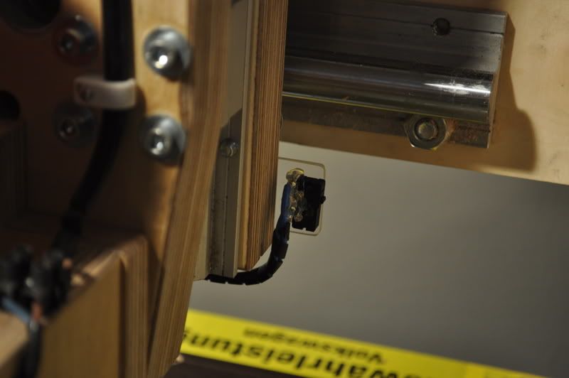

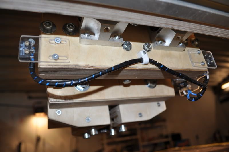

    And now.... LIMIT SWITCHES !!!
    Closeup screwed / hot glued together
    And a pic from the back, aint they gorgeous ? :D

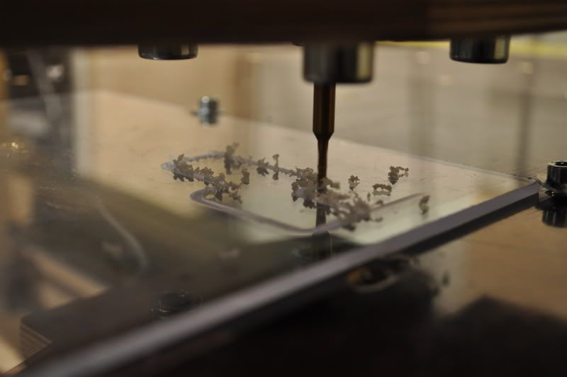

    Little vid for u guys, will do a big pic update later !

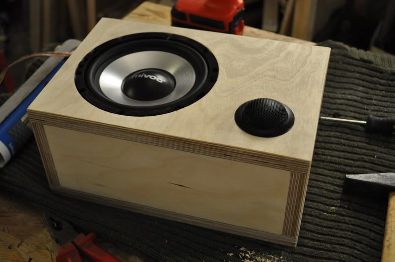

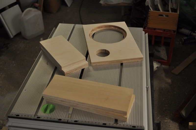

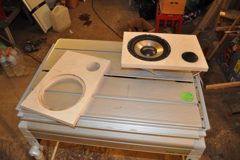

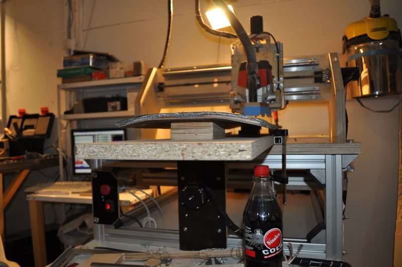

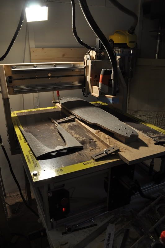

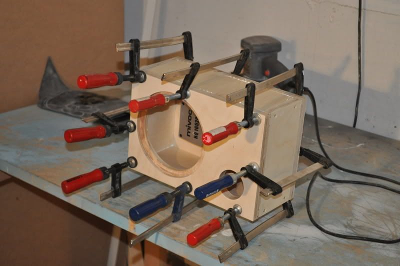

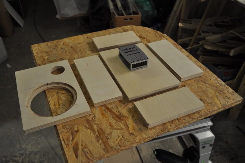

    Soo... biggie today...

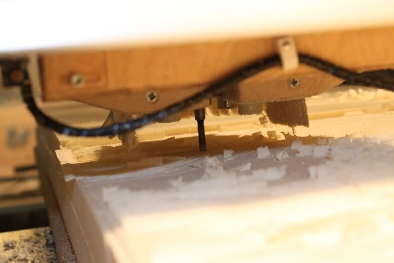

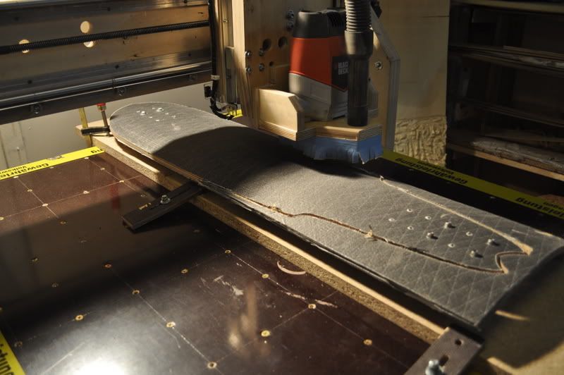

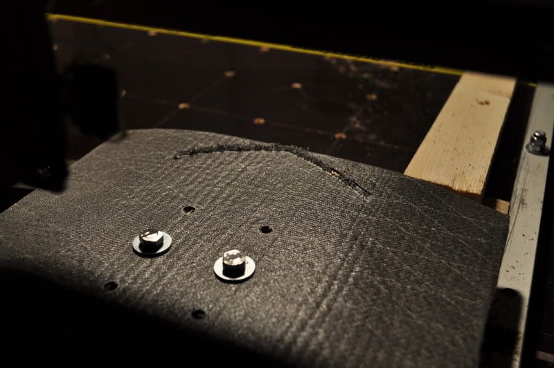

    Cutting 3d Shape out of styrodur (hard to see, the differences in height are not that big, but its bended in multiple directions)

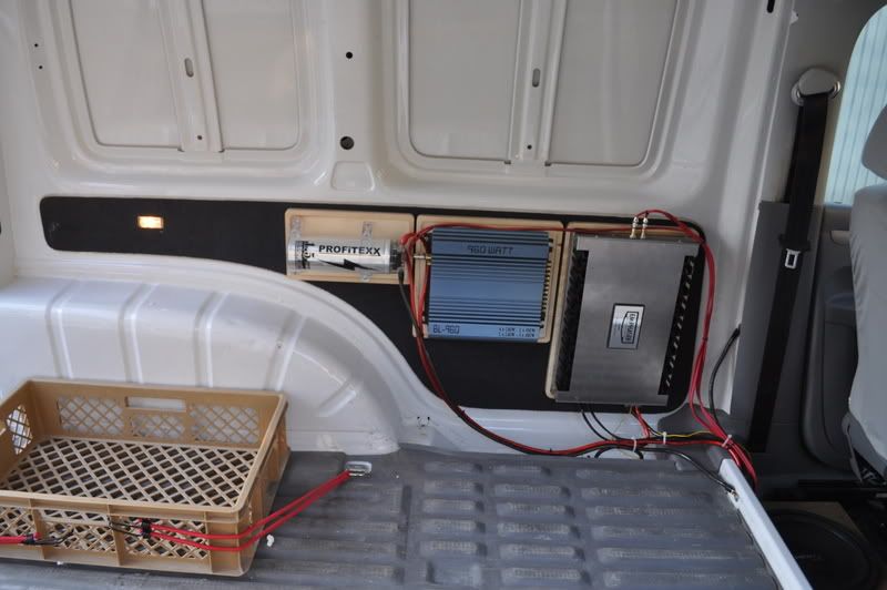

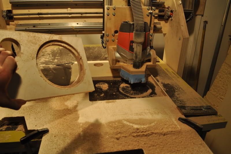

    Routed multiplex holders for my amps in my car...
    Cutting front plates for speakers, again multiplex
    More Parts
    Beside each other
    Gluing together

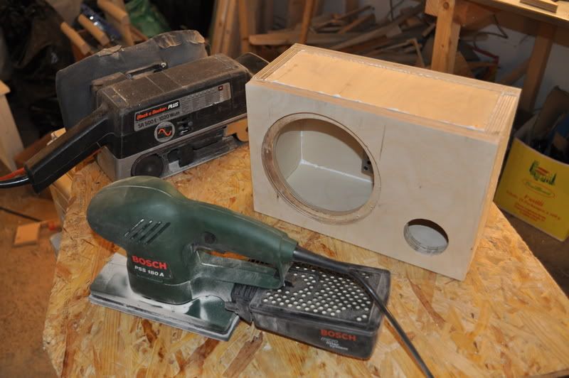

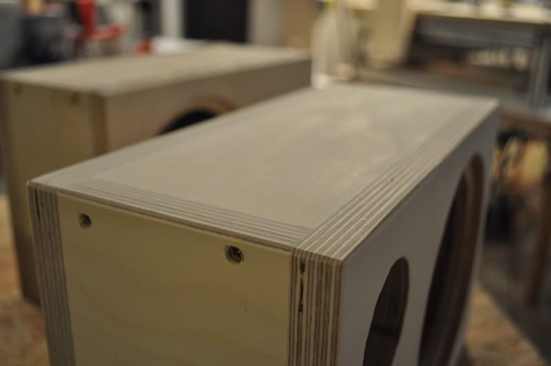

    Sanding, first rough with a belt sander, afterwards with an excenter sander
    One sandet, one more to go
    Closeup of sanded finish

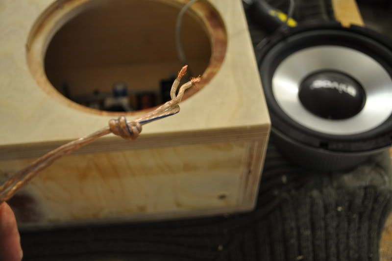

    Knot in the connection wire to take away the force from the screw in terminals

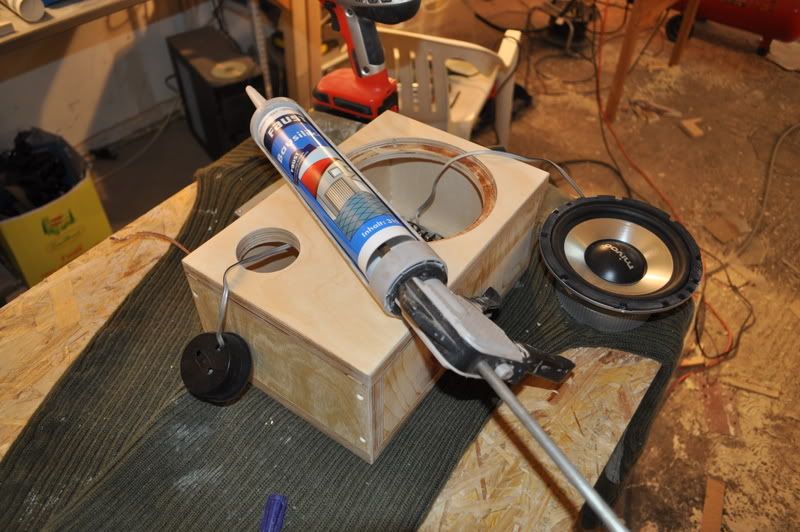

    A bit of silicone to glue in the speakers airtight
    Finished ( laquered one coat clear with a can )

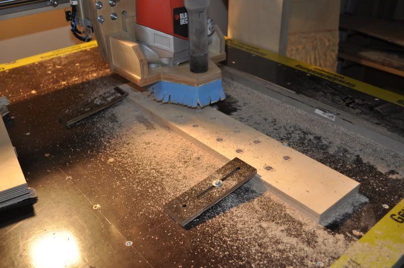

    Routing supports for a holder
    Finished
    Finished support with a longboard blank on top
    Starting to cut the blank

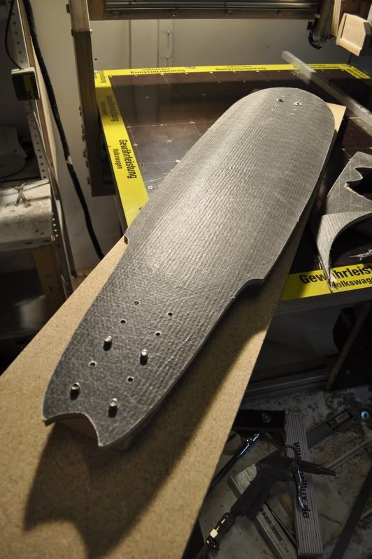

    Almost finished !
    Finished !!!!!!

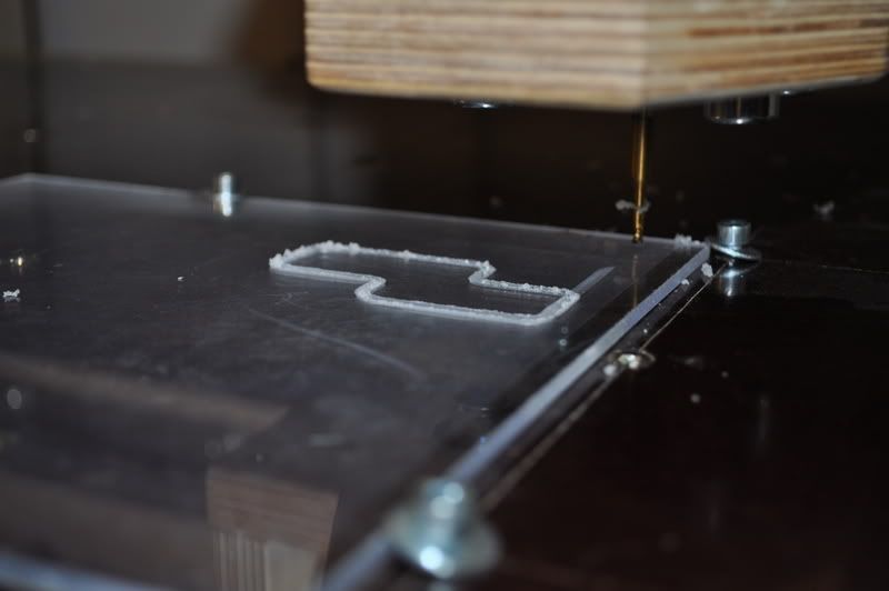

    Verry nice.. Have you tried cutting any alu yet? If not, please do and let us know the results :) Would love to see that since im currently thinking of buying a similar router..

    Did you let the silicone dry out for 24 hours before putting the speakers on? I heard the silicone fumes deteriorate speaker cones.
