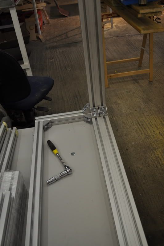

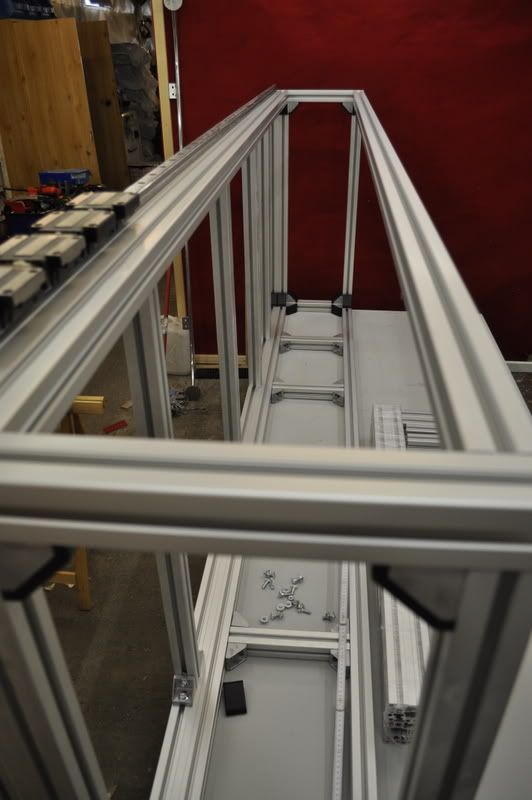

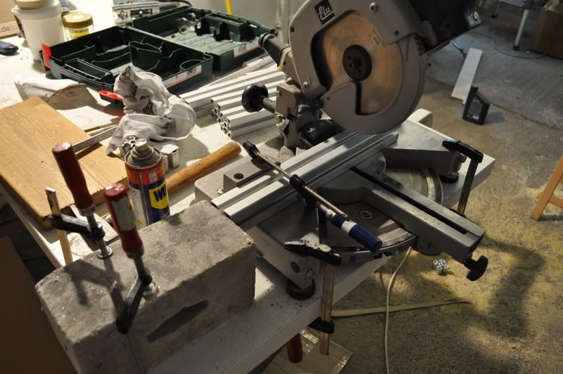

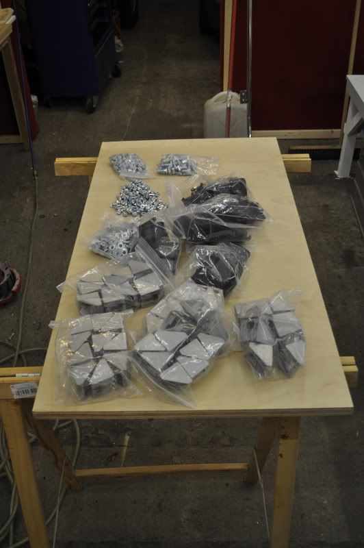

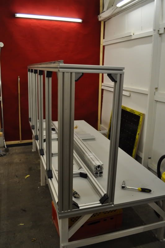

    ok, after weeks of waiting for the deliveries im finally back in business :D
    Some gear for the alu profiles

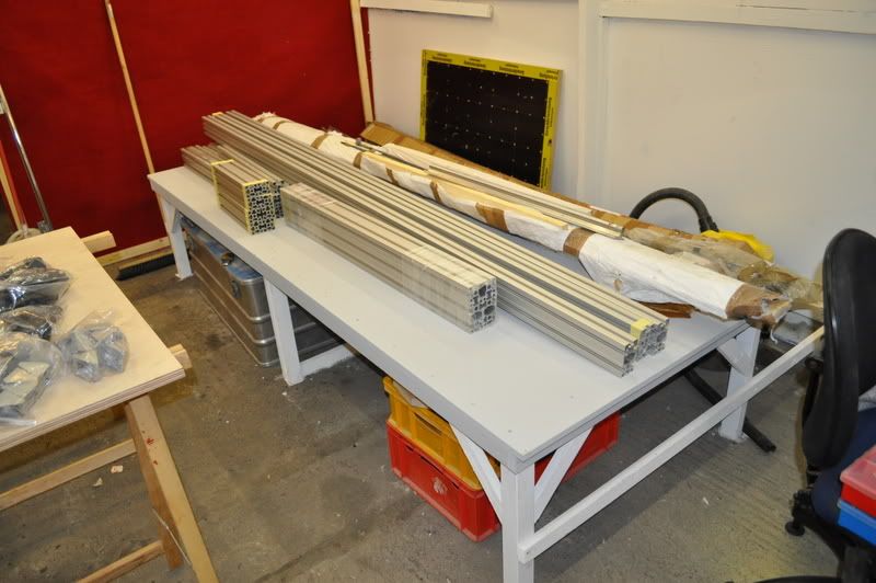

    All the profiles, spindles an linear rails together ( i think they like it :) )
    Starting the assembly !

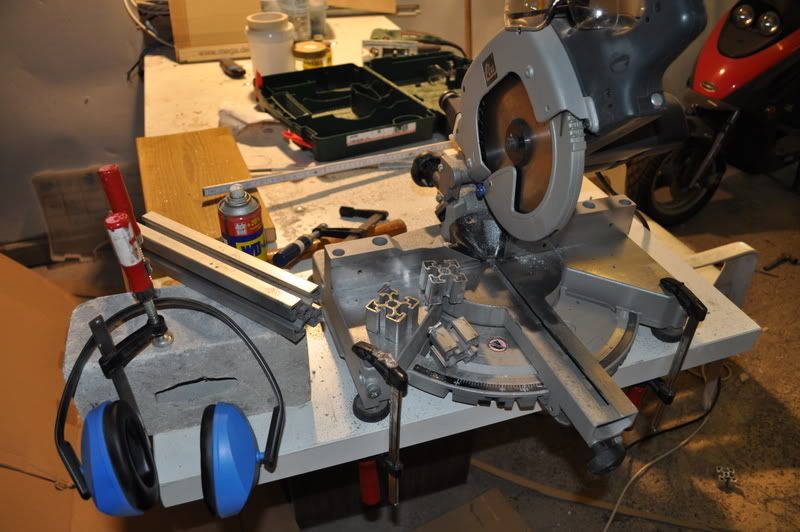

    Cutting alu profiles ( lets just say my plans werent final when i ordered :D )
    Safety gear etc, metall cutting likes fingers...

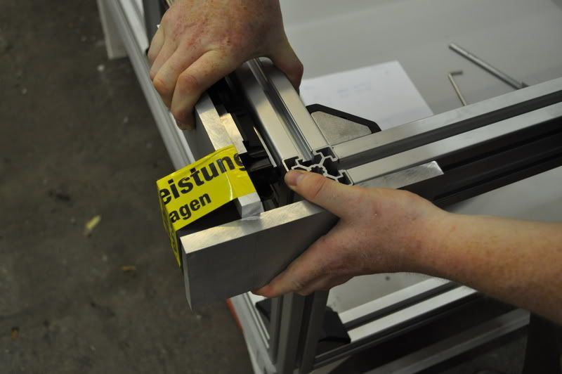

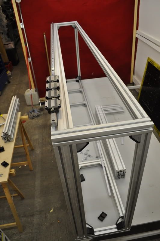

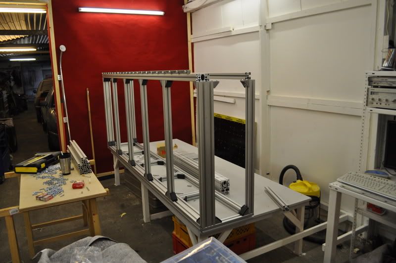

    Parts of the base frame assembled
    One linear rail just hopped onto the frame, couldnt stop it...
    Thats it for now, coffee induced madness over for today :D

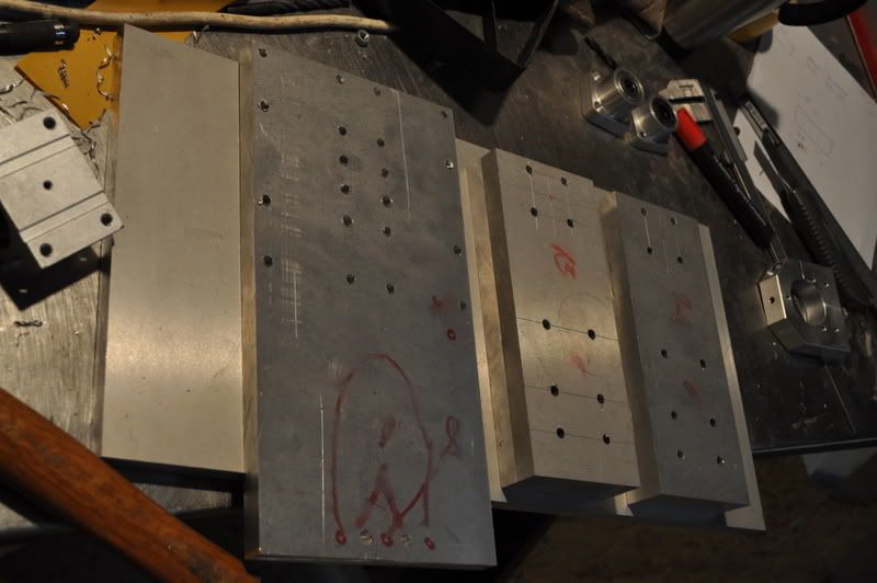

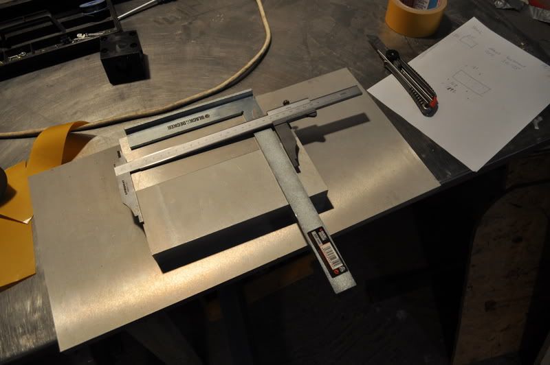

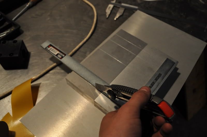

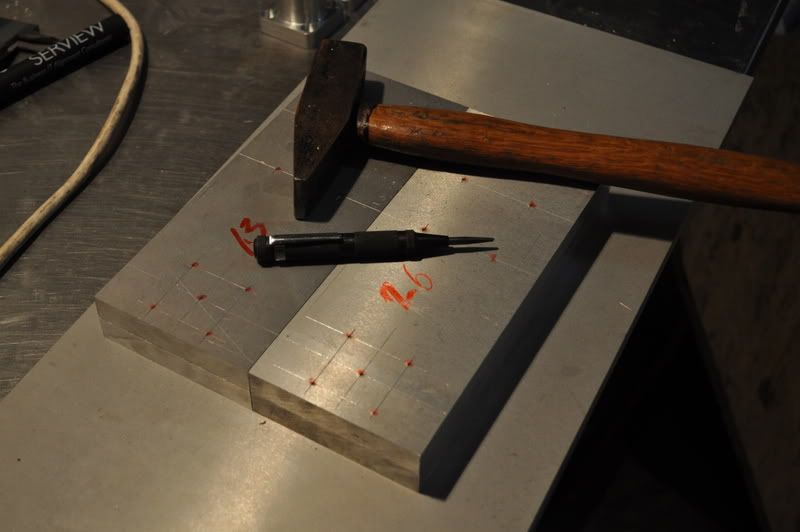

    some progress
    sliding in the linear rails
    Checking measurements, preparing for drilling
    Marking holes
    Affter drilling ( only 6mm holes so far )
    To be continued :D

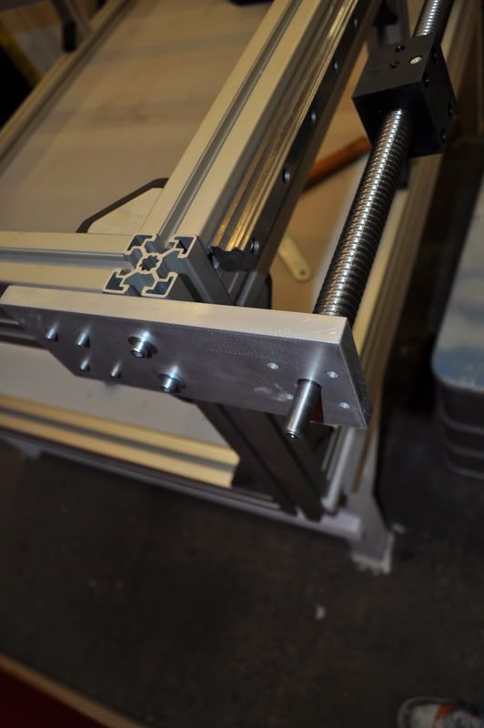

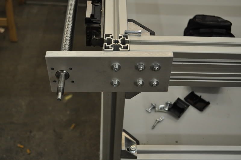

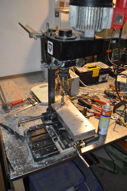

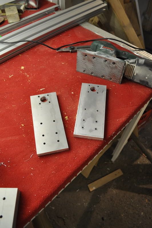

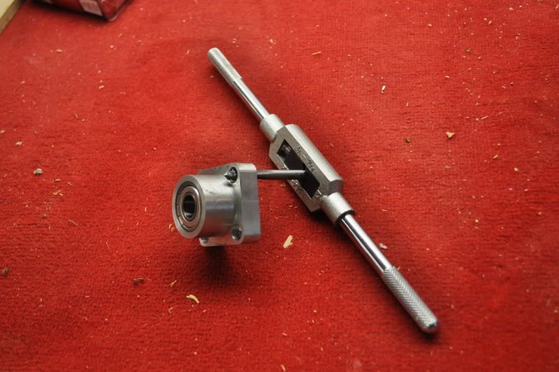

    I could install the first spindle today, im so happy everything worked out !
    Drilled the bigger holes for mounting the spindles ( 27mm through 30mm alu, the drill stopped a couple of times, couldnt hadle the torque, i did it together with a friend, he handled the wd40 spraying and the emergency switch :D )
    a bit of sanding and breaking the edges ( yeah, theyll cut you, got two stitches last weekend :( )

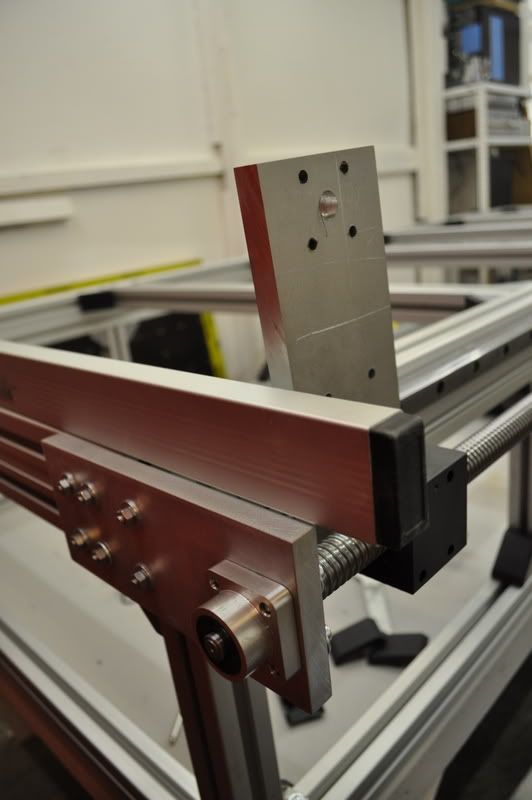

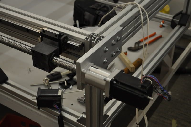

    Spindle mounted, still without the supports with the bearings
    other end
    Cutting a 6mm thread into one support
    Mounted, checking if everything is angular and fits ! (the alu plate in the background just sits there for checking, it won be mounted like that :D )
    Drilling the motor holder to 6mm
    Everything mounted, what a relief :D

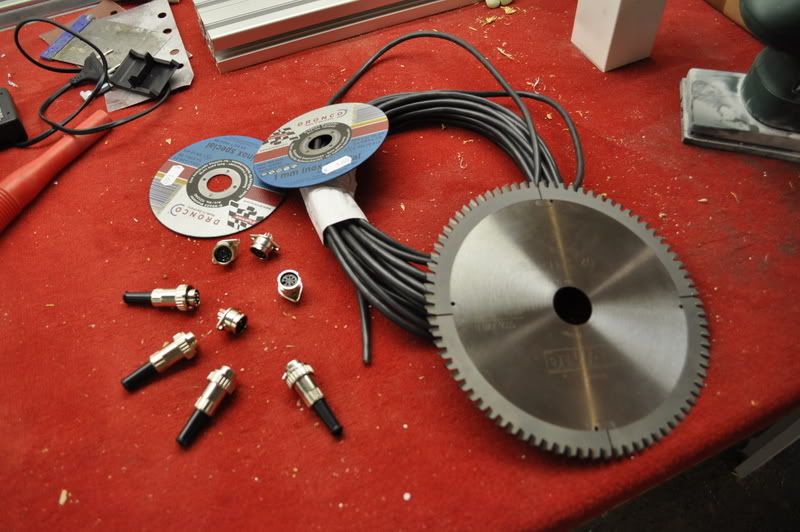

    random stuff i bought, alu sawblade, plugs for the controller box, new insulated cabes for the motors an generic metall disks for the angle grinder
    maybe tomorrow ill manage to mount the second spindle, ill see...
  16. Dark~3nergy
    Dark~3nergy what was dat sandvich ?
    14 Jan 2007
    1,424
    45
    those are called stepper motors, not spindles ;)
    looks gigantic btw !
  17. lenne0815
    lenne0815 What has been seen cannot be unseen
    4 Jul 2009
    542
    26
    noo i mean the actual spindles, was already wondering what they are called but im pretty sure its spindles, at least in german it is :D
  18. Javerh
    Javerh Topiary Golem
    5 Sep 2006
    1,045
    26
    In professional language ballscrews or leadscrews are often called spindles. They are simply rotating axes of a machine. In casual speak, only the main spindle is called a spindle.
    The structure looks really solid for a router. Nice work!
