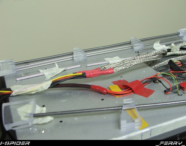

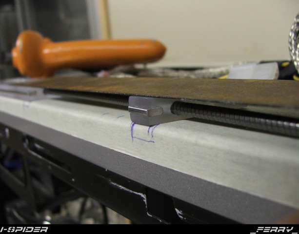

    The most inportant update, there will be a few acrylic bloks between the 2 cases with brake hoses running trough it. Offcourse with high precision and light effects.
    This one was the hardest one because his length. It's bigger because the watercooling tubes are going trough it.

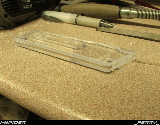

    Building the acrylic blocks is not as easy as you might think. First i should make a hole in it where the aluminium strip would fit in. The rough lines are done with a dremel, and after that it takes +/- half an hour to make it fit exactly for every block. The aluminium is pushed into the acryl with no need of glue. After fitting it it's time to get the right dimension and polish the aluminium. when moving your finger over it you can hardly feel the junction between acryl andaluminium.

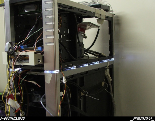

    Just a quick update to show you the result of the blocks with led's. I've mounted them today together with the black strip witch prevents looking trough the space between the cases:
    I will get some better pictures when the saw-dust has been removed and the cable's are cleaned up.

    It's a very clean effect and I like it a lot :)
