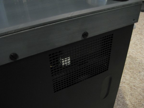

    Well, it's more that any of the recessed handles that come in a non-metallic finish are the wrong dimensions. Space up-top is at a severe premium. That AND I simply don't like the way they look.
    The original intent was to make this case look very similar to (only different color-wise) the ammo pickups in Metal Slug. This computer looks more like an unlabeled prototype weapon.

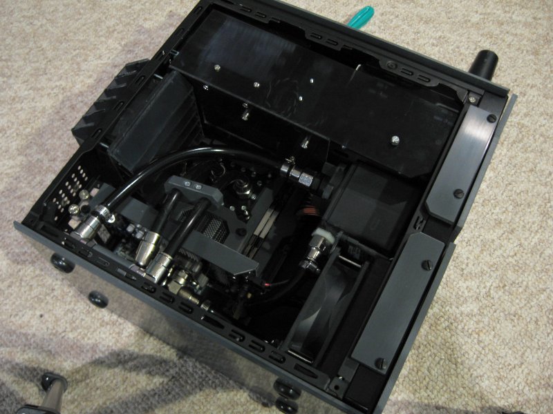

    hey would u mind telling me where u got that t line peice or w/e it is called that can be ussed to fill your loop or drain it
    thanks
  4. Captain Slug
    Captain Slug Infinite Patience
    25 Nov 2001
    1,404
    7
    Nope. This machine won't have a window. The light inside let me know that the machine is on, without having a blinding light on the front of the case.
    I used
    mcmaster part#
    4596K321 - PVC Threaded Tee Pipe Fitting 1/4" NPT (drilled out the inner diameter a bit)
    48335K171 - Nylon Threaded Hex Nipple Pipe Fitting 1/4" NPT Pipe Size
    4912K87 - Miniature Chrome-Plated Brass Ball Valve Tee Handle, 1/4" NPT Male X 1/4" NPT Female
    The miniature ball valve is the best part. If you want to add one to a length of tubing simply buy a thread x barbed tube tee instead of having to use a threaded tee.
    I then made a fill cup funnel using a length of polyester tube and a polycarbonate sheet base. I can screw the cup onto the valve with an o-ring between the two for a quick seal. Once the loop is bled I simply close the valve and empty the excess coolant from the cup before removing it.

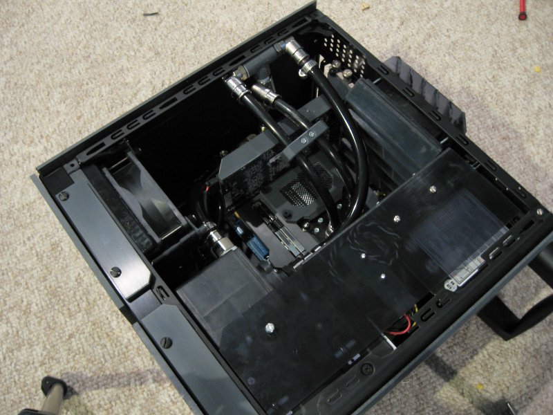

  6. Captain Slug
    25 Nov 2001
    1,404
    7

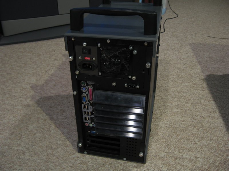

    The memory and motherboard are getting direct airflow from the louvered fan in the rear of the case.
    RAM really doesn't need much in the way of cooling.

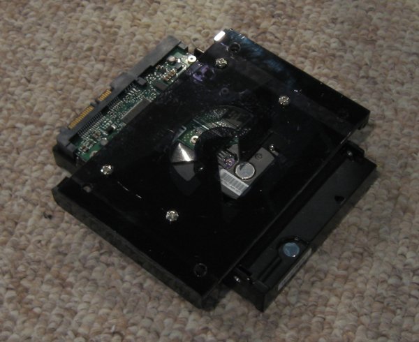

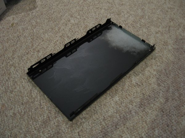

    Tiny update. I've been too sore to move around much. Last night I got the top piece of the case painted because I didn't want any naked steel visible. The only remaining patch will be above the optical drive.
    And I had to retool the hard drive bracket because it wasn't fitting the drivecage.
