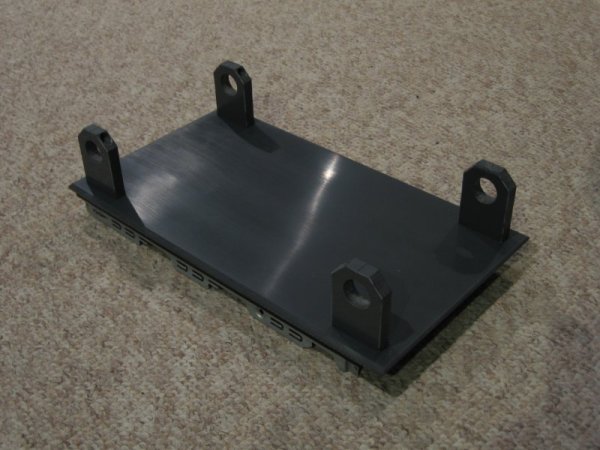

    The new handle brackets are done. And I'm not surprised but the delrin rod that arrived is not precisely 1" in diameter so I have to take it to the machine shop to lathe it down to size.

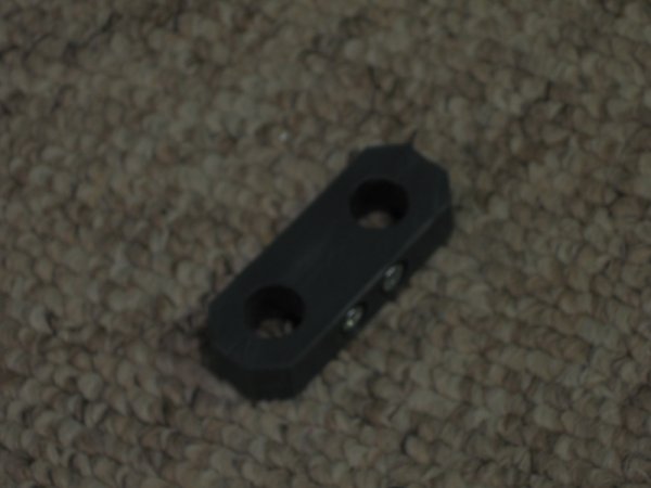

    Also made the hose separator. Which I can't seem to take a decent picture of right now...

    The new brackets look superb and will definately match the quality of the rest of the case better than the old ones, great job.

    Agreed. I like the new handles so far!

    you don't think those clamps are to thin? maybe double up on them, idk. gj with everything so far, your defintely no slacker. so what are you planning on doing/have done with baby mk.V, is it still up and running?

    The clamps are 1/2" thick

    The brackets look great. Gave an instant impression of lifting hooks seen in some industrial stuff. That seid though.. I hope they won't look as much PVC when you're finished with them.

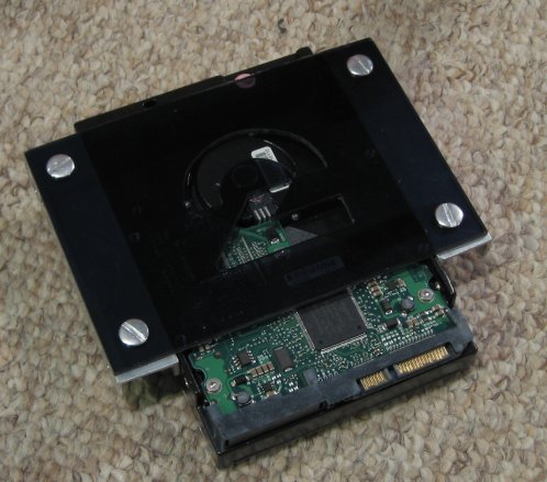

    Borrowing a HDD bracket from an old project.

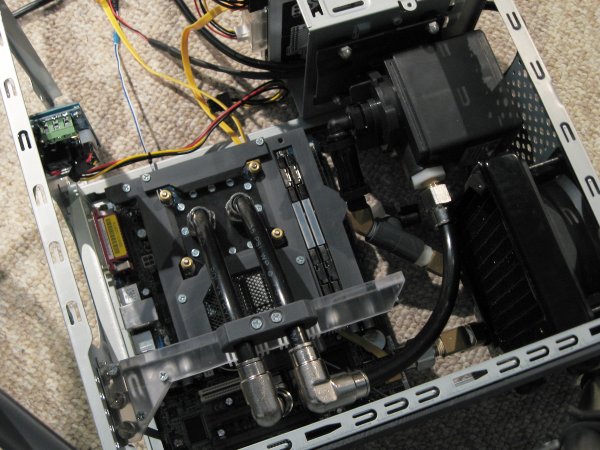

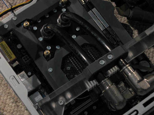

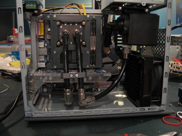

    Loop attempt number one. Had a small leak inbetween the GPU block and radiator because the length I cut was too short.
    Loop attempt number two. Had a small leak on the pump outlet NPT adapter. Worked on correcting it. Also small leak on lower barb on radiator because I didn't tighten it enough.
    Loop attempt number three. Still have pump outlet leak so after dinner I'm going to go to Home Depot and get some RTV Sealant.
    I'm VERY please with where everything is on the loop. Leaks in both the filling orientation and the standing position haven't touched any of the computer hardware. It has also been easy to bleed and refill (which can be attested to by the fact that I've done it three times in 4 hours). Once I get this last leak fixed I should be ready to send off all the steel parts to be powder-coated.

    Nice work there, I liek the look of it. But do I see a piece of clear tubing from the rad to the GPU?

    I made a tubing size adapter out of 1/2" OD clear polyester tube and needed to use clear tubing with it temporarily because I couldn't find the rest of the clamps that fit the thicker 1/2" ID 3/4" OD black tubing. The final loop setup will use nothing but black tubing.
    Edit: Got the sealant epoxy and applied it. Have to wait for it to cure overnight before testing the loop again.
