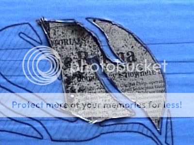

    Update
    Quick Update: I stopped working on the sword, because the sword requires smaller disks. So I switched to cutting the skull (never thought I'd use that phrase :hehe:). Since I'm working indoors, I'm restricting myself to working hours (9-5) so that my neighbors are out while I'm causing all that noise. :naughty:
    Here are some pictures of my progress so far.
    So far the 'creases' in the pirate skull's bandana are holding up fine. I discovered that the sanding drums that came with my dremel kit do a great job of making the edges of metal nice and smooth, without applying much pressure. I will be using them on these 'creases' as well as the other edges of the cutout. They get used up really quickly though, so I may need to buy a few more.
    So far so good. :dremel:

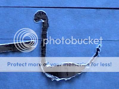

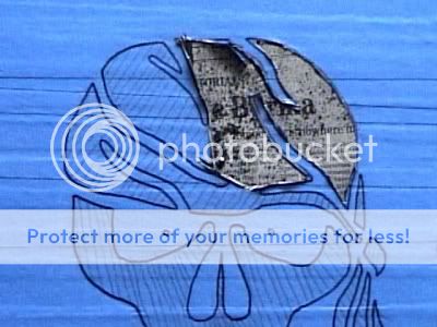

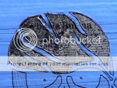

    Did some more cutting today. Worked on both the top half of the skull and some finer parts of the sword handle. Here's an overall picture of my progress:
    Close up of the sword:
    and of the skull:
    I used the tungsten carbide cutter (#9901) to do most of the sword handle. Problem is, the bit doesn't stay in the tool for very long, and is continuously jumping while I cut. Maybe I'm using the wrong approach or something? :confused: I always use this while cutting to add stability, but the bit still jumps and occasionaly falls out of the collet, despite it being screwed in tight! :eyebrow: :wallbash:

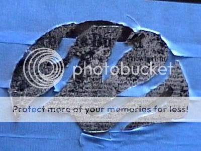

    Anyways, if anyone is wondering how things are looking from the other side of the panel, here are some more pics:
    As you can see in that last image, the painters tape burns up in some areas. :naughty: I will most likely be taking a day off tomorrow and getting some fresh air instead. Also need to work on my Honours project, which is way behind schedule. :wallbash: :waah:
