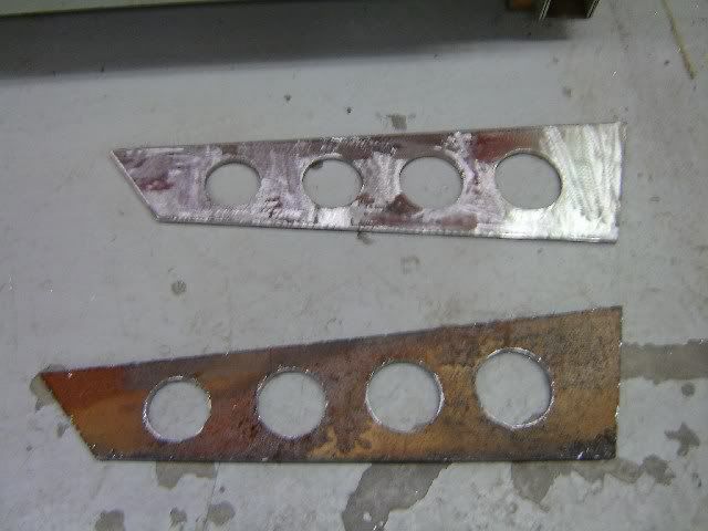

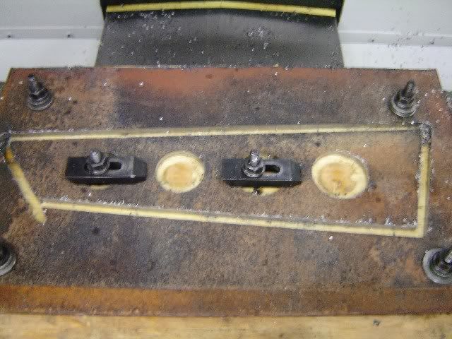

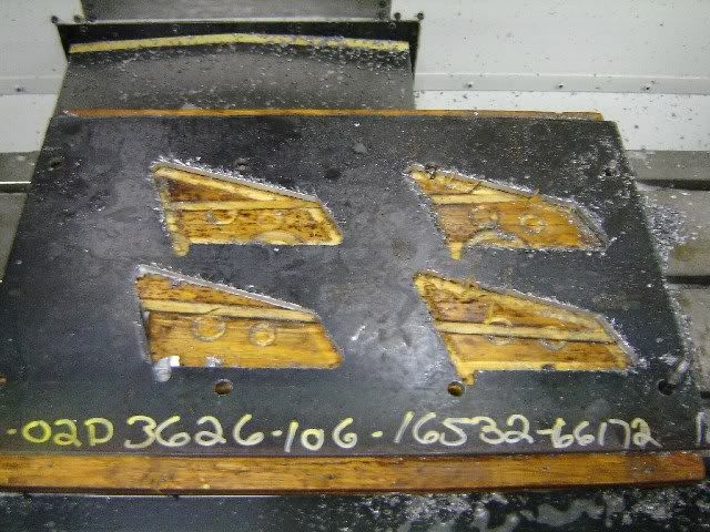

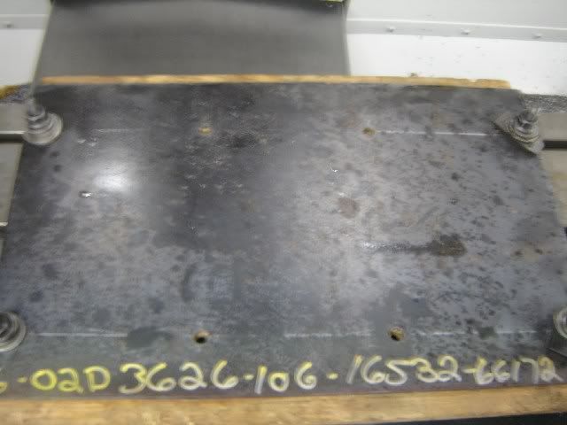

    So, my friend and I started by doing the side plate:
    1 hour and an half later:
    Another hour and an half later:
    Yeah, 3 hours by plate...all done by now :rock:
    but worth it after some buffing, beautiful isn't it?

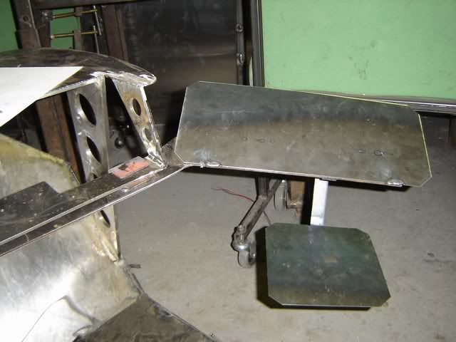

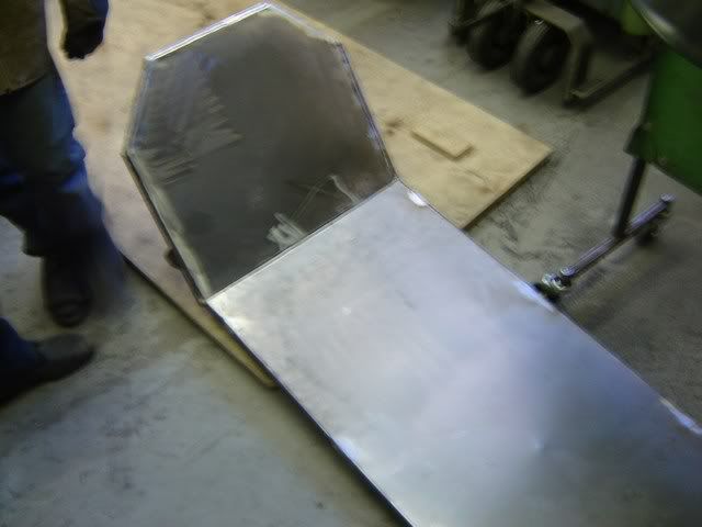

    Then, we did the small plate to hold the racing wheel:
    :D

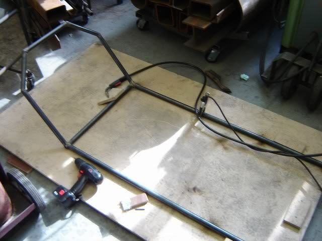

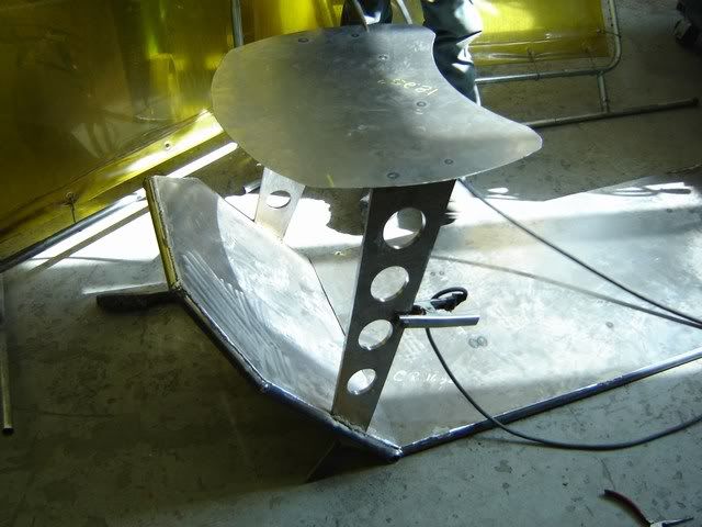

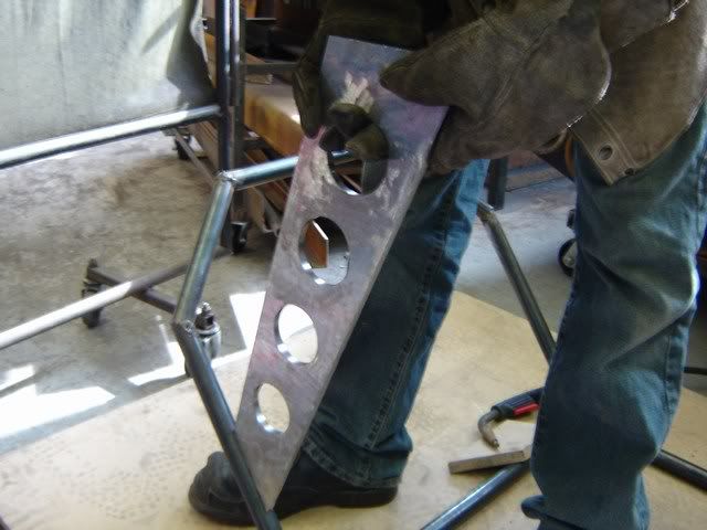

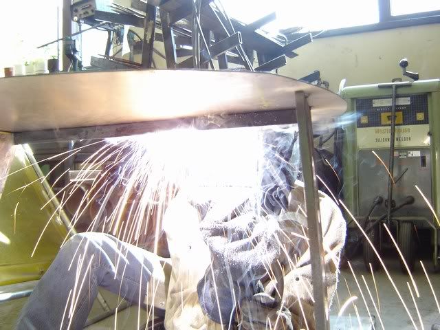

    Hey all, small update here...not a lot of pics since I passed the day in the welding department.
    Frame builded with 1" tubing:
    with the plate:
    Next update will be the monitor/steering wheel assembly
    :rock:

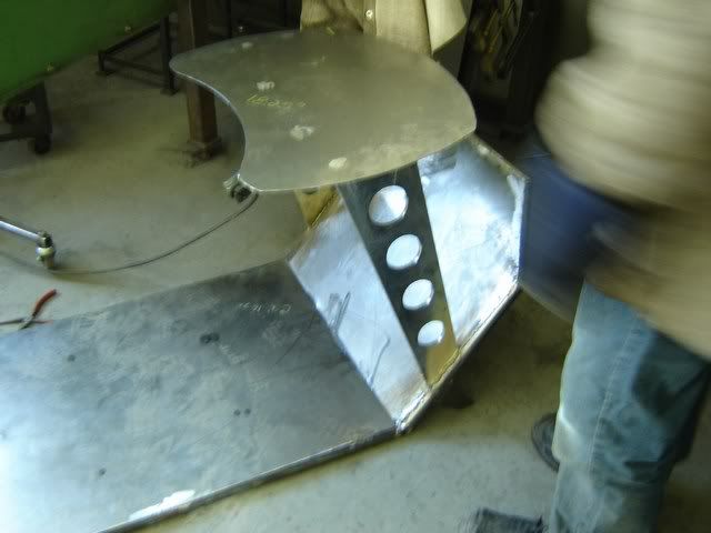

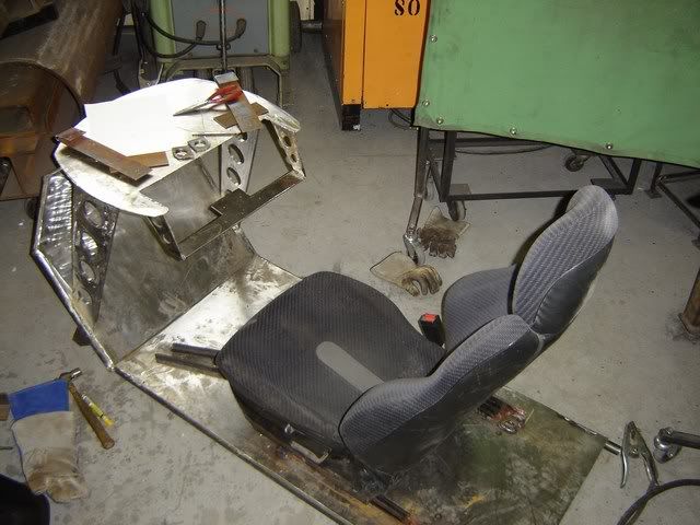

    Another small update;
    it's taking shape :rock:
    this picture is pretty cool
    I forgot to take picture at the end of the day :duh:

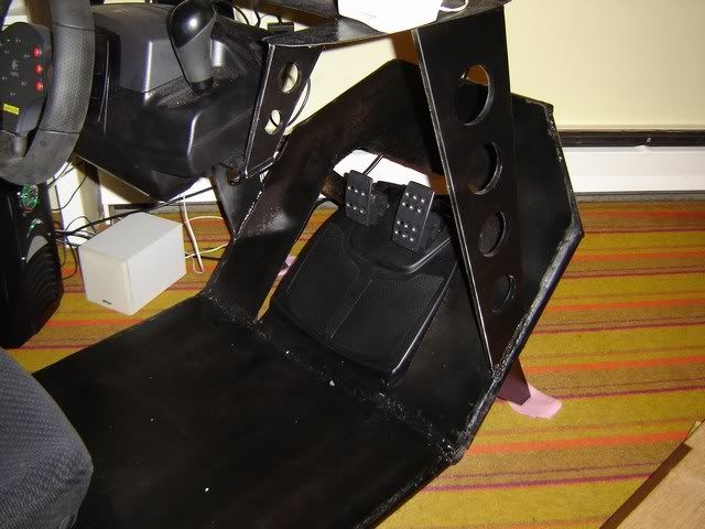

    the steering holder is done and we bought the car's seat but it isn't mount yet.
    We need to figure out how and where to hold the keyboard/mouse
    See ya next week :D

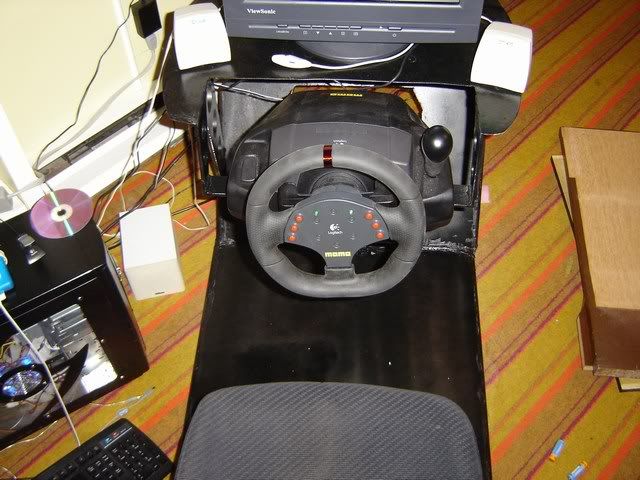

    Steering wheel fixation:
    keyboard/mouse emplacement:
    overall view:
    The construction is done...the pod now need some bondo, primer, black paint and clear coat.
    final update next week! :rock:

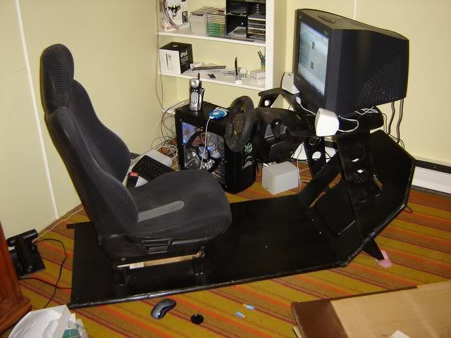

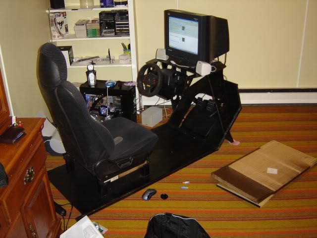

    DONE (sorry for delay :p )
  16. hirme
    hirme What's a Dremel?
    19 Feb 2006
    12
    Yes, it's a del sol seat :rock:
    finished :D

    it's my main computer "table" too...
    will take pic with keyboard/mouse this weekend... :rock:

    update to show you my keyboard/mouse :D
  20. hirme
    19 Feb 2006
    12
    Just add my keyboard/mouse picture...way before the wekend isn't it :p
