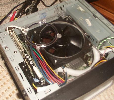

    Small update. I finished the polycarbonate 120mm fan and cold cathode mount. So now all the internals are secured in the final configuration.
    And it illuminates the side panel emblem really well.
    Yay! :D

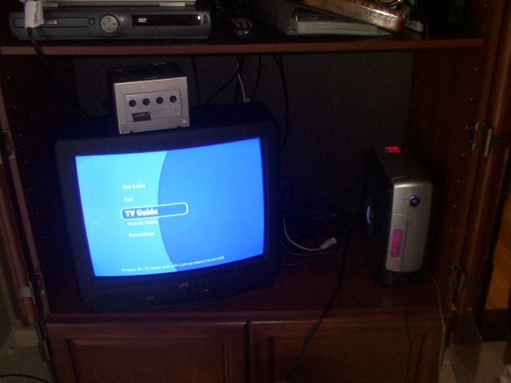

    Here's how the machine is setup at the moment.
    All of the tweaks I have to do now are very minor software and networking adjustments. I should be able to watch whatever I record by streaming them over the wireless network to the computer in the basement.

    Mesa like...Do you have that hooked up to a tv? If so hows the quality and what video card are you using....
  5. Captain Slug
    Captain Slug Infinite Patience
    25 Nov 2001
    1,404
    7
    It is hooked up to the TV and is displaying the GB-PVR menu. The quality is superb, especially the MPEG2 video. And the video output is the motherboard's Intel 845GE onboard video @ 800x600.

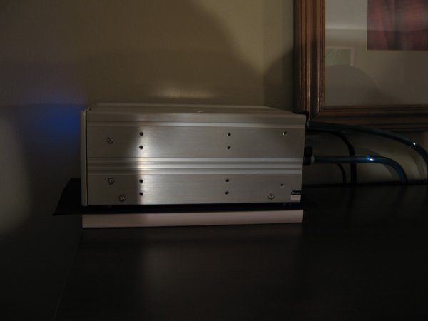

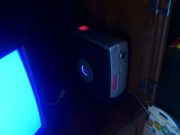

    Well, this isn't really an update. More like an epilogue.
    This machine got attacked by toddlers twice last year. The hardware inside survived thanks to the layout of the case and my ducting setup, but the case itself did not. The "eye" went missing, and no less than 9 toys were found stuffed into the front of the case. This machine was also prone to overheating, not because of anything I did, but because everyone else kept closing the TV cabinet and leaving it that way for days.
    Last month I found a really good deal on an old favorite slim case of mine and moved the hardware over into it. This month I got a really good deal on an external water-cooling unit and set that up earlier this week. The machine is now setup far away from prying little hands.
    And the external unit allows the cabinet to be closed without suffocating this machine.

    The processor would get up to 62C. Temperatures I had not seen since the hardware was in an extremely small enclosure. The cabinet would start to smell like warm varnish after being closed for 4 days.
    It's a Cooler Master Aquagate. It's pretty pathetic but it does the job better than the 2U heatsink it replaced and it was only $35 after rebate. :D
    Just wanted to bump this to show that things don't always work out as intended. This machine has served me exceptionally well for over two years. But the original case, even though it was very sexy, was not easy to service. This new case is a huge improvement in that respect.
