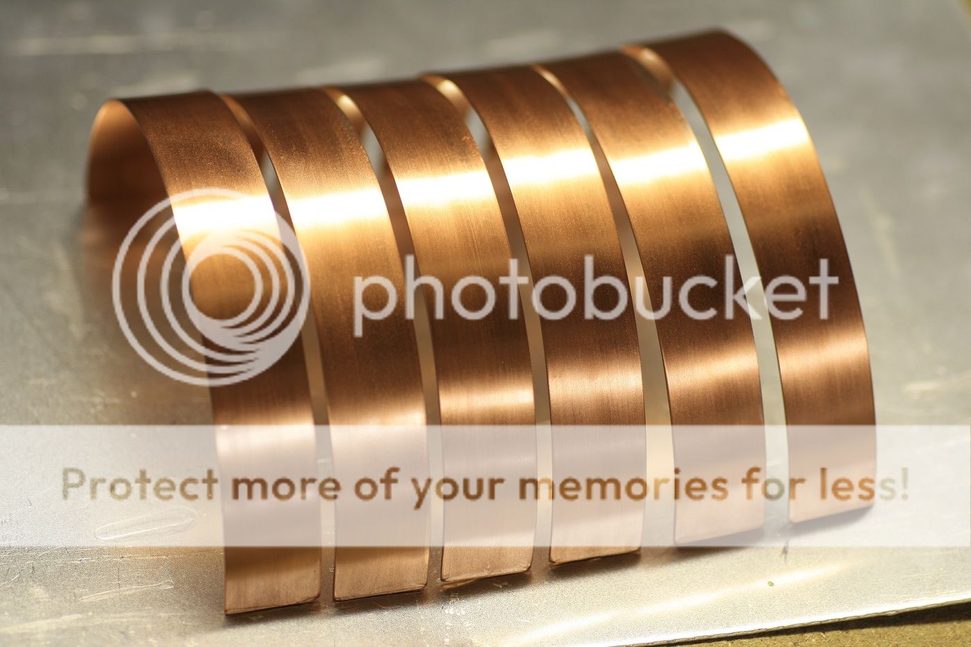

    :D Cheers KidMod, I still haven't brushed the pieces, I kinda did them a little bit half arsed by rushing them a little so the edges need a tiny bit sanding off as they become a little thicker than they should on the edges so I straightened them back out & I'll get them completed tomorrow to a standard I'd be happy with, can't be doing them to a lesser standard :nono::D.
    Another problem with them is they aren't exactly cheap :D & exposure to the sun while they are on I read can really shorten the life of them, feels like I was jogging & suddenly got stuck in quick sand progress wise & definitely not the best time for me to be idle, that riot thing played on my mind a bit making me angry etc so need to keep busy to take my mind off some things, held up by a bad communicating mod supply shop, they gave me tracking codes but I really think they haven't actually posted the packages must be using pre-paid packets & the longer thay are taking to reply to me the more irritable I've been getting so dunno what to do with myself [​IMG]:hehe:.

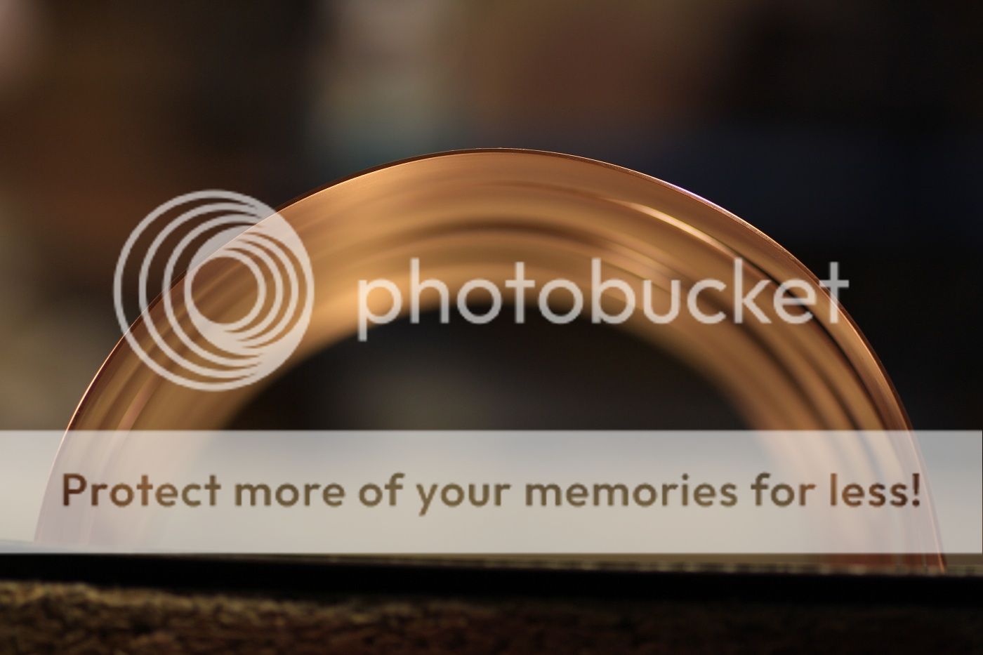

    Everything antiqued after grinding down the 12mm sticks to 7.3mm.
    And the fun begins oh yeah, this is them after the disc sander.
    After 160 grit going 1 way, length ways so they will polish up better.
    240
    600
    Sure wouldn't be able to do all these hours & be able to slightly smile without my trusty mp3 jukebox :D.
    1200
    2000
    Polishing.
    Result :D.
    After cleaning them all up I started sticking them back together.
    Copper ? clips, that's right not P clips but ? clips lol :D.
    Anyway once the revised fan holders have cured that's the last time consuming bit, then it's just the optical tray & eject button & a tiny bit of wire work for a molex cable & the power switch, then the final touch install the lighting & get the copper ? clips :D installed & then route all the wires tidy, then I think it's done & time for the final photo shoot can't wait so I'll get it completed ASAP :D.
