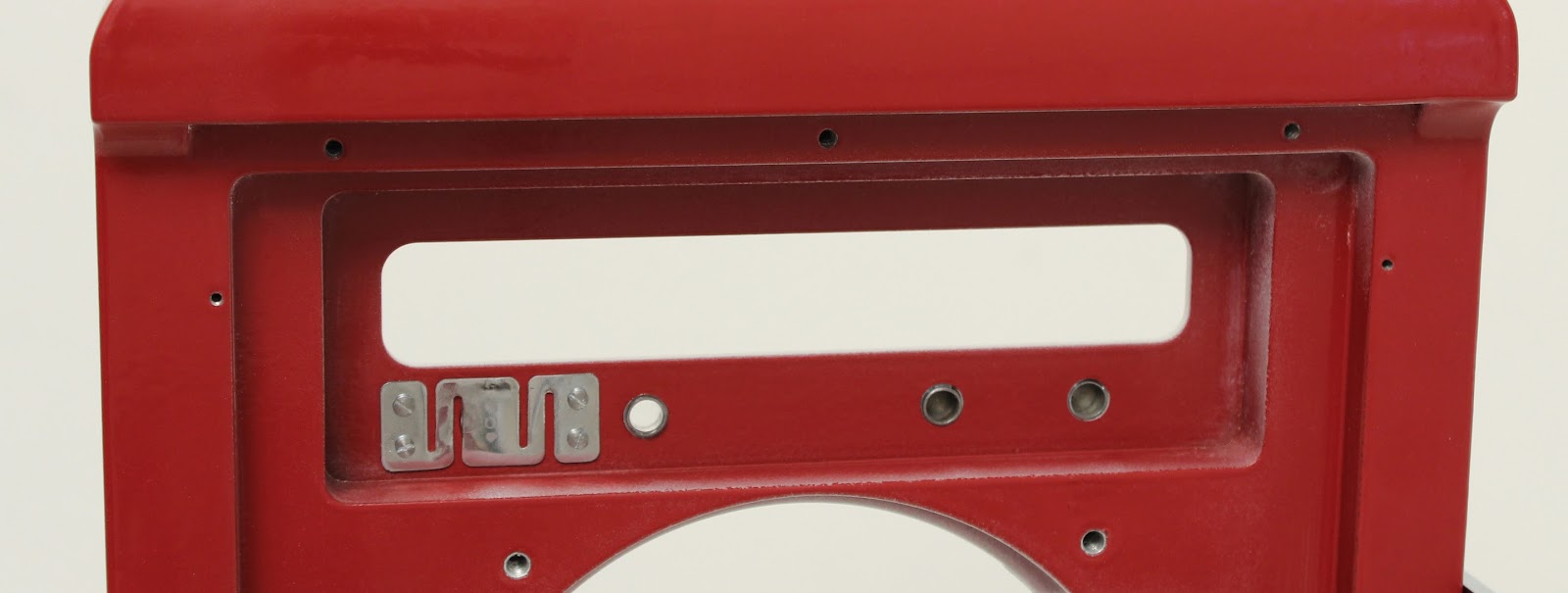

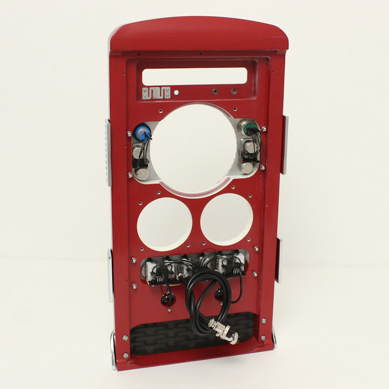

    Now continue the assembly of the front panel

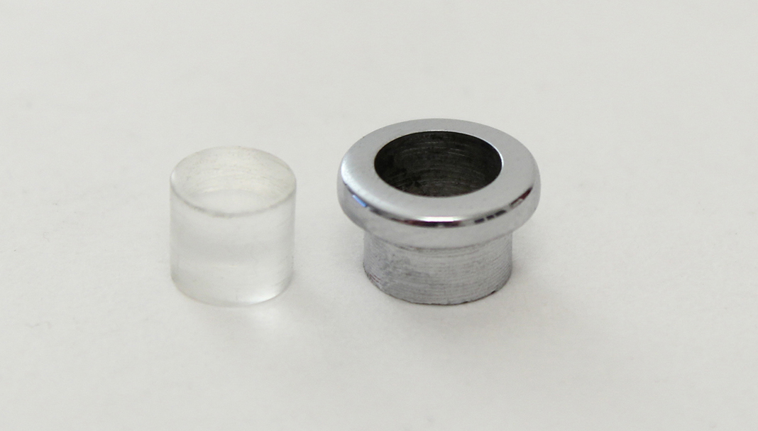

    The eyehole for disc indicator and 2 plugs. Steel, turning
    Optical drive indicator will be visible through the piece of acrylic glass
    The parts are chrome-plated and cut to the desired length
    Tray eject button. Panel - laser cutting, 0.5 mm steel. Button was turned on a lathe
    Assembled using the threaded pin and soldering
    The surface is cleaned
    All the parts are chrome-plated and prepared for installation in the optical drive bay
    Blind holes with M2 thread for attaching the button

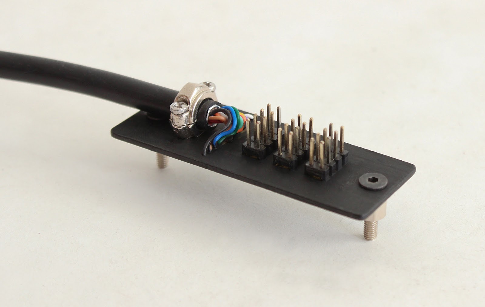

    Two bottom controllers are connected to the switching board
    Front view
    Panel placed
    Switching board for upper LEDs and two independent channels of the "flame simulator"

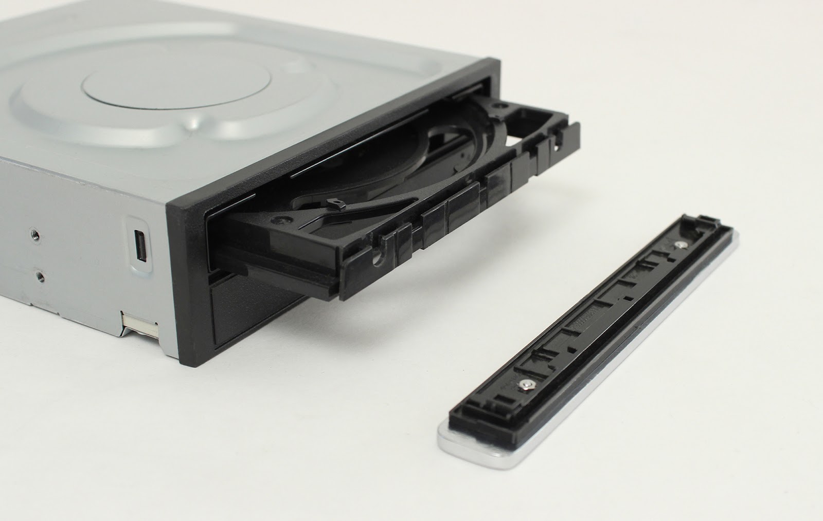

    Plastic tray is sanded to a smooth surface. Chrome-plated panel is made from 4 mm brass bar.
    Screwed to original tray
    Optical drive on its place

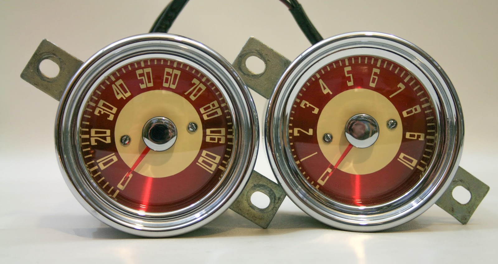

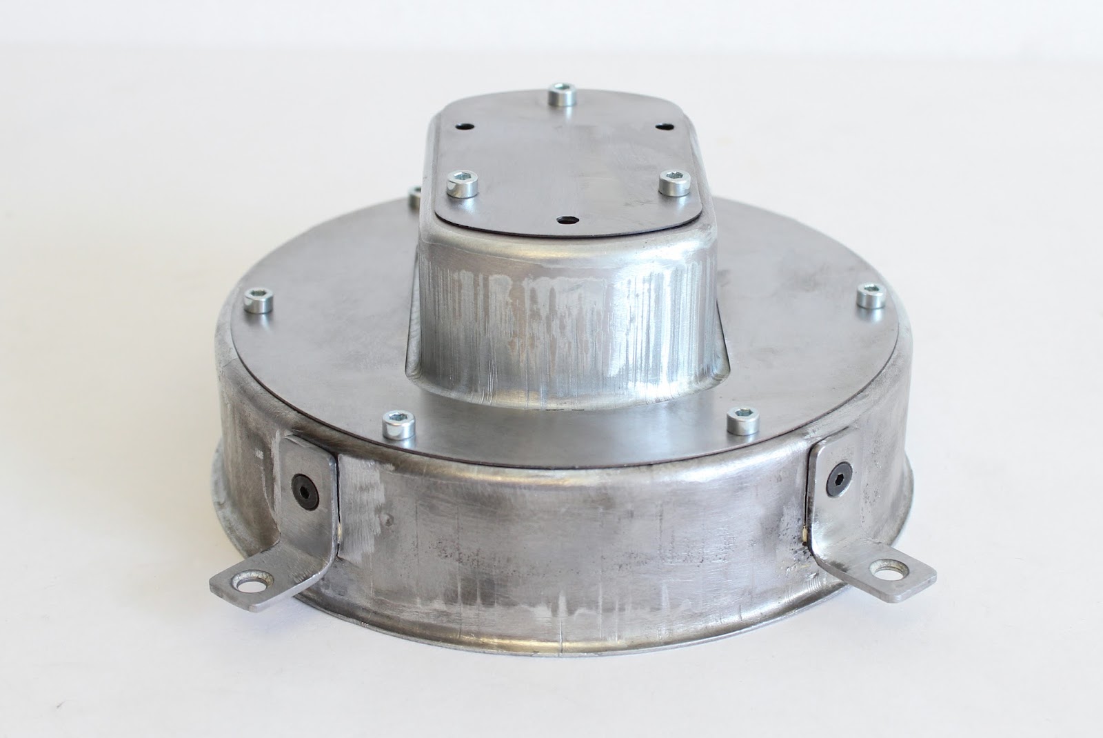

    Restored speedometer from the Soviet car GAZ M-20 "Pobeda" model 1949
    And two stylized gauges
    They were made by a professional vintage cars restorer from Voronezh city
    Speedometer

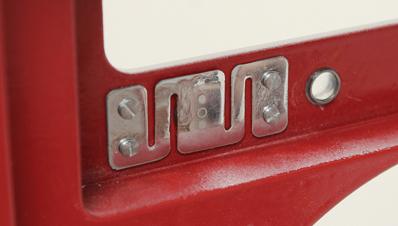

    The dismantling of the factory fastens. They've been attached with the contact welding, so it had to be drilled.
    The caverns that appeared after dismantling fastens are sealed with brass and polished
    Fitting new fastens
    The fastens are adapted to the desired length and soldered with brass
    To cover multiple factory holes in the speedometer I used plates of 0.5 mm steel made with laser cutting
    All the extra holes are covered

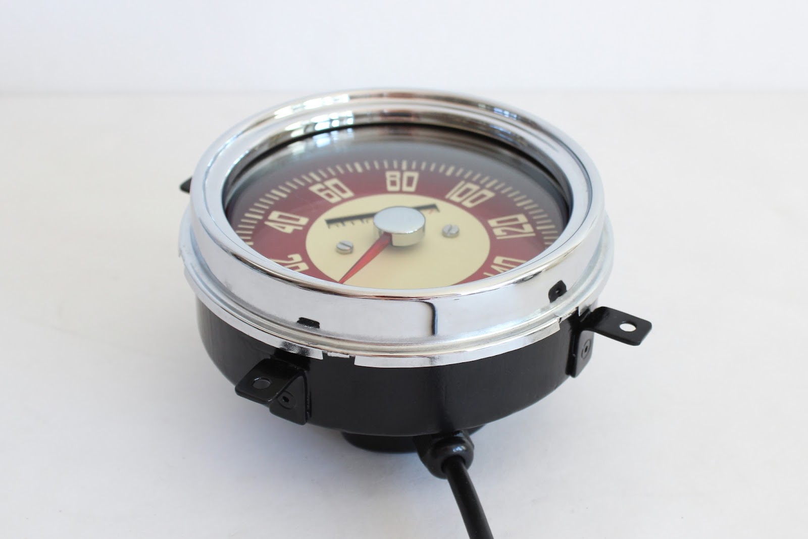

    The next is powder coating. The insides were protected from getting paint with aluminum tape
    Double-sided adhesive tape for mounting the LED strip
    LED strip with warm white light
    Inside
    Connecting
    And reassembling the gauge
    The speedometer is ready

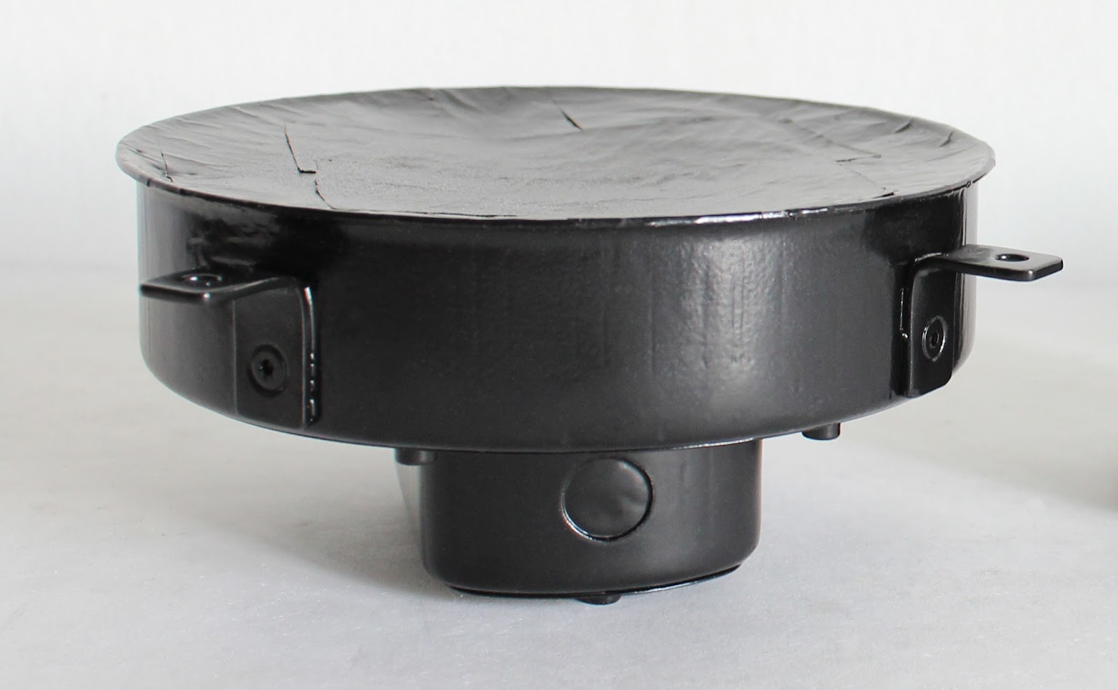

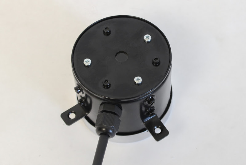

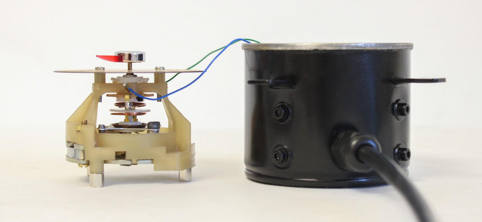

    Two stylized gauges

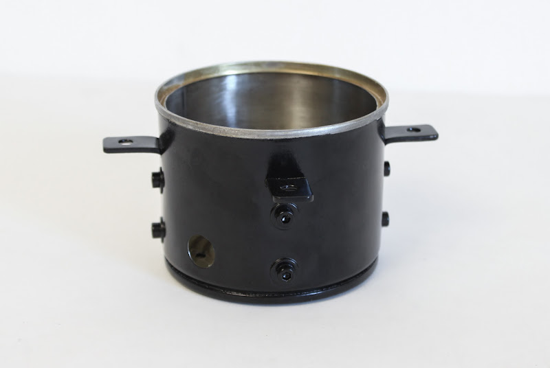

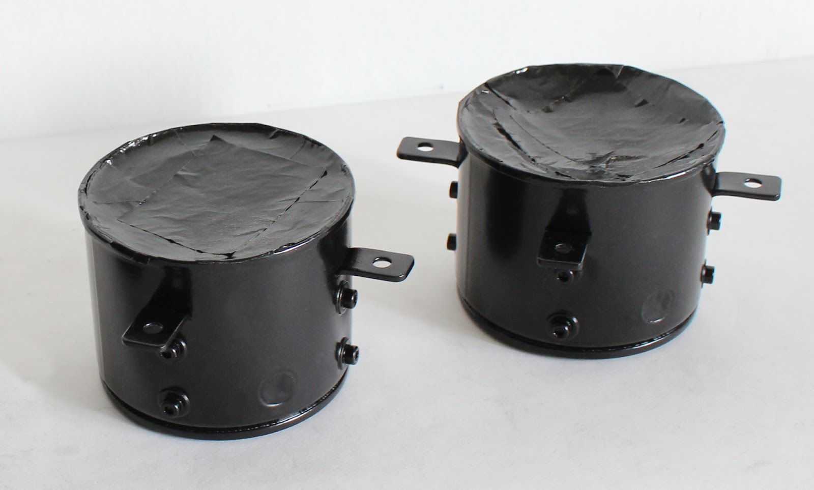

    Surprisingly, they had a tin can as a case :)
    After a few hours of wandering around grocery stores with a ruler I found the right can. It was filled with olives :)

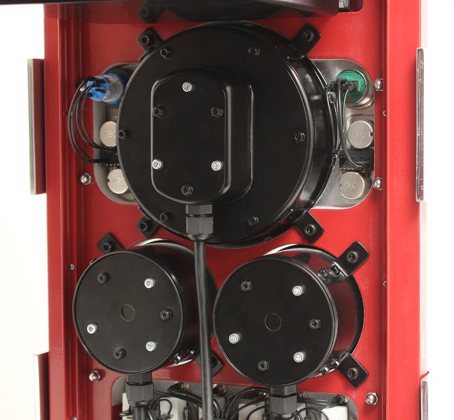

    Now I can make mounts that will fit on the front panel
    The cans after machining
    The fastens are mounted
    The bottom of the can is hardened with 1 mm steel plate
    Powder coating

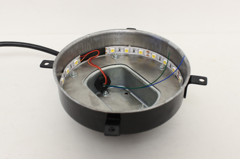

    Connecting the insides
    Inside I also mounted LED stripe with warm light
    Two little gauges are ready
    All the gauges are prepared for instalaltion
    Gauges placed
    The speedometer will show the CPU load
    Two little gauges will show the utilisation of storage space and amount of used RAM (both in percentage)

    That switch box / electronics cluster is amazing, so much in such a small space!
    How much wire trimming was required to get it quite so well packed without too much? Or is it just experience that you know how to estimate and measure it? Does it have any overheating concerns, or do those boards not kick out a lot of heat?
