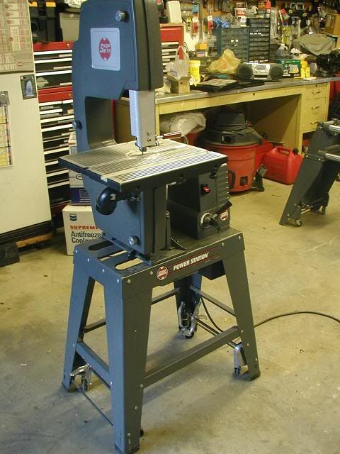

    First we'll start with some of the stuff I'll be using for this project.
    Mountain Dew

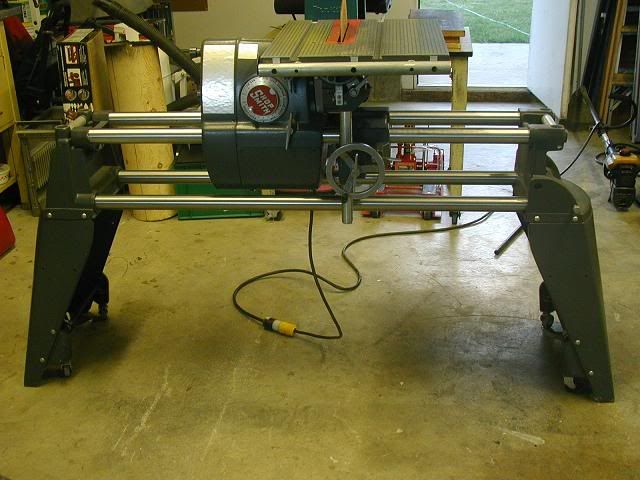

    Shopsmith Band Saw
    Shopsmith Unit w/sanding disc
    Stoner's Invisible Glass (glass cleaner)

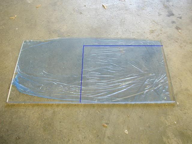

    Here is the sheet of lexan I'm using for the base of this pad. It is 1/4" thick and fairly scratch resistant, which isn't terribly important, since I'll be covering the top of it with the Teflon sheet.
    Here is the sheet of lexan I'm using for the base of this pad. It is 1/4" thick and fairly scratch resistant, which isn't terribly important, since I'll be covering the top of it with the Teflon. I've used M$ Paint to highlight the lines which I'll be cutting along.
    As always, when working with any tools in the workshop, don't forget to wear your trusty eye protection. I can't tell you how many times I've shot sawdust into my left eye and scratched the cornea. WEAR EYE PROTECTION WHEN WORKING WITH POWER TOOLS!

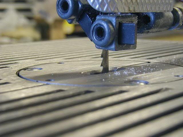

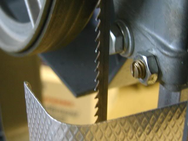

    Now that we've got that out of the way, let's get our hands on that band saw! Whenever I cut plastics with this band saw, I always use the 1/4" blade,
    and I lower the blade guard to about 3mm above the lexan, so it can slide under it easily.

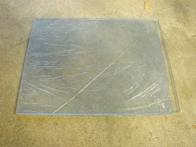

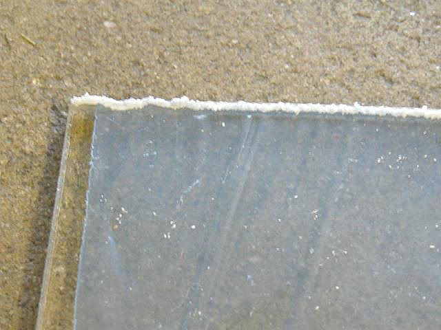

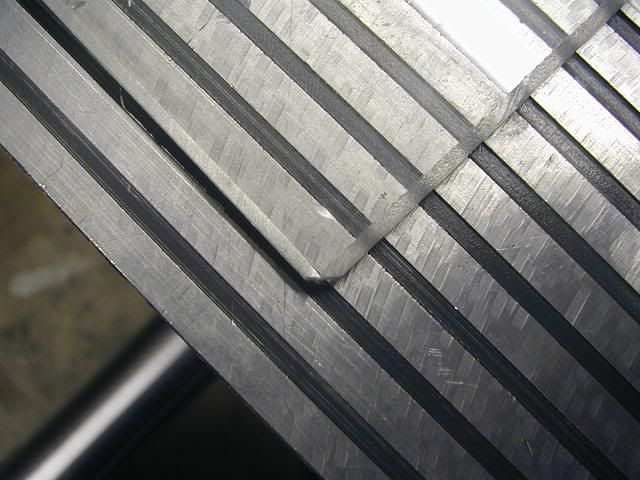

    After cutting the lexan, I get this:
    Notice the white stuff around some of the border, this happens when I use a Dremel at high speed as well, but since the band saw isn't moving as fast, the plastic cools down enough after melting, that it doesn't droop back over the cut and bond again, as it does with the Dremel.
    This white, melted and hardened plastic is actually quite brittle, and easily falls off using my thumb to push it towards the edge. And the base after cleaning up the edges a bit.

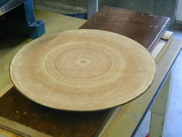

    Now that cutting the base is done, It's time to do a bit of detail work. I don't want this thing looking so "DIY", with sharp edges and all. This is why we're using the Shopsmith. For loosing the sharp edges, we're going to be using the 220 grit 12" sanding disc in place of a saw blade, running it at a low motor speed so as not to melt the plastic to much.

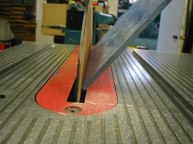

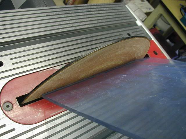

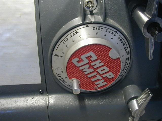

    Angling the edges on plastic with this type of setup makes it easy as pie. Just be sure to check the edge often, cause using the Shopsmith with a 220 grit sanding disc well eat away that material pretty damn fast.

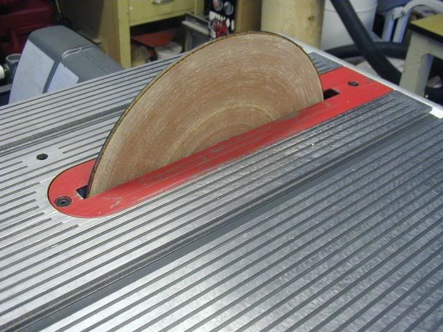

    Here is a visual of what setting I had the Shopsmith set to so that it doesn't melt the plastic to badly, but still removes material smoothly.
    To get the edge I wanted, I went down into the disc with the lexan at an angle similar to this.

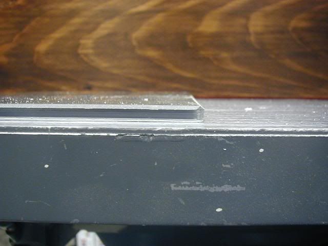

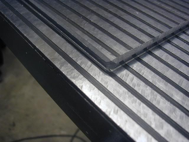

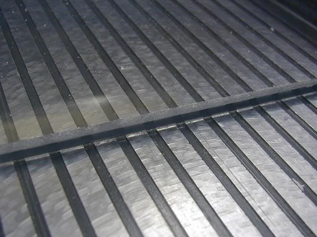

    And for now I'll leave you with some shots of the sanded edges. IMHO, I'm pretty happy with the results.
    I'm still in need of figuring out what to use for the rubber feet on this, and experimenting with the Super 77 adhesive, I'm leaving that open for discussion and opinions.
    I need to polish the sanded edges a bit, just to clean it up and not leave it so rough feeling, as that could irritate the wrist after extended use. I can't promise anyone on when the next update will be, but I can assure you I won't forget about this. :)
