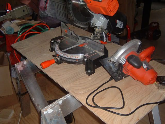

    The irony of the situation is that the miter table would be soooo much easier to build if I had a miter table to build it with. Here is how I've been using my miter saw up to now:
    As you can see, it isn't very easy to use that way. To cut long pieces of lumber I have to make a stack of wood at one end just to hold the board up.

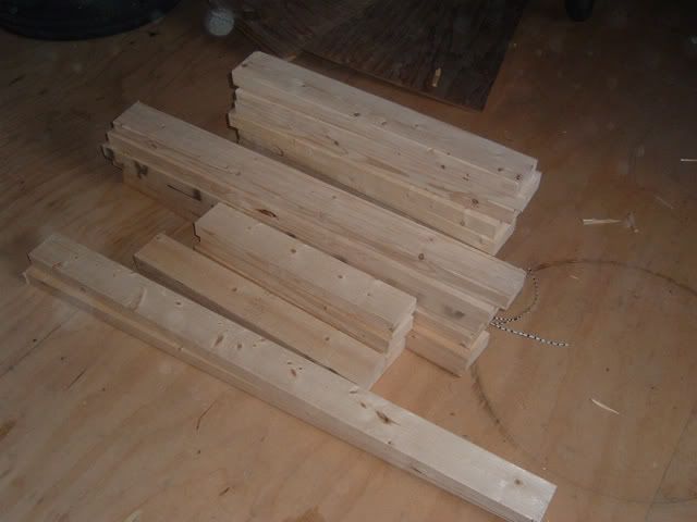

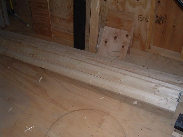

    After a lot of tricky balancing on my so-called "miter table" I was able to cut it all up into the sizes I need. Here is the almost finished stack:

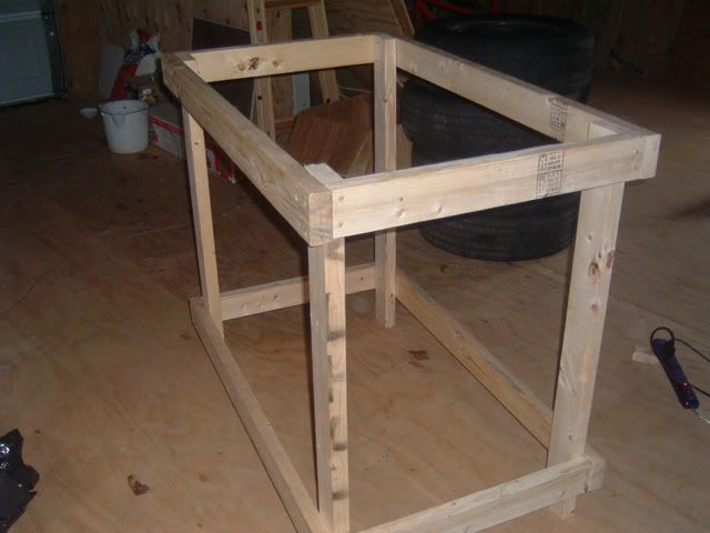

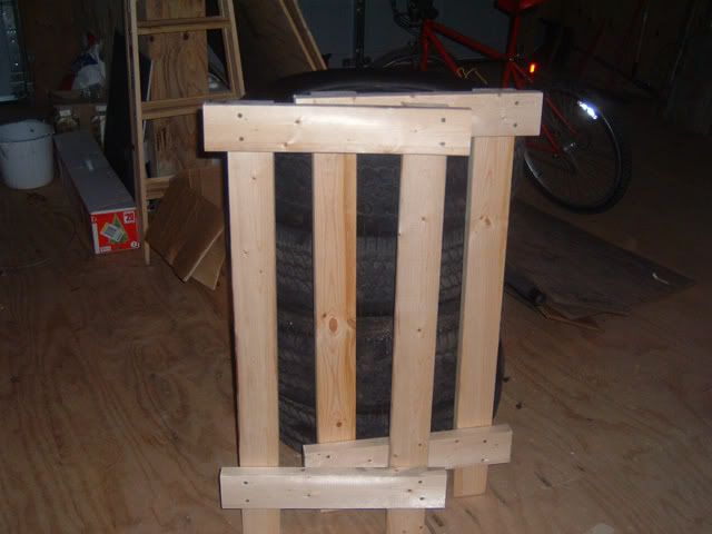

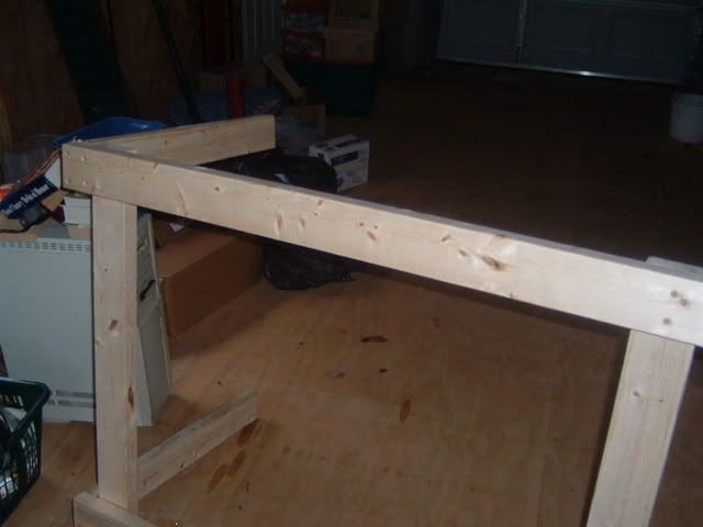

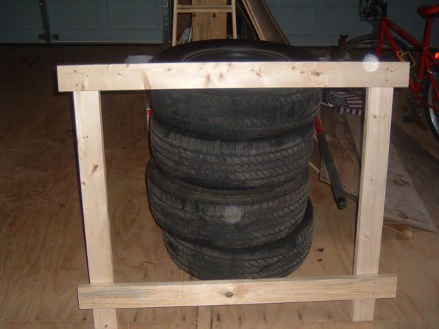

    I started off with the main bench part, making the front and back faces which will then be put together like so:
    The way I've joined the frames to the legs takes up a lot of screws (about 6 screws for each corner) but is EXTREMELY sturdy. It will need to be considering I intend for this table to hold up several hundreds of pounds of lumber and tools.

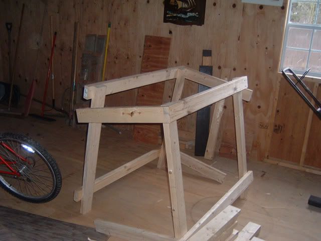

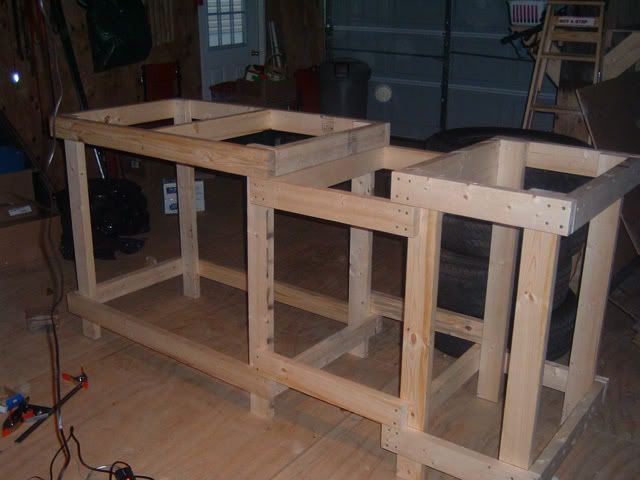

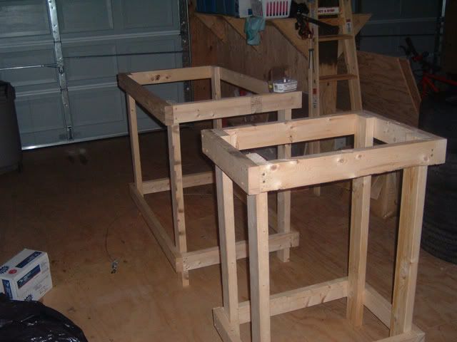

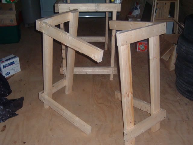

    So now that the main bench frame is complete, I moved on to the smaller bench. It is put together the same way, just on a smaller scale:

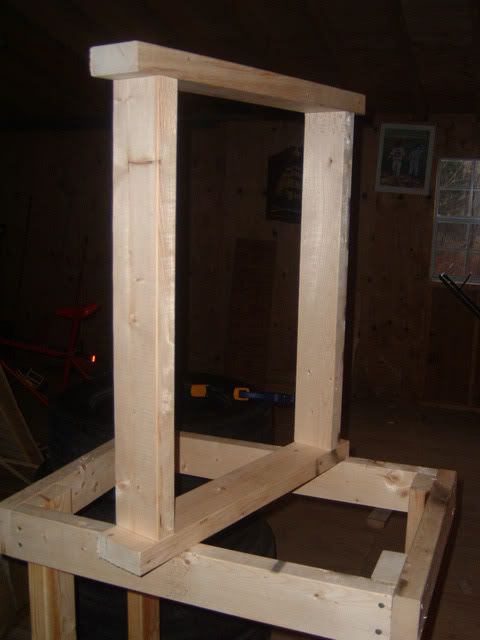

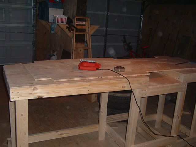

    With the two benches complete all that remains of the frame is the shelf that the miter saw sits on. The shelf itself is actually very simple:
    I varied a little bit from my original design here, in the sketchup diagram I made, all that connected the two benches together was this single shelf. I decided for extra stability to connect the two benches at the bottom as well.
    Here is the completed frame:

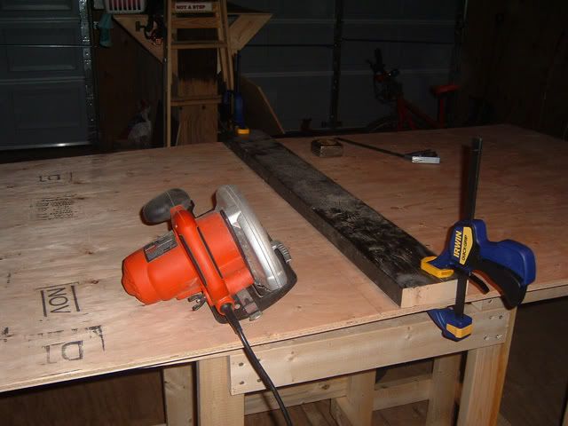

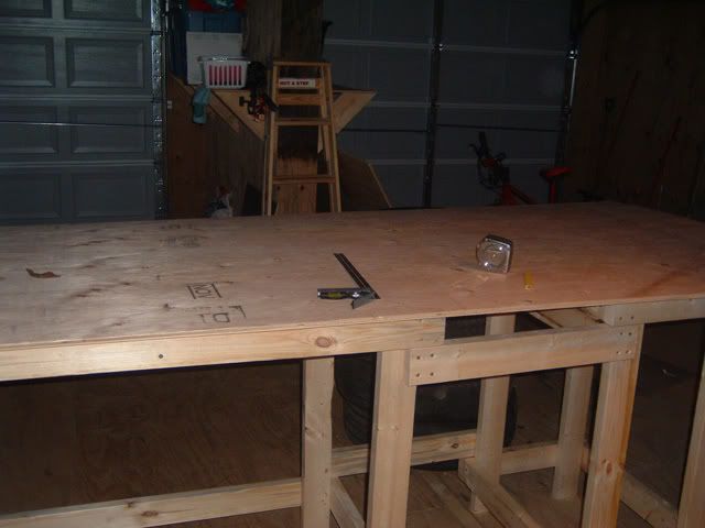

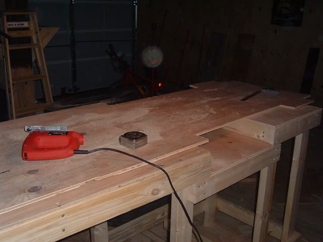

    Now on to the work surface. I dragged out two sheets of 1/2" plywood, and with the frame complete I actually had a place to cut it on :rock:
    To ensure a perfectly straight cut I clamped down another board to act as a fence for the circular saw.

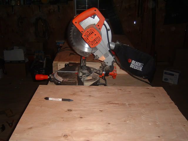

    After the top surface was completed and attached, it was on to the bottom shelf. Since the two benches were now connected I decided to do the bottom shelf in one single piece, cutting out indentations for where the frame had to pass through:
    To get it in place I just had to tilt it and slide it through one end.

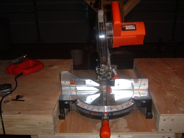

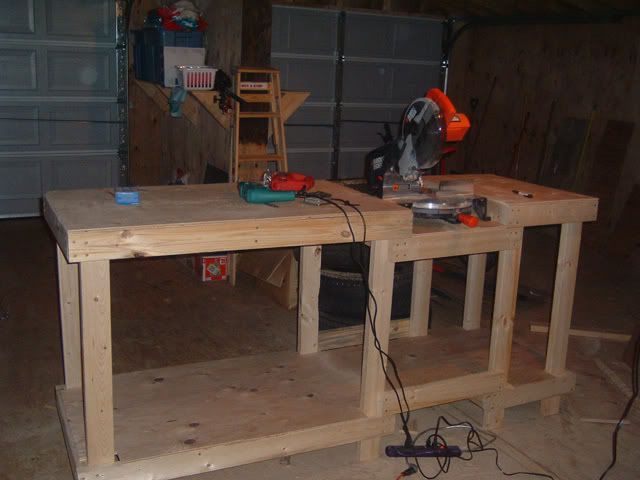

    And now for the completed product!
    Ta da!
    Total cost on this project was about $40. $27 for lumber and about $13 for the screws. I already had the plywood on hand.
