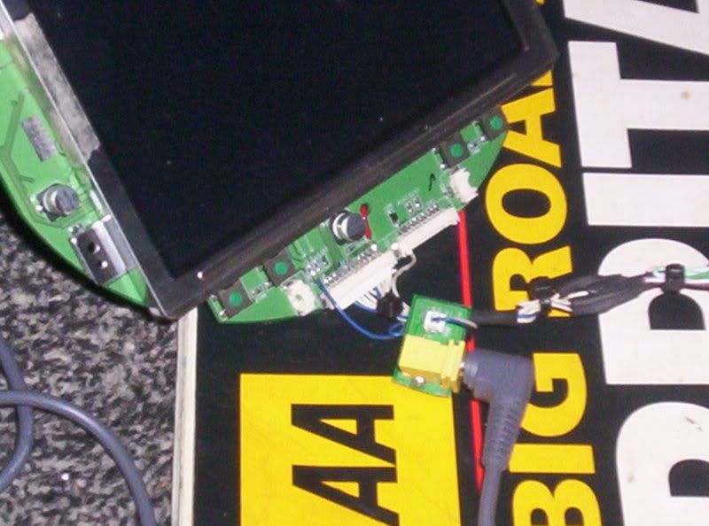

    But... had a small incident and killed the screen on the old one! :duh: So got a replacement... except it hasn't got the secondary board just the main board.

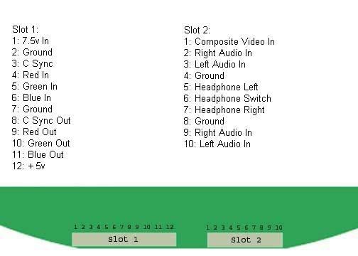

    Can anyone confirm these pinouts are correct, been messing about with it for the last few days without much luck! :rolleyes:
    Wired it up but the picture isn't anywhere near as good as the old one, now wondering if I missed something stupid after looking at it for so long!
    I've got...
    Matrox Mystique PCI gfx card,
    VGA pins 1,2,3 to Psone pins 4,5,6 (R,G,B)
    VGA pins 6,7,8 linked and ground to pin 7 PSone
    VGA pin 9 (DCC) linked to pin 12 PSone (with +5v on pin 12 via resistor from reg)
    VGA pin 13 to PSone pin 3 (csync)
    Anyone help... before I go insane! :wallbash:
