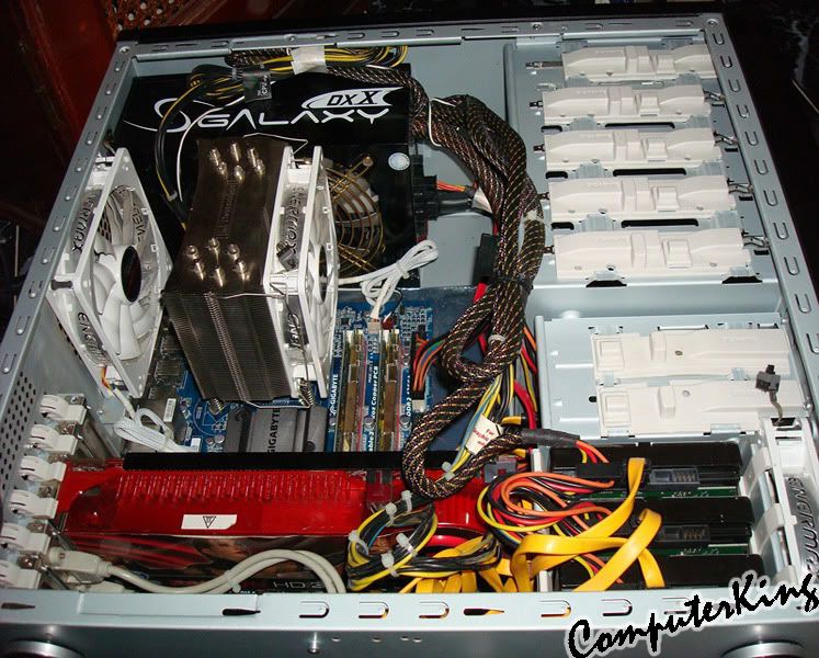

    I want your help on something if you don't mind, After like 2 years running my computer without bothering with any thing any more... Because life troubles that made me don't have time for it any more.
    Anyways, Now I want to know something. I got the Q9450 and The Ultra-120 With Enermax Clusters Fans... About The Temps, My core1,2 get same temp, But core3,4 Get lower 10 Degree all the time Even Idle or Load.
    So what the problem will be ? I got the CPU and Cooler Laped till It's totally flat I'm sure...
    What do you think ?
    Thanks a ton guys :clap:

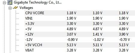

    Vcore is 1.18V All the time i think. The Multi Is the only thing that drops and rise..

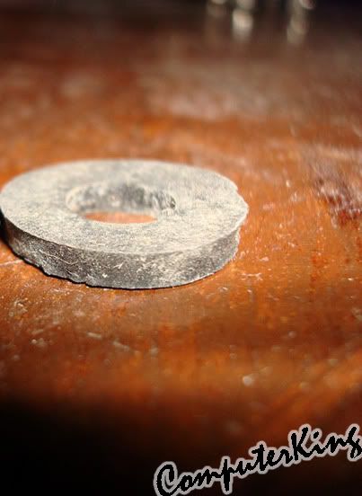

    what do u mean by the "thickish washer" ?

    You may need to experiment with different thickness's. I think the one I used was around 2mm thick.

    But Buddy I can't get the idea that you mean :( i'm sorry :duh:

    Ahh I got the idea:) I will add this washer and see what happens ;)

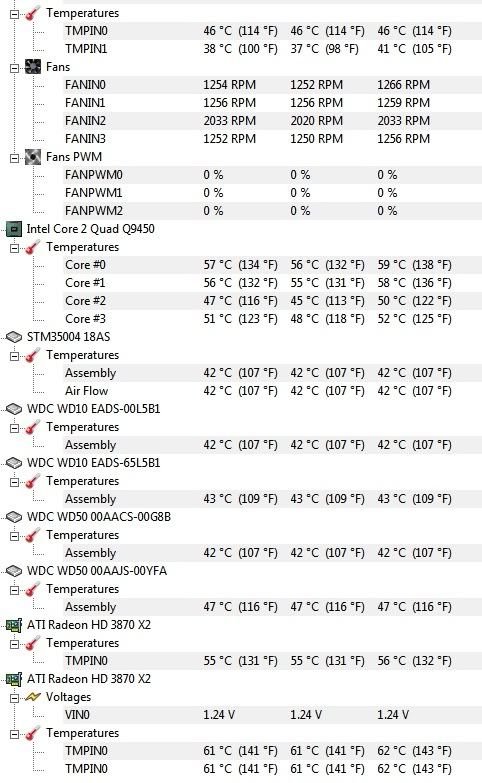

    And Real Temps Says 58 . 58 . 49 . 51

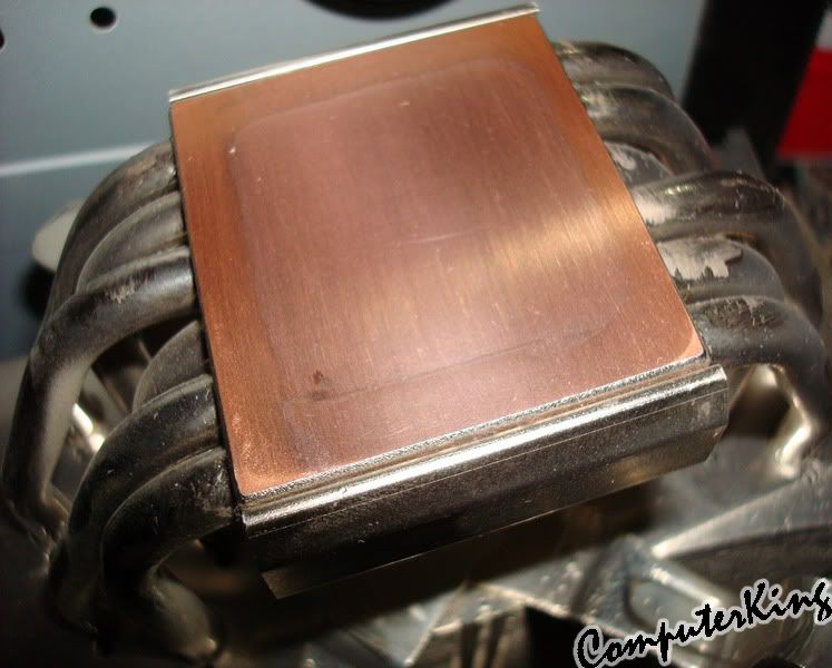

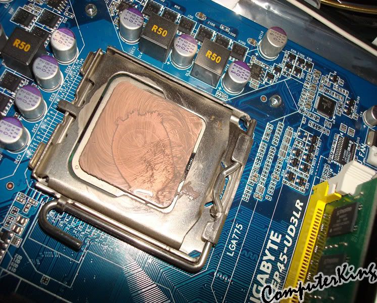

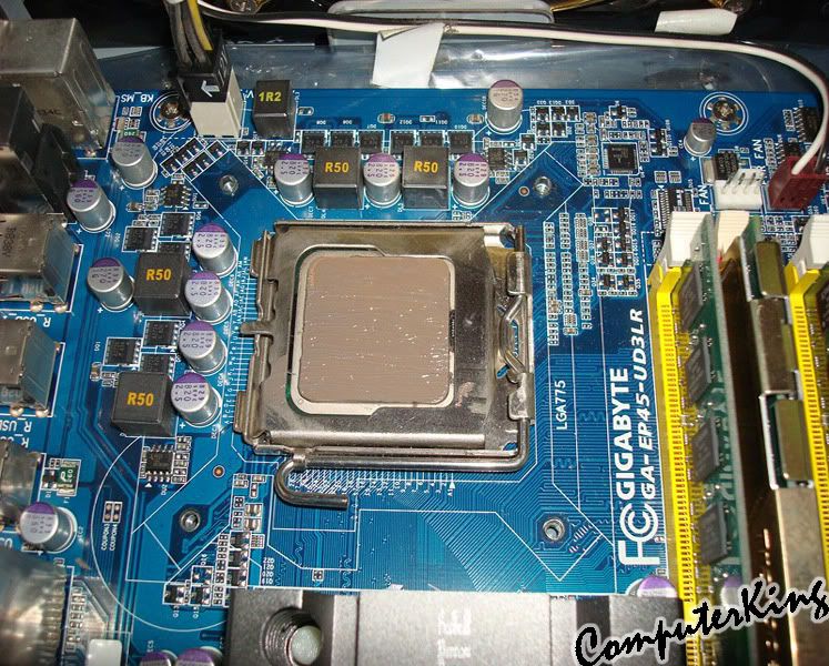

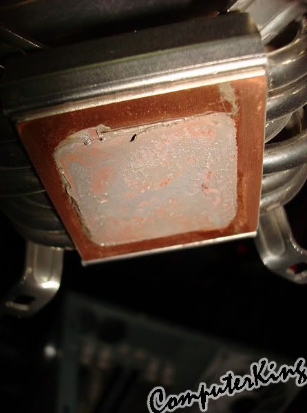

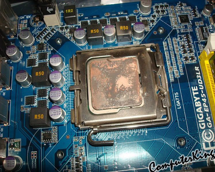

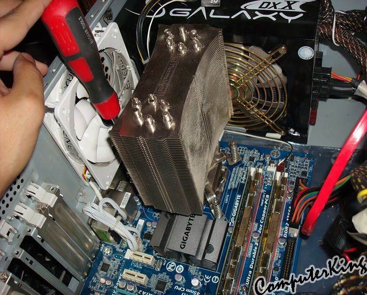

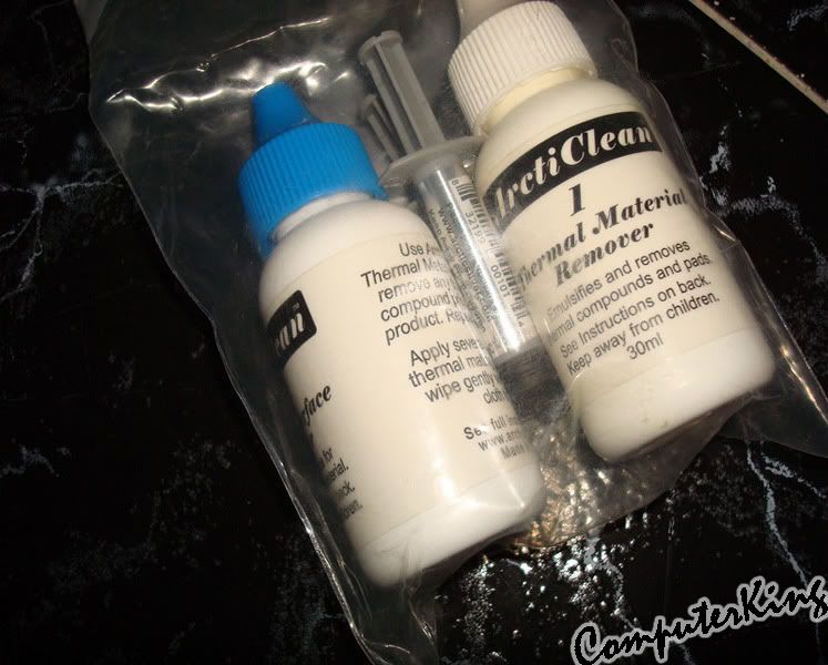

    Okay here we go, I did some work today hope it will work and this what I did and what I got....
    I still get the 10C diffrent from the 2 vs 2 cores.. :(

    724
    It's just the CPu buddy, as I keep saying, mines exactly the same :)
