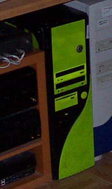

    used carspraypaint on my first mod couple of years ago(also for frontcovers like CD etc) little crapy pic
    kinda turned out so/so since the paint stuck differently to different matirials and wasn't made for plastick since it cracked at some points =(
    guess i found what i was looking for =)
