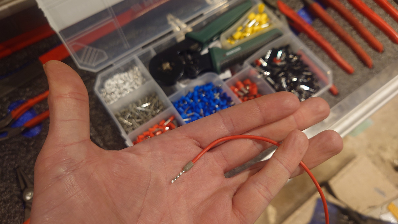

    3,813
    1,810
    No they're no good on regular crimps, they're just for the type of ferrules that are provided with it, they are used when connecting to connector blocks rather than leaving bare stranded wire

    Oh so like chocolate blocks, screw terminals ect.
    Those Ferrel's suitable for mains wiring or just low voltage stuff?

    Yeah thats just for the included ferrules, used instead of bare wire into terminals, connector blocks e.t.c:

    Mains wiring is usually 2.5mm² (albeit solid and not stranded) but that kit goes way past that up to 10mm² so it's entirely capable of being used for a mains flex for a kettle or the likes?

    £12.99 I think, I'll be grabbing one tomoz as I hate when your are trying to put stranded wires into screw terminals ect and find they've all splayed out.

    The ones you have in that box are called bootlace crimps. Used for stranded wire and are the best thing to ever grace this earth. I would use them everywhere if I could. I've lost count of the number of 13A plugs I've had to change because they've melted due to loose connections. Any time you have a screw-type terminal, the strands initially get clamped tight, but then they splay while the screw remains where it is. Now you have a loose connection. As you pull current through it, you generate heat, and lots of it.
    Here's a trick. If the plastic part of the bootlace crimp doesn't fit in the plug, you can also take a hammer and just tap the metal part out and use that on its own.
    Unfortunately, they use a different crimper than the red/blue/yellow spade crimps, but it's only about £16 and well worth having.

    I tried mine out last night, worked perfectly and the quality of the crimps is ideal. I was surprised I could fit that wire in but it funnelled in perfectly and had no trouble crimping it.
