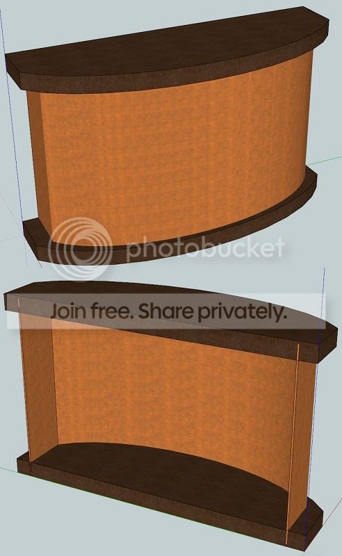

    Either thin sheet copper or thin sheet alu with copper foil tape with walnut top & bottom, similar could be done for other side.
    Or quick simple paint blast as mentioned. :D
