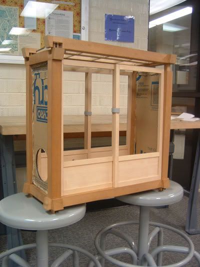

    another day in the shop, and another good update. today i concentrated mostly on the wood aspects, including the shoji doors and the top panel.
    Here are the tennons cut into the stiles, i get to hand fit each of these into the rails, which takes forever, but the fit is quite nice.
    one down...3 to go
    here are two with the bottom panel in, the kumiko (the smaller members that i haven't put in yet) still need to be installed, this will take forever though since there are 21 joints per door, for a grand total of 84....probly all done by hand once i get my tiny chisel
    here is the back end of the top panel being constructed:
    the top almost done:
    i'm having some fitting problems, but i had to mock this thing up to get a feel for what its going to look like, so here is what the case looks like thus far, note that everything isn't permanently attached, its just kinda hanging there:
    the black is just foam core, it will be replaced with acrylic
    well that's all for now, more later probably

    this is looking very nice. I like your top panel a lot, although I was curious about the front doors (you ditched that idea, right?).

    yeah, i ditched the doors...most likely. we'll see if something seems off in the end. for the top, where the black is will be the black acrylic, and for the big spaces, there will most likely be rice papar (same as most of the sides) so there will be a nice glow on the top too if i don't screw up on the lighting

    i was thinking about that too, but the black acrylic on top will join (visually) with the front and back, making it look more complete, i think at least
