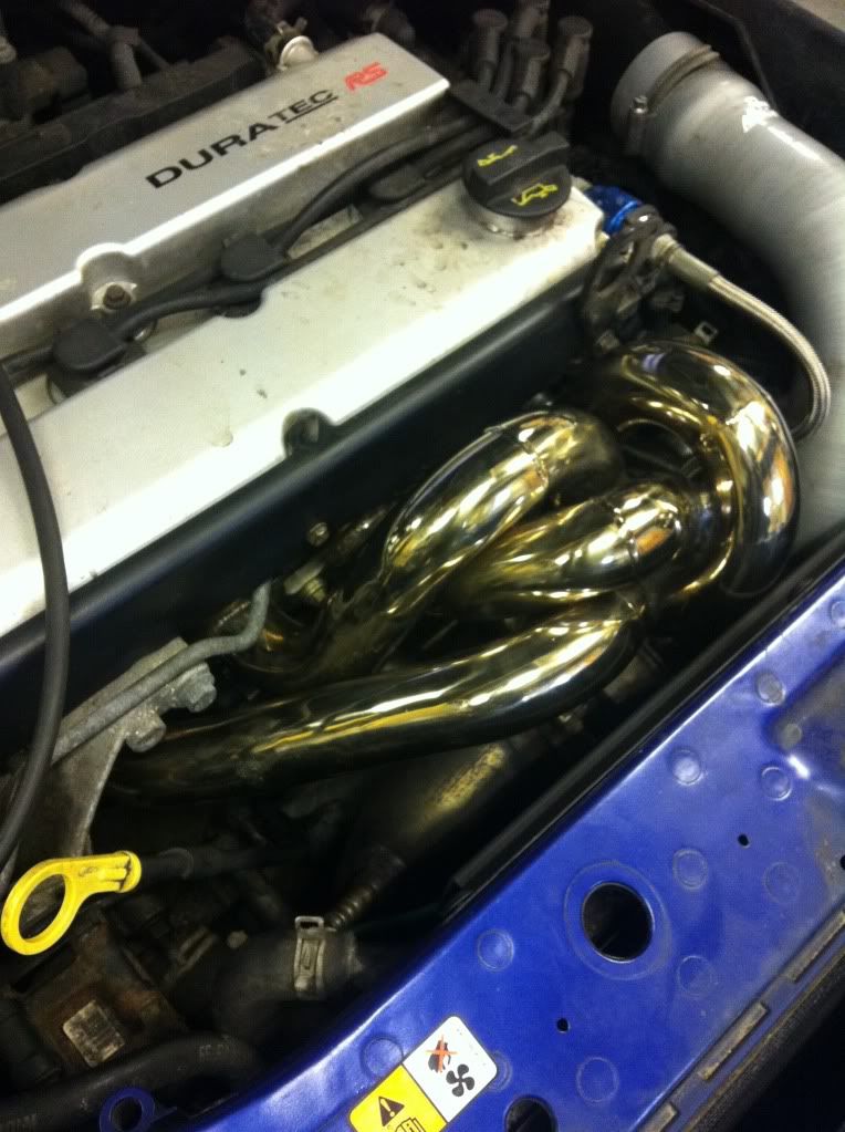

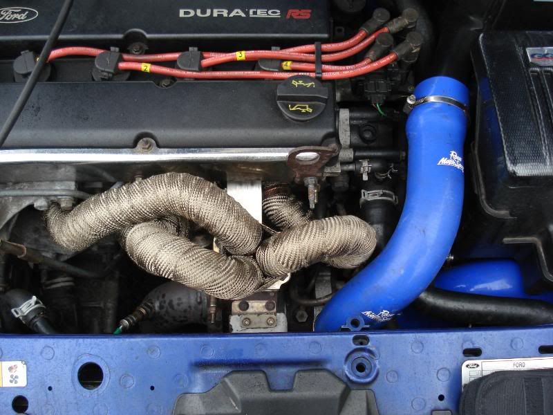

    I hate the tubular manifold looks, so I'll be sticking with the standard one for now I think :p there's only, really, a few different choices for a tubular manifold and they all look like a bunch of banana's.

    Can't believe you don't like tubi's, they're the start of every special build. :p

    The Ford Motorsports and Devil developments ones aren't great, the others look alright to me!
    Besides, it's not purely about looks, it's about appreciating for something as a performance enhancer too. Besides, I'd rather look at one of those than a horrid cast manifold or a piece of heat shield!
