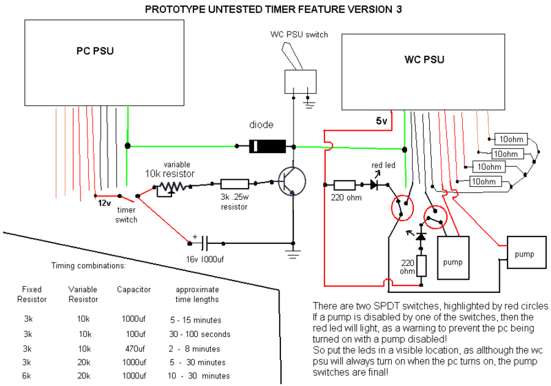

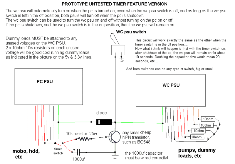

    Modded an old pic i had:
    I couldn't figure out how to incorporate a 555 timer seamlessly, so i think i've figured out how to seamlessly integrate a transistor based timer. Multiple capacitors can be used in parrallel which simply get added to equal the total capacitance, so you can easily figure out the time, but you'd need way too many capacitors for 15 minutes :eeek: There's definitely a better way to get 15 minutes using a proper rc circuit... i haven't figured that out, but 15 minutes seems like a really long cool down time for the shutdown timer anyway! I think 30 seconds is definitely long enough, unless you have other stuff in mind?
    Anyway, here's the untested timer version which i think may work as i've described... possibly :D :
    And as for the dummy loads in both of the pics, you might already know but they are needed to avoid running a psu without loading all of the main rails. I've assumed you'd be only using the 12v rails for the pumps and possibly fans, so the 5v & 3.3v would be empty, hence the dummy loads. Each resistor uses a couple of watts each, so 10w or greater spec resistors will run cool, don't get smaller or they can get hot, 10w won't need heatsinking either. If you have some sort of load on the 5v or 3,3v rail other than dummy loads, they need to be at least a few watts total to sufficiently load the rail.
    ninja edit: And that 10k resistor for the transistor is 1/4w not 25w!

    Ah, it is stuff like this that is exactly why I posted this! I had never thought of the need for dummy loads to help protect the psu, I just knew that there was something about leaving one on would be bad for it. Could I just connect like a .5 Farad cap to it... The main psu will be like 1000w anyways. But yea, I will need to look on Google and see if I can find some sort of time circuit. I have attached an image of my plan for the manual start system so that I can power the pumps when the system is off:
    The switch in the center would be a toggle switch that would probably be able to switch the + and - connections. The other two will be rockers so that the individual pump will only power up when the switch is pressed.

    Sorry, but your wiring diagram doesn't make sense :confused:
    Im guessing that maybe you want to be able to flip posistive & negative so that the pumps can go in reverse? If so, are you sure your pumps support that? I think many and possibly all pumps are unidirection, or at least most effecient in one direction than the other.
    I just thought of an idea, to add an rc circuit to my design above, giving a wide variety of delay time... I'll probably get it done later and put it up. I'll include switches for two pumps and a power reversing switch.

    Back in version 2, i estimated the delay time to be about 10 seconds... i now think that may be more like 10 minutes :D
    I've modded the timing circuit by adding a small variable resistor, any small one will do fine, and there's a table with some different combinations. My times are estimations and actual times may be a little shorter... i'm not even 100% sure on the timing circuit by the way, but it's cheap and there's definitely no risk at all of damaging anything, so you can experiment and let me know how it goes :thumb:
    Note the pump switches and the two warning leds. The 220 ohm resistor will run a 1.8v led at 15ma, you can calculate what resistor you'll need here
    I also labeled the 1000uf timing cap as 16v, which is the minimum rating you will need to use for any timing cap, since it will be charging at 12v.
    And the reversing switch version:

    Ah very nice thanks for the help!
    On my pic I was showing a switch that would cut off the power to both pumps when it was switched over to complete the circuit for the psu to turn on. This way if I turned on the psu manually it would cut the power to the pumps. I would then power the pumps using a buypass switch that would be a rocker so that the pump would only run when I press it down. This way I can run the pumps individually with perfect control while the system is off.
