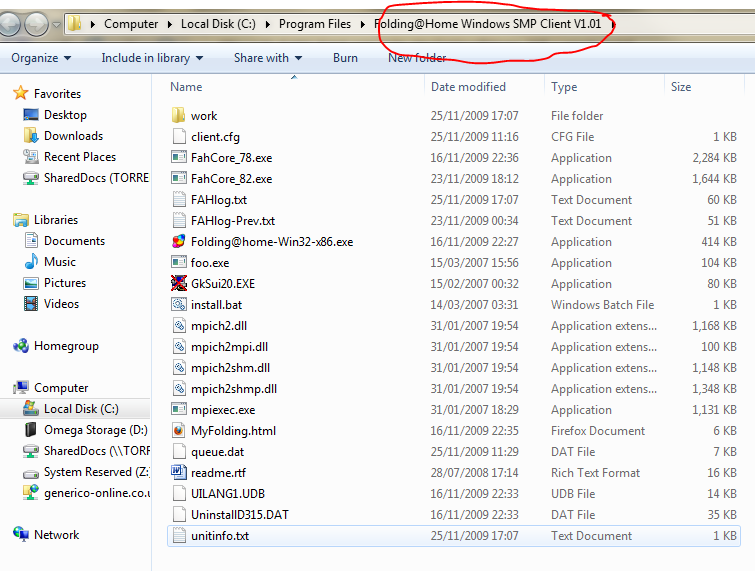

    hmm well i downloaded the multicore one off the 'performance clients page' im sure i did=/
    EDIT:
    I did the install.bat but not sure what you mean by the -smp?

    Create a shortcut to the folding@home-Win32-x86.exe
    Right click it & go to properties.
    In the target bit add -smp to the line & click OK.
    Let the current WU finish. Stop the client & click on your shortcut.
    Voila, SMP folding

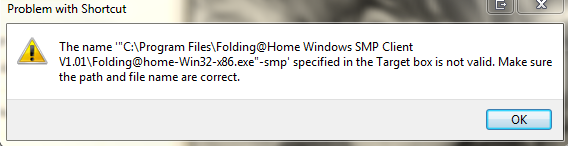

    Please tell me if im being stupid or overlooking something simple but i get this error:
  11. saspro
    saspro IT monkey
    23 Apr 2009
    9,472
    287
    you need to put a space in after the last "
    GingerFox likes this.

    YOU ARE A GENIUS, DON'T LET ANYONE TELL OTHERWISE! Thank you so much:D
    +rep to everyone that helped:)
