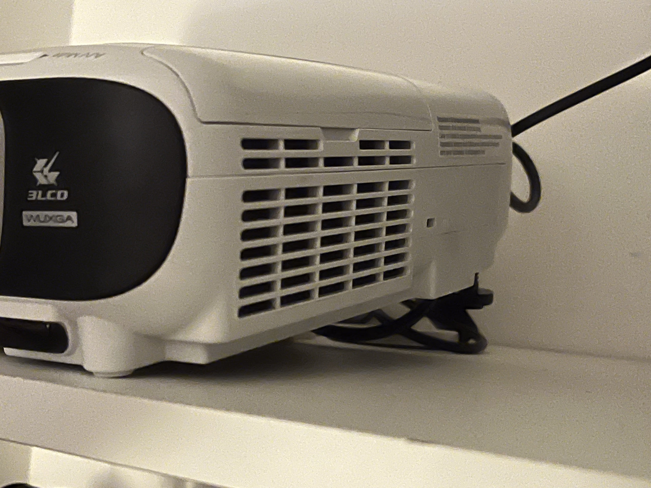

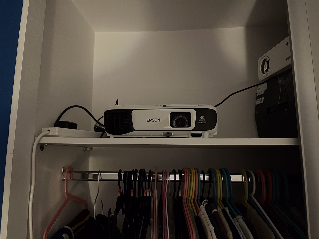

    Right now, the projector is sitting on a high shelf inside his built-in wardrobe. I don't really want to ceiling mount it. It shoots a nearly 100-inch image onto the opposite wall, but because it's sitting so high up, I have to angle it down quite a bit (currently propped up with Lego). I'm thinking of buying a basic mount to attach to the shelf so I can angle it properly, but it’s going to be a steep downward angle (maybe 40 degrees). Will this cause major issues with image quality ?

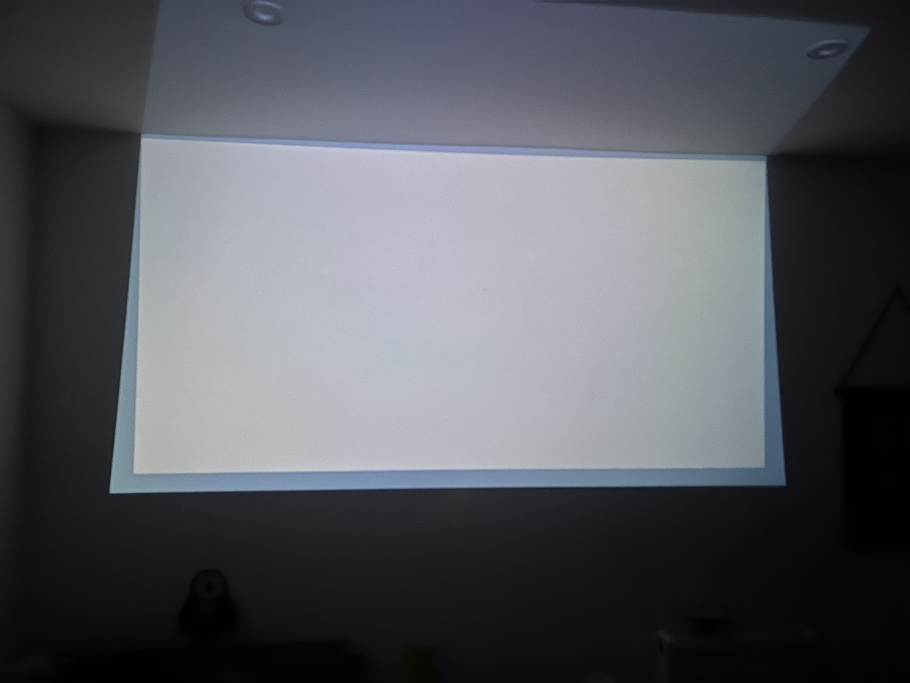

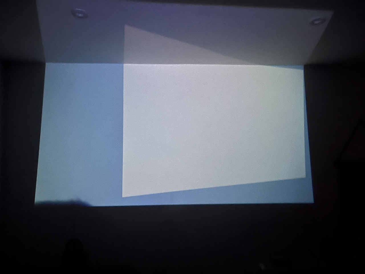

    3. The Light Border & Resolution When I use the corner correction/keystone to square up the image, it leaves a noticeable border of overcast light on the wall outside the active picture when i correct it to be straight. Is there any way to improve this? Also, when I plugged in a 1080p Firestick (after a factory reset), the horizontal calibration was way off. Is this border happening because the projector is WUXGA (1200p) and the Firestick is 1080p, or is it just because my physical placement/angling isn't quite right yet?

    1. Mounting and placement: I'm not sure why the projector needs to be at such a steep angle. I'd be surprised if, when you mount it to the top of the shelf, that the angle was more than 10-15 degrees, if that. The key thing is that the projector is as straight on to the wall as you can get it. I'd still advise ceiling mounting if you could, it'll be so much better.

    3. The problem you're seeing there is that you have an LCD projector that isn't very good at displaying blacks that well. The keystone feature basically paints black around the edges of the LCD, but because it's not very good at displaying blacks, you can still see it. Painting black borders will help.
