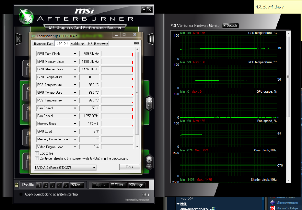

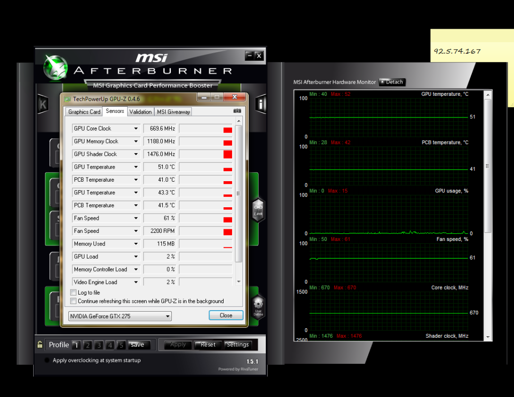

  9. CrapBag
    CrapBag Multimodder
    17 Jul 2008
    7,995
    515
    Well I am relatively pleased with the results, lower temps and lower fan speed.
    Result :)
    Before
    After
    5c less on idle and a decrease of 6% on the fan speed.
    Took the heat sink out of the shroud and used a soft brush to clean it and the fan but it wasn't too badly dusted up as I had recntly blown it all out with a compressor as mentioned earlier.
