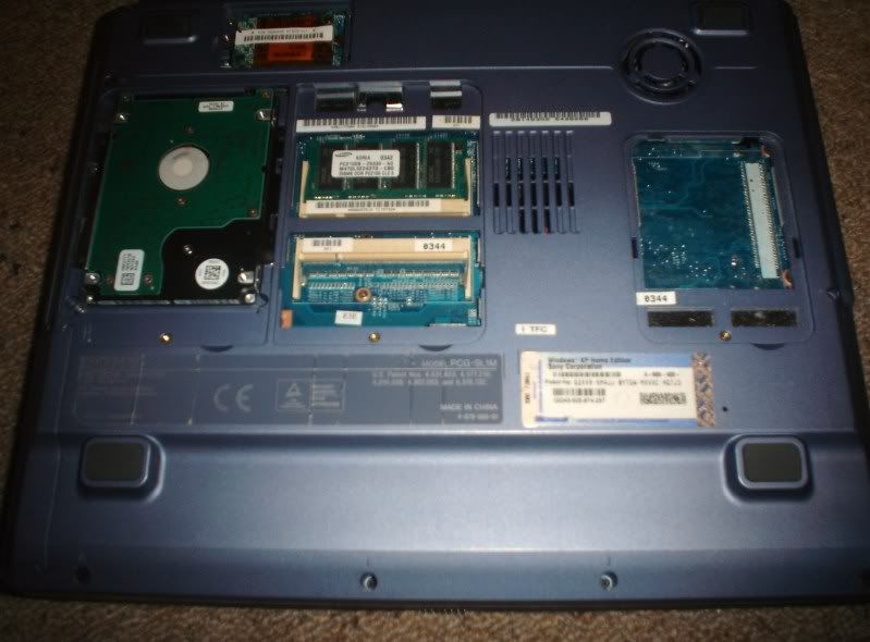

    As i dont know much about the inside of a laptop can you guys help me? I took a picture of all the insides i could get too. I can see the hard drive (left) and the ram (middle) but not sure about the thing on the far right (i think its the motherboard) and the thing in the top left (i have no idea what that is). Picture am i right in thinking that there are two ram slots and the bottom one is empty? If so then that should be easy to fit in.
    Thanks for the help :thumb:

    Yup. I'd recommend you buy two of those 512mb sticks and take out the 256mb already in it, filling up to your max of 1gb, for (assuming you buy the ebuyer value ram above) only £26. Less than one direct from Crucial :thumb:
