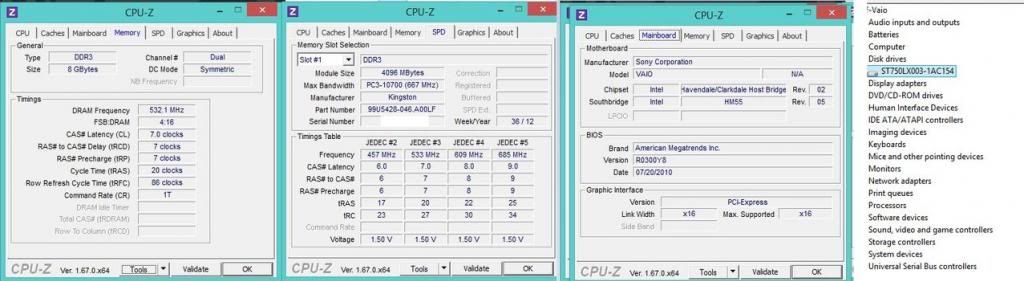

    Update :)
    The Seagate HD IS A LEGEND :D this drive is magical ;) just like an SSD but lots of space ;)
    also i added ddr3 1333mhz rams and the lap downstep them and worked perfect with no problems ;) so any vaios on this series you can update with no problems ;)
