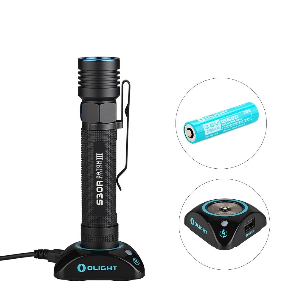

    My go-to is one of these:
    Olight S30R III
    . No holster, but the pocket clip's strong and big enough for a belt. Fully rechargeable through the bundled magnetic dock, but uses custom 18650 batteries which you absolutely should not take out and put in a normal charger: they have positive and negative terminals on the top, to make the in-body charging work, and you're at risk of shorting 'em in a normal charger. You can replace the custom battery with a normal 18650, but you'll lose the in-body charging.
    Bright (1050 lumens on turbo), multiple modes (low, medium, high, turbo, strobe, moonlight 0.5 lumen mode), good battery life, magnetic base. Good throw, but if you're doing a lot of close-up stuff you might find...

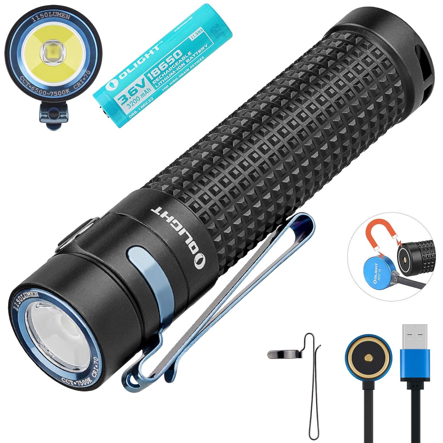

    S2R Baton II
    a better option. I have the original S2R, and it's great - less throw than the S30R, but a completely flat circle with no hot-spot on close up stuff. The new S2R II is brighter (1150 instead of 1020) and has the posh new reversible pocket clip. It's also a bit shorter than the S30R III. Same custom battery and charging system as the S30R, but it's a small USB cable rather than a desktop dock.
