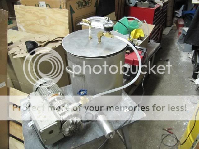

    Resin Trap
    Hello. My thanks once again goes out to the modding community in the support for this build. Update time.......
    I had to re-figure a Resin Trap for my infusion setup. The PVC ones that I was building were getting ravaged due to the crystallization process by the infusion resin. The resin heats up to almost 200F when it is setting up to cure. This is actually the curing process itself, though, it doesnt stay this temperature the whole 24 hours. The PVC tubing was just melting and buckling under the heat. So....time for Aluminium!!:clap:
    Here is the Alum Tank. I salvaged this out of the scrap bin. It is used actually for marinating food in. It will due for me. Plus I wont have to worry about over filling the trap with resin.
    I had some .090 6061 Alum laying around that was left over from the Aelro build. I cut out this round piece to be used as the cover. Drilled some holes and taped them. Than I had some 90 degree stock layin around and had it welded on the backside for support.
    This is weatherstrip for a garage doors that I bought at Home Depot, it works as a seal!!
    Lastly, I got in my 8 yards of Carbon Fiber to finish the bottom piece and rest of the frame. There is another story behind this, that I will share in the next update!
