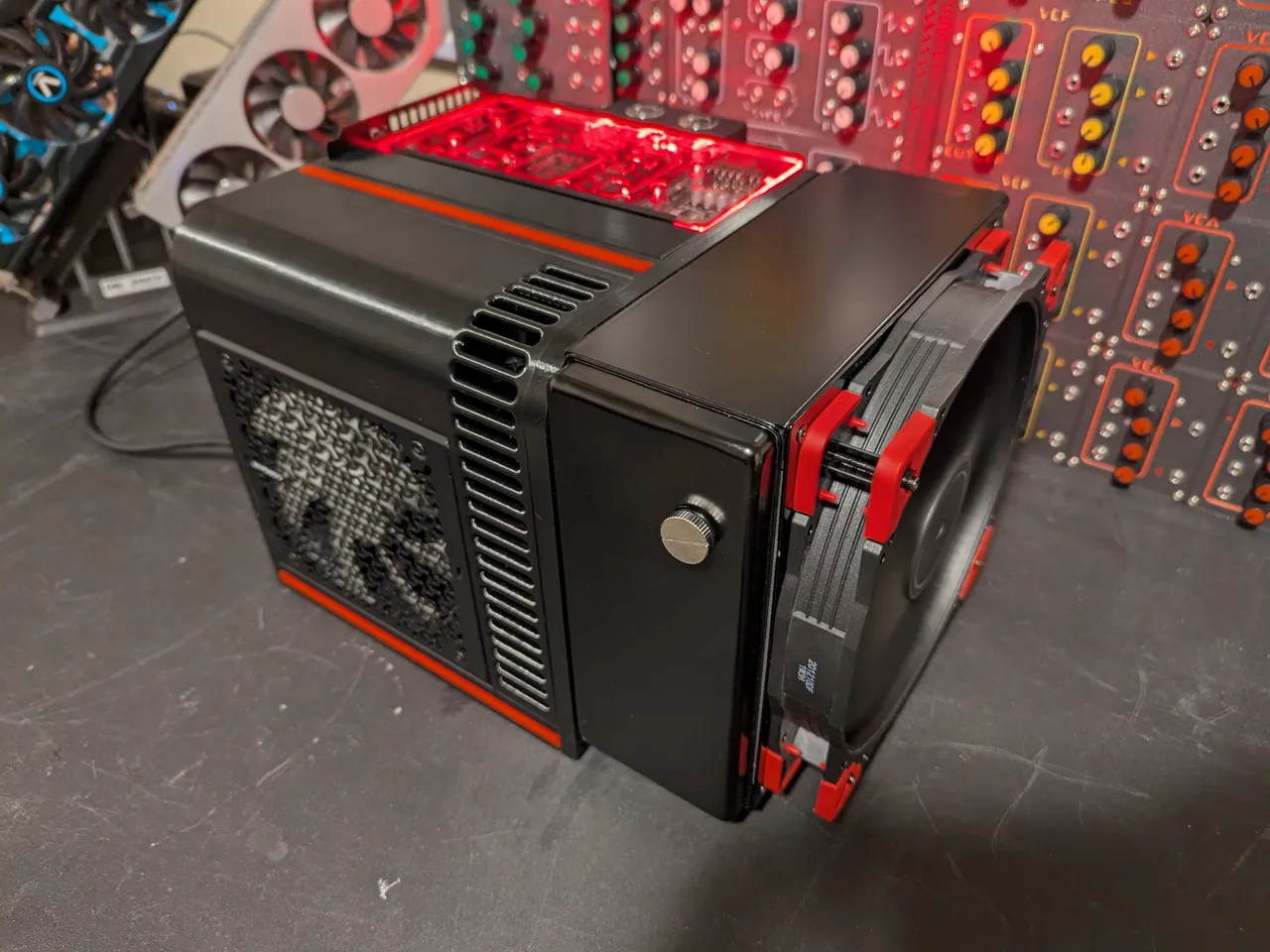

    Suspicious grid pattern on that button. It looks familiar. I've done shower curtain rod mounts, wall flanges for plumbing entry points, a sprinkler base... I'm liking this thing. Oh, and I yanked a cad file off McMaster for a pipe plug. :lol:
    I need to post a pooter design here to get feedback, since I'm thinking of making it public. Some of it looks awkward to print.
    Arboreal and Bloody_Pete like this.
  13. Cheapskate
    13 May 2007
    12,690
    2,205
    :lol: Now I need to make a light fixture because China doesn't make the classic low profile porch light that clears a storm door. Fortunately, I have several bases because the tenants throw away the covers when they change the bulb.
    Here's the rough. Two clamshells and a wiggly center strip. You can see it's going to require a ton of supports. Sides are undrawn at the moment.
    The layout ended up awkward too. the big white box sticking out of the front is a standard video card. I haven't chopped the mount hole out yet.
    The whole thing should fit in a standard 10" print space. Internal layout is awful to focus on external looks. I plan on making the b*tthole looking thing modular for power button options.
    Anyway, Feedback? Break it up / leave it whole? Layout? Magnet or screw for case top, or just make the sides removable?

    Whichever way you orientate it, you're going to get layer delamination on those edges. Or use support and then have to clean it up/ This would be the perfect thing for a dual nozzle printer with PVA support material! Could prototype is on an FDM machine and then farm it out to a SLS in nylon for the final version? Thats what I do for a lot of my stuff, or have it made by PCBway

    Yeah, the ridges are going to be an issue.
    If you print it so that the ridges are parallel with the build plate then every single ridge will need support material, or you’ll have sags & layer delamination.
    If you make the “band” around the sides a separate piece that is printed independently and glued/screwed/press-fit into place, you could theoretically split the case in half (or into sections) vertically so that the ridges print perpendicular to the build plate and therefore won’t need support. But that would still need support material for any internal voids/overhangs, and you’d probably have a bear of a time making sure the ridges line up correctly and the “visual flow” isn’t broken.
    Don’t get me wrong, I really like the concept, it’s a lot more visually interesting than most cases out there :happy:. But it does have a lot of complex shapes, and that can be very tricky for 3D printing.

    Its actually probably easier to get it CNC'd If you made the sides separate pieces it wouldn't be too crazy expensing I bet! Or the old laser cut acrylic sheets!
    Edit: another thought, with it being so big that will take days at a 0.2mm nozzle for good detail, and the likely hood that something will fail is really high!

    @Byron C -That was the plan: Top/ middle/ bottom are separate, so you can unplug the psu wires and pop the top. I was thinking I need to break the band up so most of it can be printed face up. Recesses on the edges for better fit placement and even spots for pins. Complex shapes is kinda my kink and why I bought a printer.
    @Bloody_Pete - :( I really like sharp edges, but I can try filleting the final a bit. CNC would be for someone else. :lol: One part on That Servers.com build I did cost $1000+ just to cut, and that was by Bill's friend/machinist.
    More breaks in the design with blatant dividers sounds like a plan. -Small parts/short print sessions. You should have seen the more complex stuff I was playing with.

    Not so much a case as it is a series of brackets. :lol:
