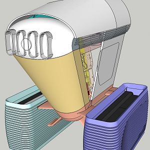

    -God help me... I don't have time to test or print stuff I've drawn up, but plenty of time to draw during *ahem* -alone time.

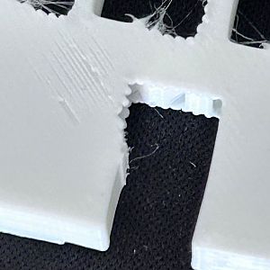

    Managed a full print that took 13 hours(ish) and finished late last night. Same print as above. Lot of stringing. And odd 'missed' bits.
    Elegoo PLA+ at 220 start then down to 210.
    0.2 layer height
    I did have it going slow, not that my printer goes that fast anyway. But, first layer/infill 30mm/s, walls, infill etc 40mm/s
    with acceleration at 400mm/s. Going to do a retraction test model like I did the other day with the PETG, did a few 'calibration' things with some models from this place..
    Not that I rate most, it seems to do those perfectly straight off the bat. Then try an actual model/print and it goes to ****. :hehe:

    Retraction calib test so far... starting with retraction distance 3 (bottom), 3.5, 4, 5, 6, 7.
    At 40mm/s speed, 40mm/s prime, 0 Zhop.
    [​IMG][​IMG]
    (Finished one on right)
    I've only gone back to PLA because PETG was being an arse. I want to print a little
    ITX PC 'case' and NAS case, which would be better in PETG than PLA I guess.
    Of materials I have anyway. So annoying that can't get PETG to behave. :hehe:

    Z Hop is a retraction setting to prevent scraping or dragging. Could be worth looking into it a little further in regards to your earlier issues.
    pete* likes this.
