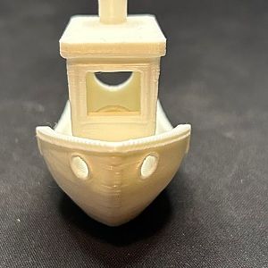

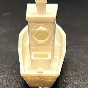

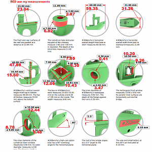

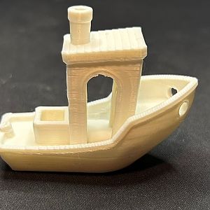

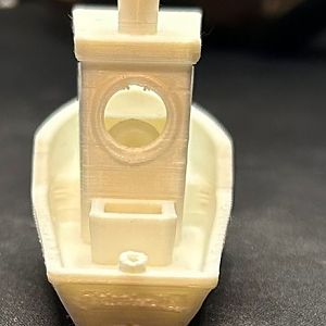

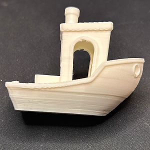

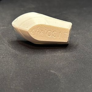

    Jealous of these nice big things you guys are getting off ;D haha. I'm apprehensive at the moment to start the longer prints after its failed a few times to complete
    some. But heres a Benchy i've done... not done one before. Along with measurements.
    Seems the overhang is a struggle for mine. And other bits but need to work out how to decipher them. :D

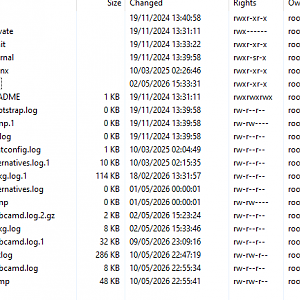

    I did this from the 3D printer SD Card directly, as I tried twice with OctoPi (on Pi) and they failed. Just stopped at some point in the print. Can't find a reason.
    Does anyone know a way to log the Pi itself - as I think it might be that, not OctoPi - could be restarting or something. Just a way to constantly log and if it shuts down, send
    the log to somewhere for me to see easily. I thought there would be a system log file... but (in one of the images below, none of these files show anything...)..
    But first.. Benchy boi
