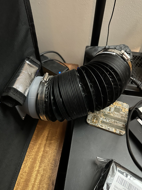

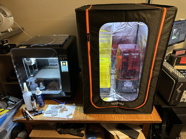

    I am finally returning to the resin printer…
    So. I bought one of those “3D printer enclosure” tents that look like something you’d use to start your own cannabis empire with. It’s big…
    Like… super big…
    But. One 3D print later, and I have a 70mm-to-100mm duct plate.
    I already had some ducting and an extractor fan from earlier in the year, and yesterday I took delivery of enough ducting to make it all the way to the window.
    I’ve just finished embracing the jank by stringing 100mm ducting across the back of my desk, and I’ve got the lid off the resin printer inside the enclosure. There’s no resin in the vat, but I can still smell the stuff if I stick my head in the tent. I’m about to go splat some Terrans (aka, play StarCraft II) for an hour or so; if I can’t smell anything outside the tent in that time, the next test tomorrow will be to actually put some resin in the vat.
    pete* and IanW like this.
  15. Bloody_Pete
    Bloody_Pete Technophile
    11 Aug 2008
    8,816
    1,447
    One thing I discovered with my exploratino of AC hose over the summer, above 4m or so 100mm hose needs a lot of input pressure to get airflow at the end, I think its the walls create a lot of turbulance and friction so it just slows to a stop. 150mm was massively better. I never tried a inline fan to boost pressure but in theory it'd work.

  18. Byron C
    Byron C AKA “Sticky Equilibrium” on weekends
    12 Apr 2002
    12,321
    7,223
    Aye, the amount of ducting I've currently got hooked up is way too much, I can already see I need to cut it down. I'm already using an in-line extractor fan, I never even bothered trying something like a PC case fan.
    This isn't going to be the "final" site for this printer anyway. I actually picked it up for my brother, but he lives with my mother who has COPD - not even gonna contemplate taking this lot to their house until I find a reliable way to manage fumes.
  19. Bloody_Pete
    11 Aug 2008
    8,816
    1,447
    Just remember if you run resin and its not fully venting, it'll hold in the hose and then probably creep back into the room, just keep it in mind :)
  20. Byron C
    12 Apr 2002
    12,321
    7,223
    It’s easy to check though: check if air is blowing out of the end of the hose.
    • Less air than a fart: need shorter pipe or moar beefy fan
    • At least a gentle-to-moderate waft: bad stank will go where you want it to
    :grin:
