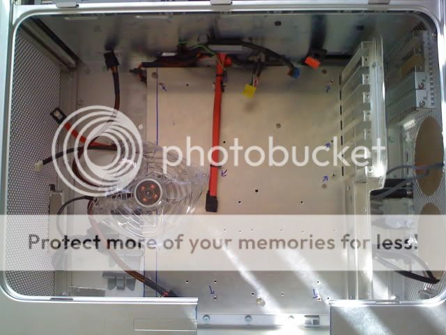

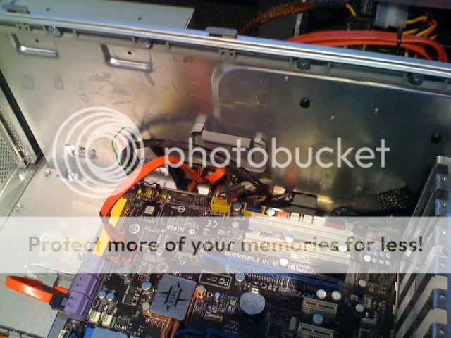

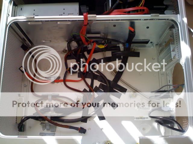

    Here's a small update which consists of removing the fan and slightly improving the cabling by sticking the molex and sata power cables under the mobo tray.
    As you can see, the fan is there and the molex and sata cables are protruding at the top left corner of the motherboard tray.
    The naked case :blush: (cabling nightmare!!!)
    Much better! The fan is gone and the cables are tucked away nice and neatly under the motherboard tray.
    Just another view...
    Thanks for reading! Stay tuned :thumb:
    The next update will be tomorrow or after tomorrow when the heatsink arrives.

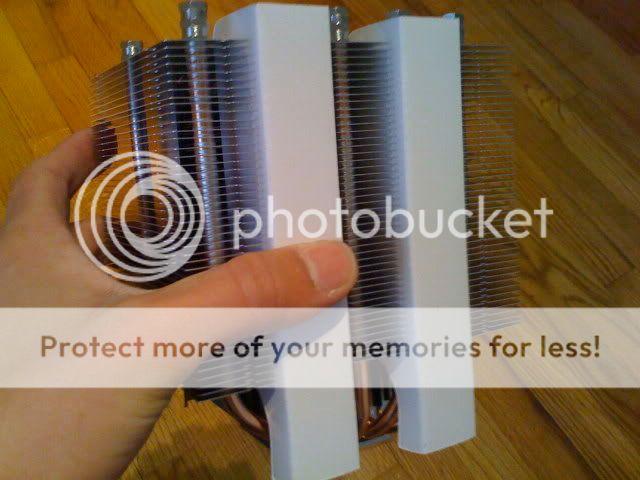

    I have to wonder why on earth you decapitated your heat-pipes...
    Seems like a nice way to fry a processor when you consider heat-pipes are supposed to be a closed unit.
    Otherwise... I like :thumb:

    Don't think that I did that for the hell of it lol. The heatpipes were the only things getting in the way of the heatsink fitting into the case, and because I was impatient and didn't want to cut the case I cut the heatpipes.

    you know chopping the top off the heatpipes breaks them? They have a vacuum inside which you would have broken...

    He's making a good point though.. I understand why you did it, so that the cooler would fit in the case, but I don't think you understand the amount of damage you've done to the cooler..
    Its now useless, as it won't conduct heat properly so your CPU will fry.. If you don't want our advice, then I look forwards to seeing your new CPU.

    Now I know :duh: :wallbash:

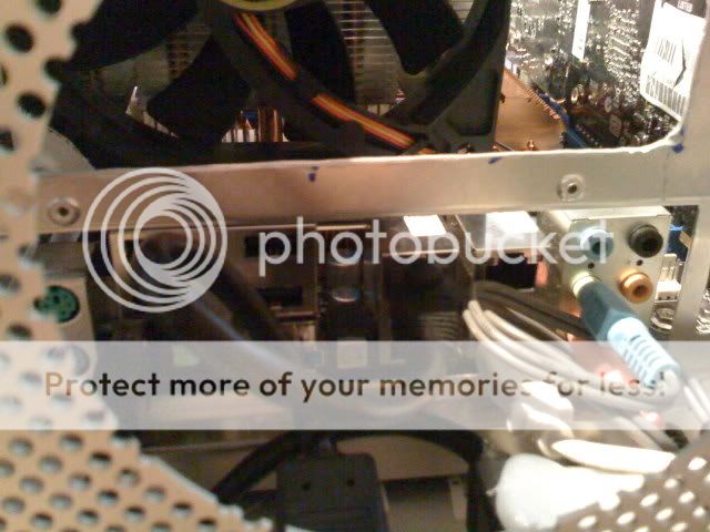

    Update! 4/15/09
    The heatsink finally arrived! I'm glad to report the installation was a success! However, I hit a snag later on. Read more to find out:
    The box from Newegg.
    The new heatsink in all of its glory.
    Well...it LOOKS like it's going to fit....
    Installed! :clap:

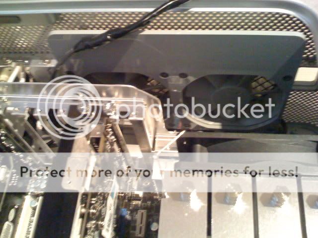

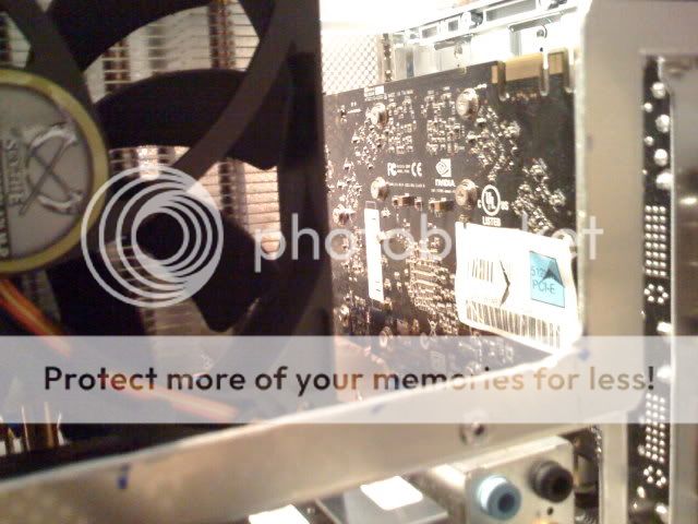

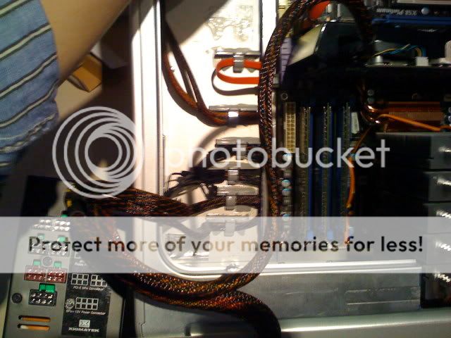

    A continuation! 4/15/09
    Motherboard inserted, looking good.
    Cables connected....again.
    More cables

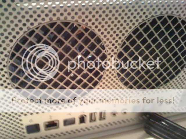

    I didn't take any chances with the hole, and I was actually grateful I made the cut bigger because installing the fan was MUCH easier.
    Fan installed! :clap:
    Rear usb :blush:
    The fabled right angle dvi connector :rock:
    Fan grill installed...
    Fans installed!!! The part I've been trying to accomplish for the past week! :clap::clap: :rock:
    This is where I hit the snag.... read on.
    All installed quite nicely :D
    Lookin' good :D :rock:
    All closed up :D
    Rear cabling....
    And a top view.
    So, everything went extremely well. I thought I was finished... at least up until I hit the power button. Immediately, I was greeted with the sound of two EXTREMELY noisy fans. It wasn't the fans themselves, but an odd clicking noise (probably a rpm counter gone wrong). Anyway, I disconnected the two fans and am awaiting the arrival of two new, silent fans :rock:
    For the most part, it's done :D Thanks for reading, updates to come!
