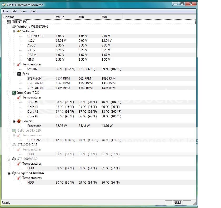

    Ey guys just got my core i7 build and im plugged it up not neatly for air flow.
    Since this is my first build for a while previous system was a p4 im unsure what temp's should be at idle
    atvm they are these
    Room temp is prob 22-24degress atvm
    Seems a little too high????

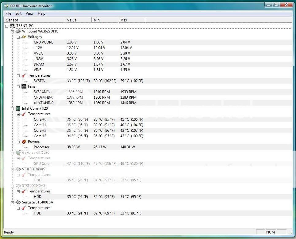

  2. Trenthan
    Trenthan What's a Dremel?
    3 Dec 2008
    82
    Sorry for the low res off phone dont have mi camera around
    Current looks like this so more real airflow
    Btw its a
    Core i7 920
    Noctua NH-U12P (Two fans)
    3x2gig Cosair Dominator 1600Mhz
    ASUS gtx280 (single for now 2nd card coming in a few days)
    I still thought the heat sink would help more, it probabiliy will once i clean everything up
    Cheers Trent

    I'm not entirely sure for the i7 but it seems alright to me.
    Your cable management however...

    Seems fine to me - it depends on what it's like under load, with the case all sealed up though. :)

    Running prime 95 in all 8 thread, max heat is ~60degrees after 15mins though, it should go up.
    Cleaning now so ill post them later

    well i cleaning it up, soz bout poor images from phone 1MP lol
    idel
    about the same, test under load soon posted

    I was under the impression that the i7 cores were supposed to run cooler than the 775 chips? 60*C using one of the BEST air coolers you can buy under full load seems a touch too high to me...

    Looks like the hsf is sat on the cpu ok though, as the core temps aren't out by much (i.e. core 0 and 1, and 2 and 3 are only 4c out at one point), so the contact seems fine. I just wonder if there was too much tim applied or maybe it's not quite gone 'off' yet?
    What thermal goo (tim) did you use on the cpu/hsf? Artic Silver 5/Ceramique/?

    i used the thermal paste given with the cooler, didnt add to much either the 4-5mm diameter spot they advised.
    From what ive seen of a few other sites and a make who has the thermaltake exctreme cooler, his is only a few degrees lower sitting on the other side of the room, same case, same setup just different cooler
    (We both thought it would run cooler, we didnt attach the provided intel cooler/heatsink went and added our new ones right away so we got nothing to compare the temps to, silly of us lol)
    Under load was a differnt, was 4-5degrees cooler ~55C in comparision to 60C with cables everywhere, GPU was similar

    Just posting the higher res pics like i said,
    Final Rig
    Core i7 920 @ stock clock 2.63Ghz
    P6T Deluxe m/b
    Corsair 3x2gb 1600Mhz lat 8-8-8-24-2T
    2x SLI asus gts280's
    Corsair 1000W power supply
    2x 1Tb Seagate sata drives
    Thermaltake armour + (case)
    Pioneer DVD burner (blue ray to come :))
    Final temps with system closed
    Ideal
    CPU (Four cores) ~40C
    GPU1 (Upper one) ~43-45C
    GPU2 (Lower one) ~44-46C
    Load
    CPU (Four cores) ~60C
    GPU1 (Upper one) ~82-84C (GPU Fans on auto)
    GPU2 (Lower one) ~84-86C (GPU Fans on auto)
    GPU1 (Upper one) ~73-75(GPU Fans on 100%)
    GPU2 (Lower one) ~75-87C (GPU Fans on 100%)
    images of rig cables tidy,
    Cheers thanks for the help and advice along the way, not jsut in this thread :)
