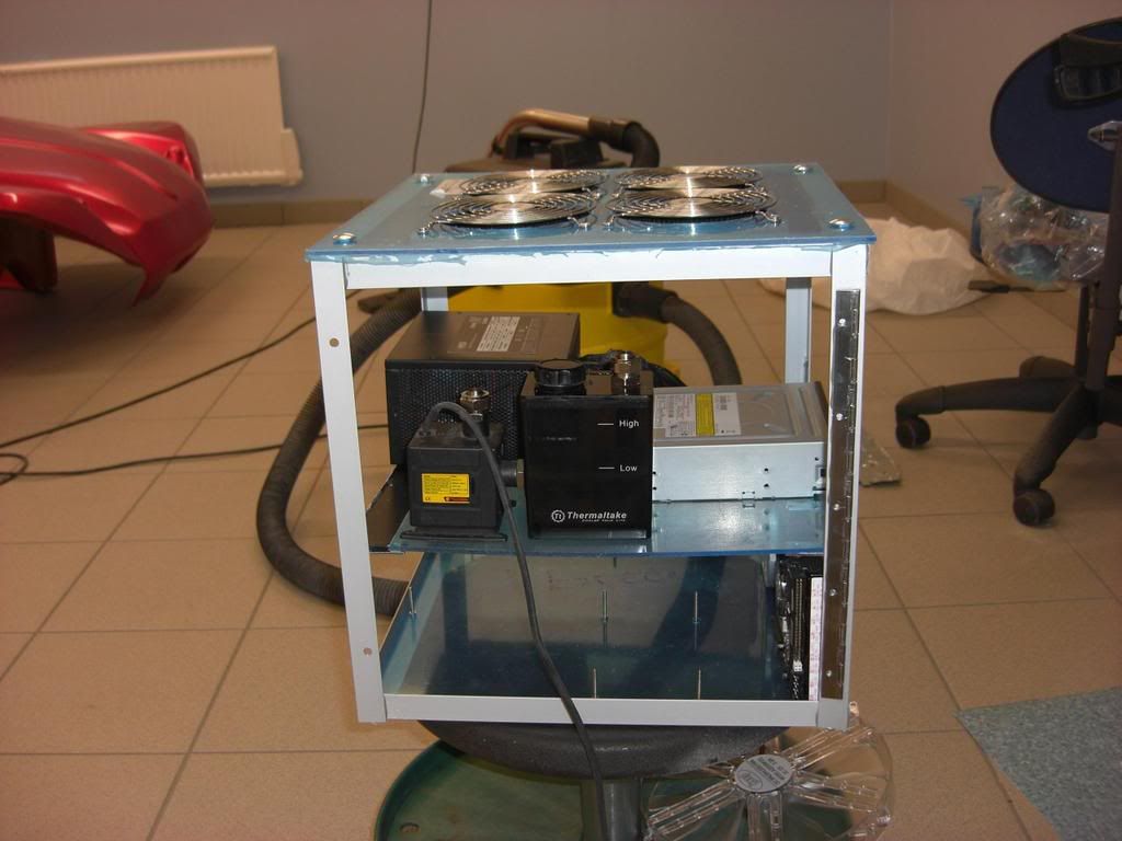

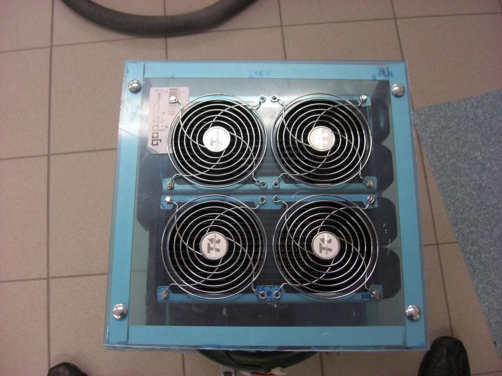

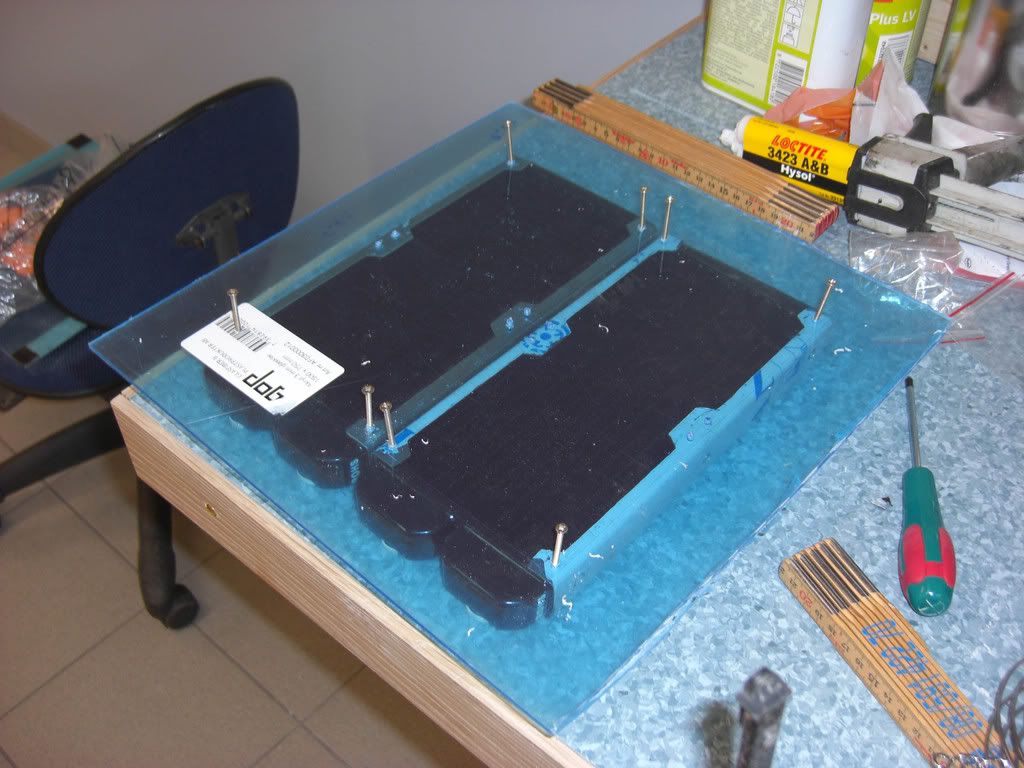

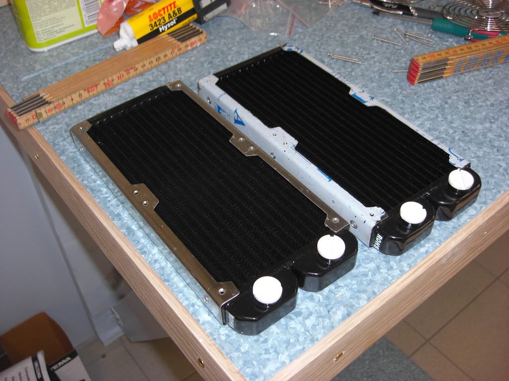

    Got my new radiators and nipples I ordered from www.vcore.dk 4 days ago, they are looking sweet. Then it was time to drill some holes so that I can attach the rads to the roof, to get things perfectly aligned I ended up using some fan grills taped to the Plexi, that way I was pretty sure I’d drill the holes perfectly aligned.
    [pics^]

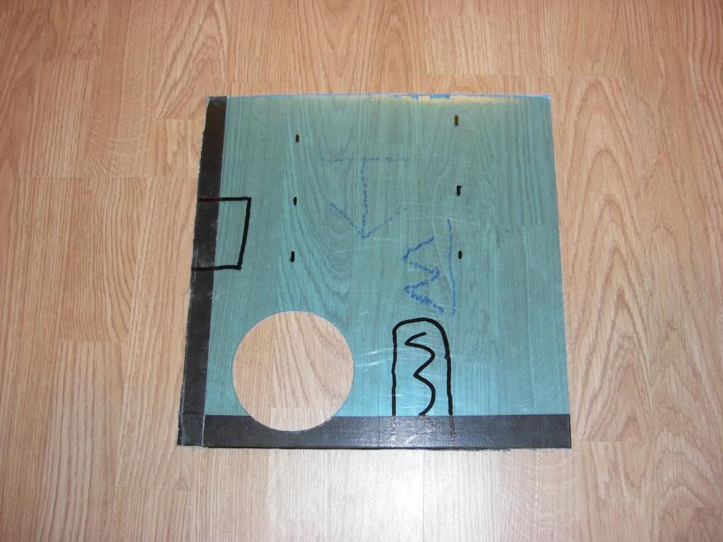

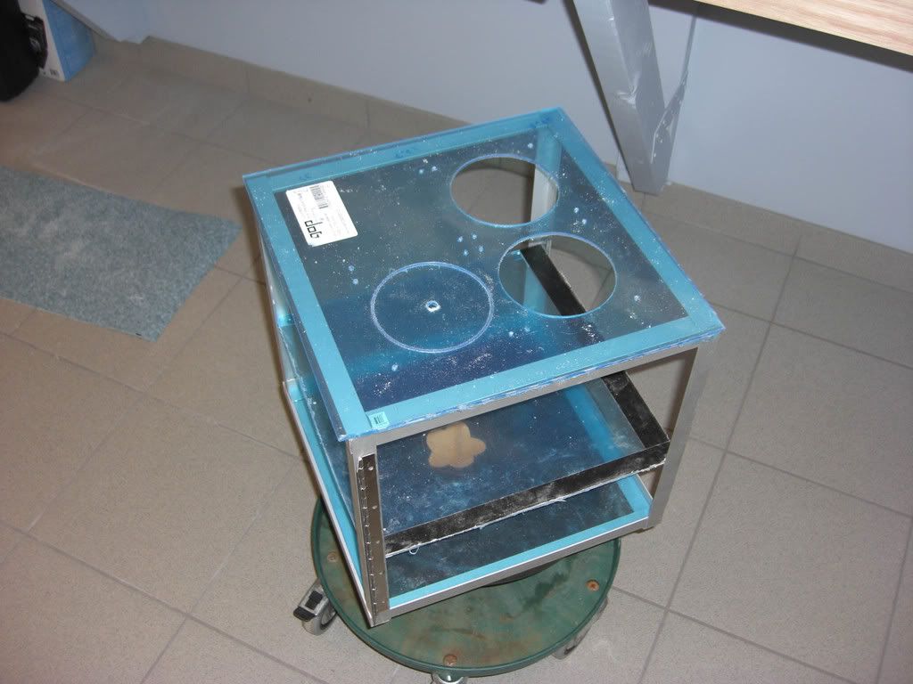

    Now I just need to drill some huge holes so that the air can come out from the case. Found a perfect drill with a round saw-like thingy with a 105mm diameter. Fortunately this worked, it didn’t crack the Plexi but unfortunately I ran out of batteries >_<.
    [pics^]
    Current cost of my build: 58€ + 100€ for the water-cooling gear.
    I have now drilled all holes needed to attach the walls to the frame, now i only need to buy some nuts and i should be set for installing my computer into my case :)
    Next time i will be able to work on my case however is Wednesday, so i guess i'll post an update with pics on Wednesday night.

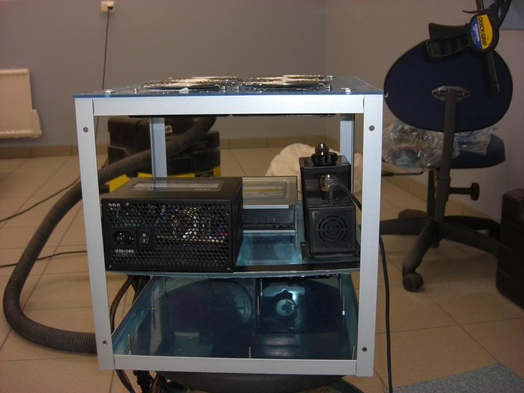

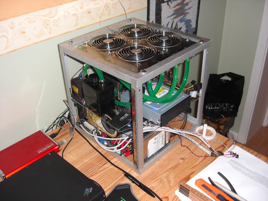

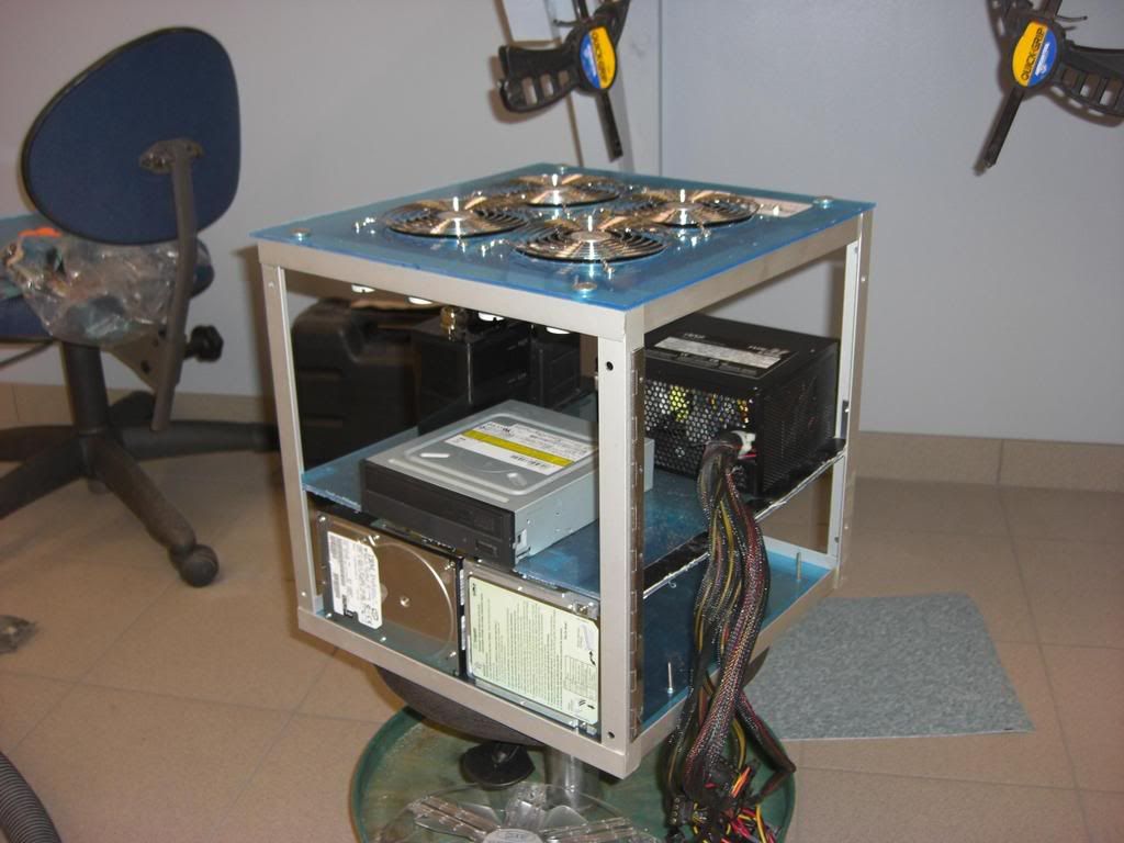

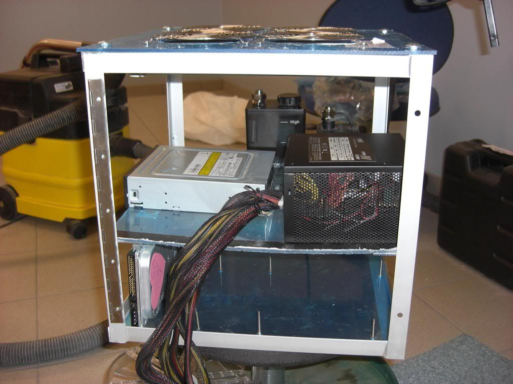

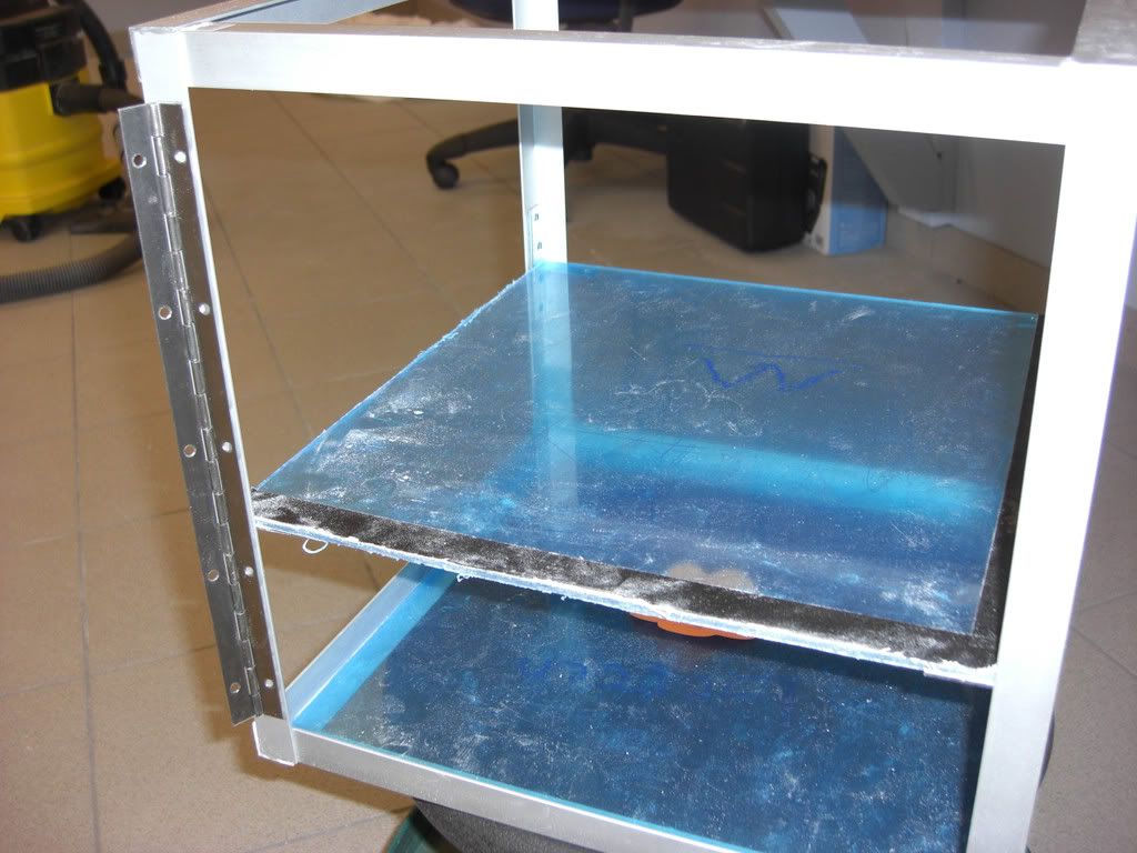

    Managed to get some pics of where I'm at right now, will most likely put the case together tomorrow (wednesday).
    [pics]
    Tomorrow, ^ that is what I'm going to work on, the middle floor. Hopefully everything will work out and I will make the next update from that computer :D

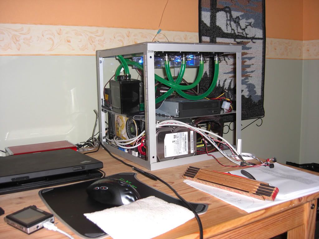

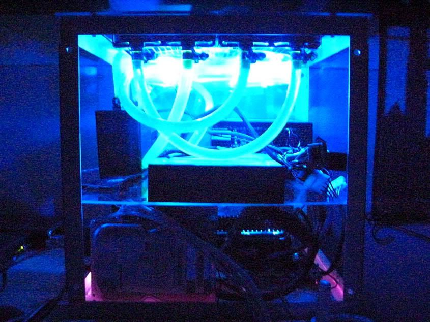

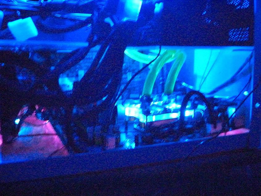

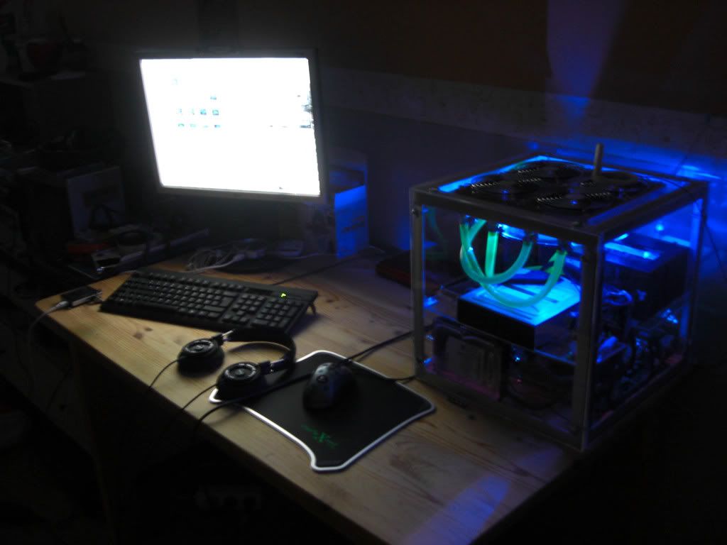

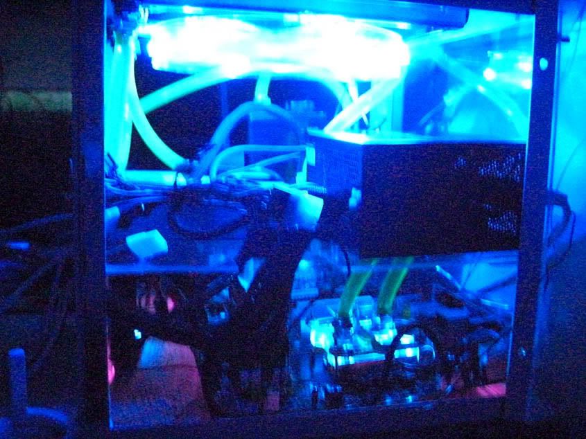

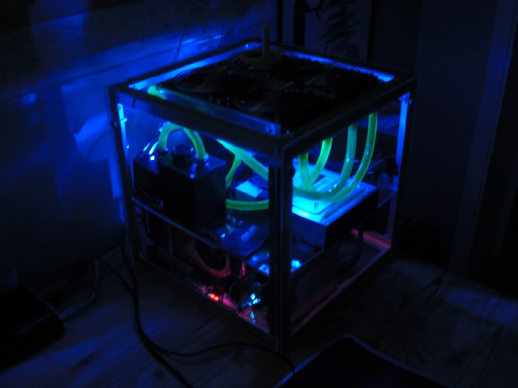

    As i was hoping Im making this update from THAT computer :D Its not completely done, gotta paint the walls and make a hole in the front for the DVD burner, other than that it's pretty much done :D
    Here are some pics of how its looking right now!
    [pics]

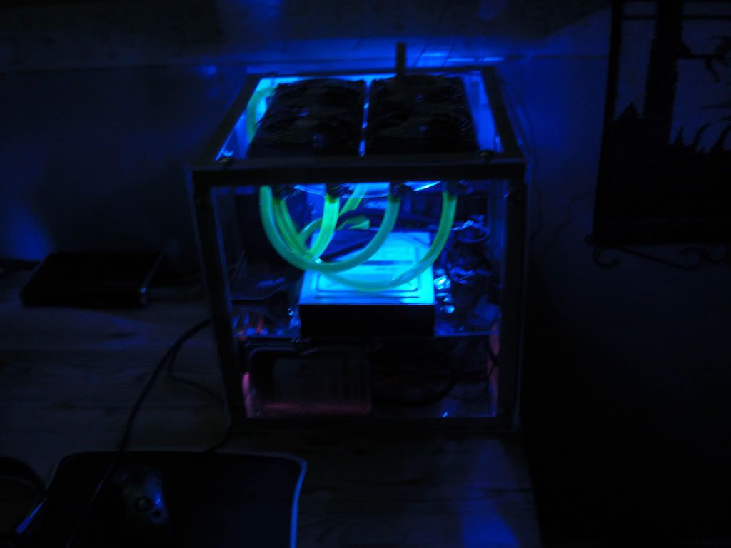

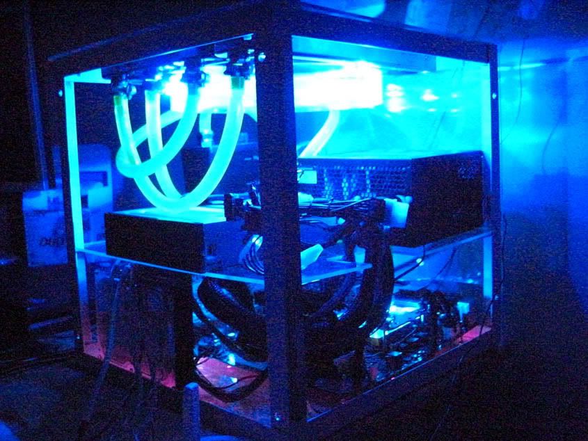

    [yay lights pics, couldnt figure out a good setting for my camera for these pics so they look like crap :/]
    Now that im used to seeing everything inside my computer im not sure if i will paint it or not :p

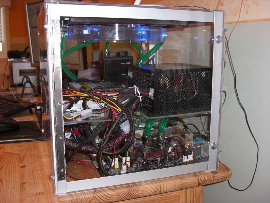

    I also managed to glue to right panel to the hinge, im not sure if its any strong since usually its pretty hard to glue plexi... -.-' Anyways, it seems to be working and im going to start glueing the left panel any time now, after that is done i consider this box done!
    [pic]

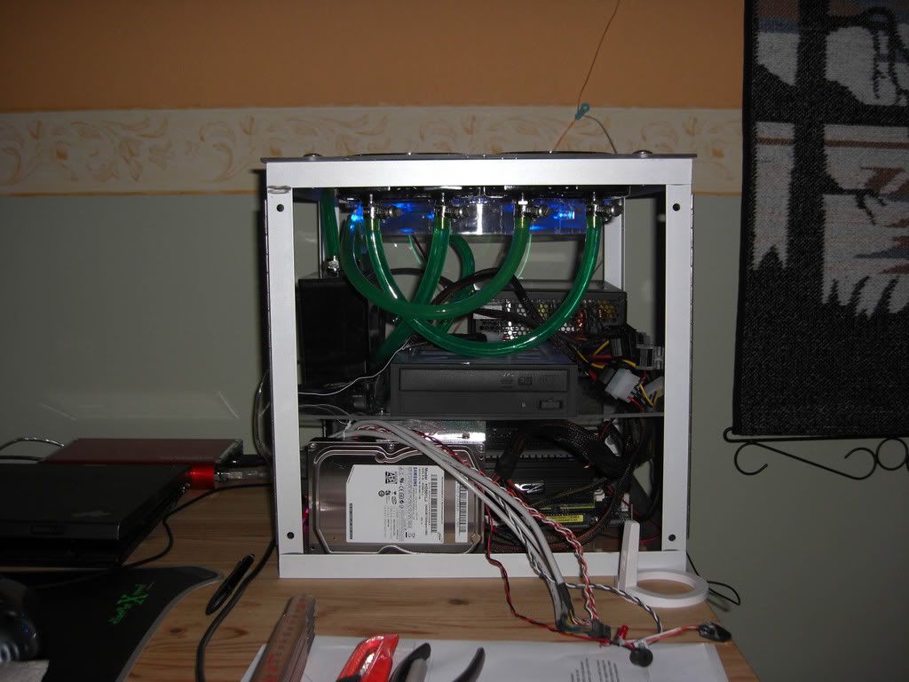

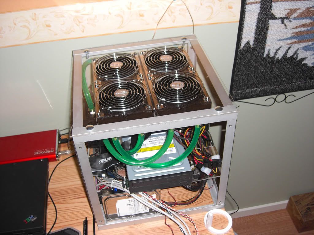

    Seems like im having some real heat issues with the case closed with all panels on.. Perhaps i need to make an intake or just install a second fan :/ Now im running the case with the left panel slightly open to let the GPU blow out its hot air instead of keeping it inside the case..
    Anyhoo it seems that i was able to glue both panels to the case and im pretty much done (not taking the heat issue into consideration :p)
    Case is now complete, I managed to take care of the heat issue by replacing the thermal compound on my GPU. I will possibly cut out some intake hole and add a fan to it if i feel like i need to. All in all this has been a great project and i've done something im pretty proud of.
    [pics]
    So lets wrap things up, this build has taken me about 2-3 weeks (not working every day), I've spent about 150-160€ and im more than pleased with the results. :hip:
    -tJev out.

    I like it, with a little bit of cable management, if that is even possible in that style of case then it will be hot.
    If it was me I would have used a coloured acrylic just to slightly mask the cabling, but I am just nit picking, you have done a great job...so far...Manage those cables:thumb:

    Overall I really like it. You may want to consider riveting in some more L-channel to support the acrylic that the makes the top hardware layer. It seems a bit stressed. :worried:

    Thanks, the top hardware layer is a bit stressed indeed, and that's because i made a miscalculation on the height of the GPU. So i had to put it in the second PCI-e port and raise the corner a little. The only things that are resting on the top hardware layer are the DVD drive and the pump/tank so im not that worried (the PSU is screwed onto the backpanel).

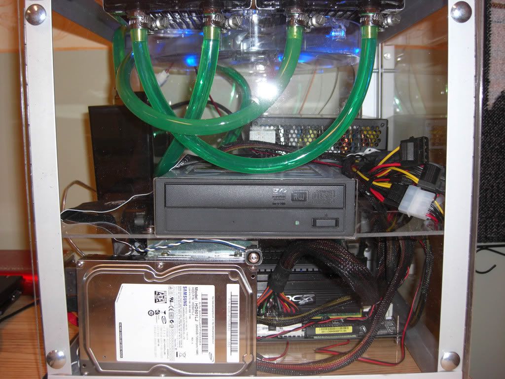

    Well the stickers where great for keeping track of which piece was which :)

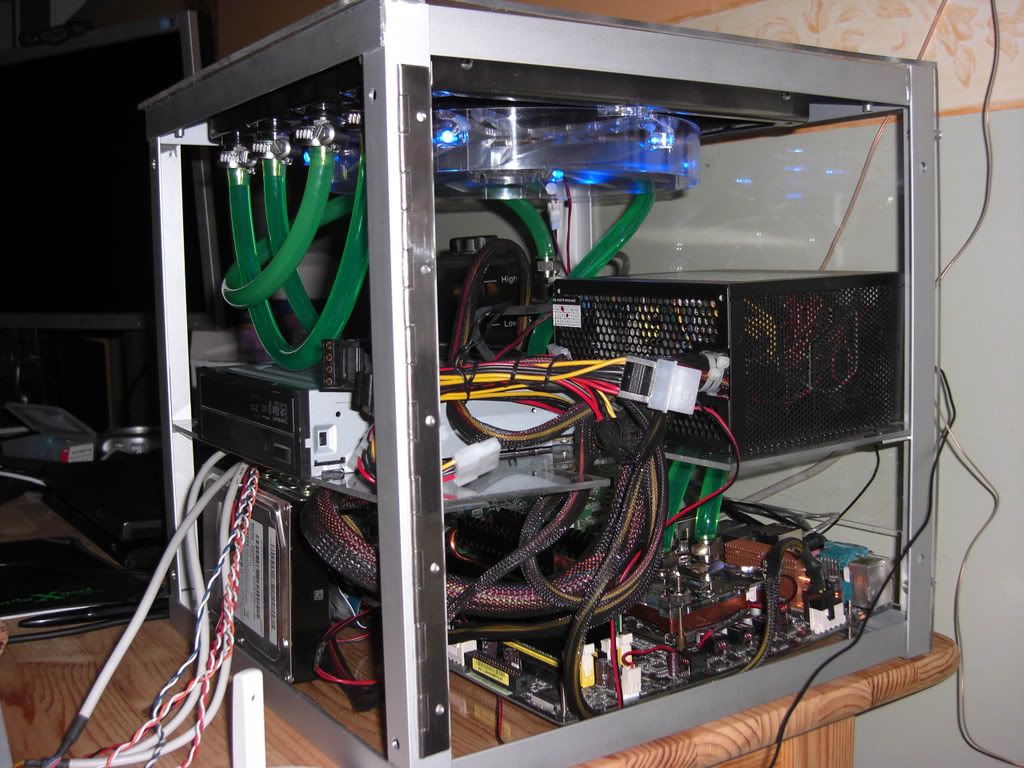

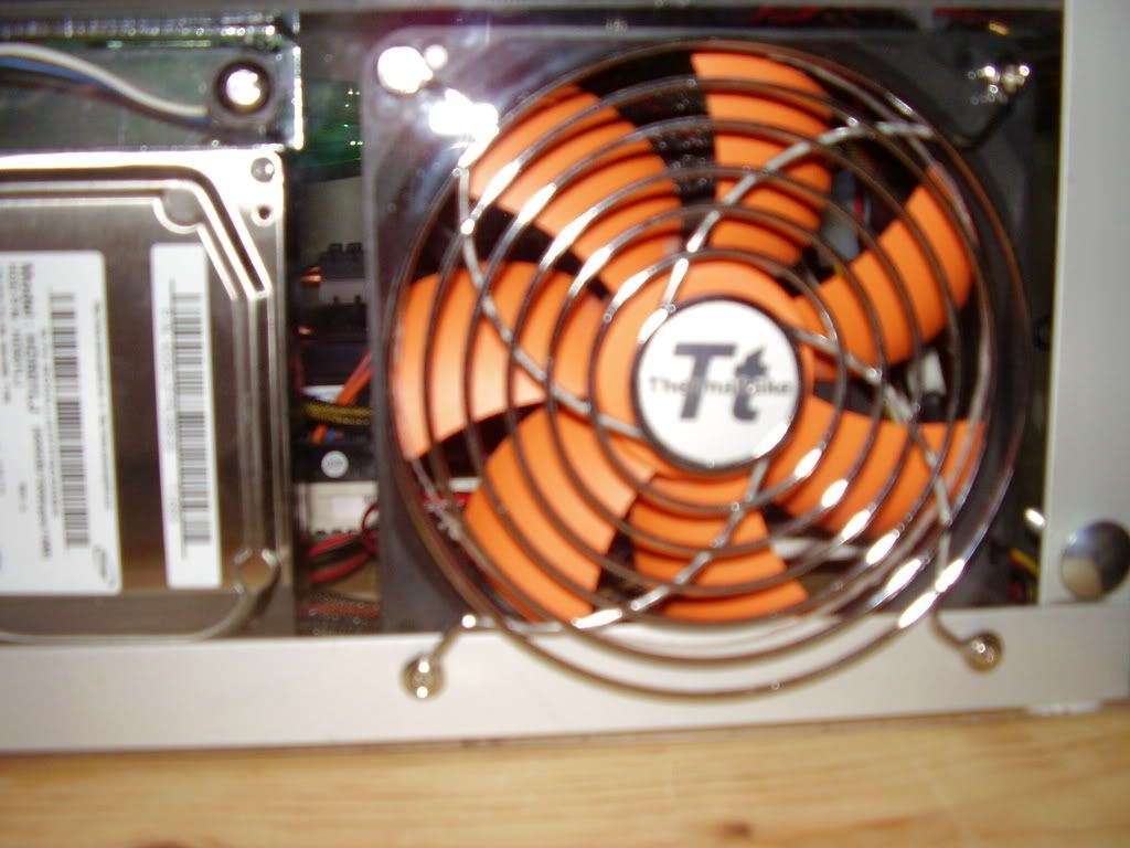

    Anyhoo, here are the pictures with the new fan installed, dropped most temps in my case by 10degC :D
    [pics]
    As you can see i had to drill thru the frame to be able to fit that 120mm fan. I was about to settle with an 80mm fan but my mates kept telling me I had to use a 120mm cause they are way much better, not to mention I have a fan controller for this fan as well :)
    Unfortunately I had an accident last night... the right panels hinge lost contact with the frame leaving the right panel hanging on two M6 bolts... I quickly roughed up the surface and reglued it. Im not sure how hard the contact between them are right now but it should be better now.
    If you have any idea's what i could do next, shoot :)

    looks like there is quite a bend on the middle shelf...... might be worth doubling up on the thickness of the perspex to give it a bit of extra support....

    yeah, one corner had to be raised 8mm to supply clearance from the graphics card, seems like I miscalculated the height of the graphics card.. Im not sure if it's enough of a bend to damage the plexi but for now I will let it be, cause of I change it I will have to change the front and back panel which is just a whole lot of work im not ready for right now.
