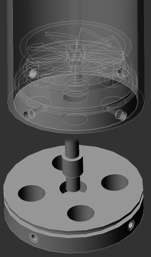

    I worked up in CAD one way to potentially solve the center rod flexing issue by fixing the end caps in a different manner.
    If you had an alternative method of holding the end caps in place (screws in from the sides maybe?) the center of the end cap on the inside could have a pocket where you could install a flanged ball bearing or just a sleeve bearing to hold the axle for the SpinFX.
    Just an idea.

    Thats cool but there's to much involved. The rod doesnt really flex. It's just that if you should bend the rod,... if you dont perfectly straighten it out again,.. it will be a problem. I'm I'm goign to have the company use stain steel rod but very thin, thin enough for 4-40 threads. This way if you should bend the rod a bit,... it wount be that much of a problem. NOW,... I do like the idea of using screws to hold the end caps on. If I did that,... instead of having a whole rod pass through the center of the reservoir,... I could only have small little rod nubs on each side. I wouldn't even need to use copper. I could use acrylic rod nub things. The only thing I dont like is that the screws would have to screw into the acrylic by means of acrylic threading. Acrylic threads are strong,... but its just the idea of it really. You dont have to torque the screws in hard because there just thre to hold the caps on. The o-rings hold the caps on themselves. OH! I have an idea,... I could drill a hole through the end cap and than have two holes on each side of the body,... I could pass a stainless steel rod through all the holes. each side of the rod is threaded. this way there are no acrylic threads. What do you think?

    I can't think of anything simpler or more cost effective than screws. And you'll really only need a 50% thread.
    And yes you wouldn't actually need ball bearings. A precisely shaped acrylic rod or even a drilled hole would suffice.

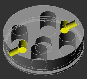

    But I did think of a way to fasten them with quick-release pins, even though those are kind of expensive at $1.30-$1.60 each. They would make the end caps ridiculously easy to remove though.
    or
    [​IMG] with hex or acorn nuts loctite adhered to the threads
    You would need a minimum of two per end cap. And they would insert from the side and lock into holes drilled partway from the bottom of the end cap.
    Makes the end caps comparatively easy to machine and now you don't have to use copper or stainless steel rod for anything.

    AHHH you nailed it! I was thinking the same thing!!! Screws would be the easiest way to do it. The next way was the quick release but they are kind of excessive. Another way I though tabout trying to do is make my own locking mechamisn from the inside of the cap. Using two small acrylic rods and a spring;)The spring pushes the rods outwards into the holes. You push the rods in to get the end piece off. This is the way I would like to do it. It would be fairly easy too. The only thing though is that I would have to rethink the whole propeller assembly. Because the rod does go from one end to another,... to have a rod that long, about 1" glue from one side and not the other,... it might not be all that stable. I dont know. I'm thinking if I sink enough of the one end of the rod into the end piece and then glue,.. it would be fine. Its only 1". I dont expect these reservoirs to be bomb proof you know?!?! that would be the easiest way to do the prop assembly because I wouldnt have to change anything.
    You guys think I should hold off sending these to acryan and experiment some more? Hmmm,... I really should give it a go. Oh wait,... how would I cut the end pieces?!?!? With teh new end piece I dont need to drill all the way through the end peice because the rod doesnt go from one side to the other. But to cut the end piece I need that hole for the bolt! Damn,... I wish I had a lathe. Wait,... I have an idea,...

    You could still drill all of the way through the center, then once the end piece is finished just seal the hole by gluing in a short section of rod. That rod could then be acting as the peg to hold the axle of the sfx.
    The new end cap (if designed carefully) could be swapped out with the older design without changing any of the other parts.
    Let me know if you need the CAD files.
