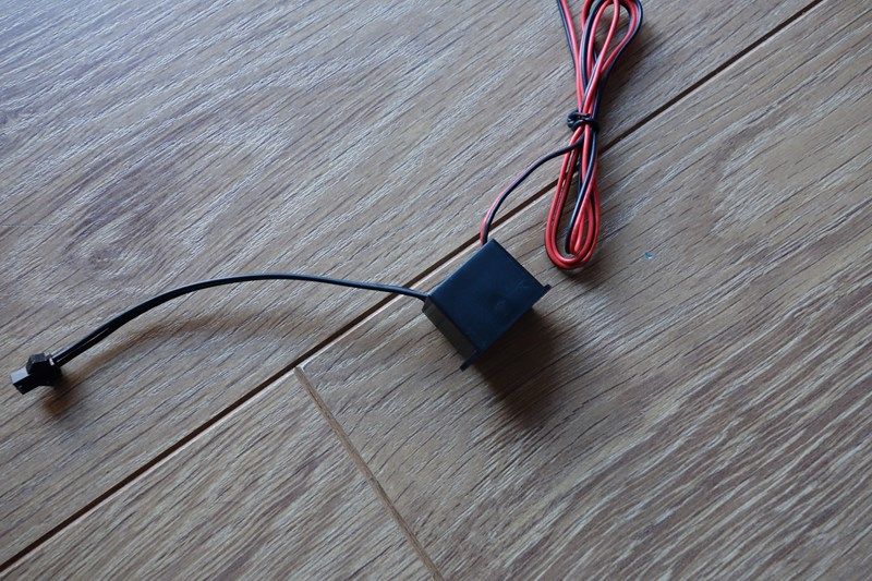

  14. Cheapskate
    13 May 2007
    11,900
    1,577
    :lol: Doubt you could pull much power through it. I would look cool while it was burning, though.
    Edit: Trying to chase down the source of that orange wire in the PSU only adds more questions? How did you take that pic of the PSU AND get your foot in the shot?
  15. eucalyptus
    eucalyptus I am 19 and Swedish!
    29 Sep 2015
    194
    You can get the El wire for a few bucks on Ebay in different colors :)
    Alain, it looks amazing - as I always say :D
  16. alain-s
    alain-s Minimodder
    12 Jan 2011
    445
    88
    Thx Storm
    Idd why get a other one. ^^ Here is the product you can buy it for a buck of ebay.
    http://www.benl.ebay.be/itm/3612517...49&var=630597294764&ssPageName=STRK:MEBIDX:IT
    scroll down ^^
    Scroll down :)
    K Will start with the foot question. I think I was in this position when I did the shot.
    Don't ask me how I did, I still cant believe that I did that.
    The EL wire needs around 3volt to work with a small controller. But you can also buy the EL wire with a kit that uses 12V.
    I have to connect every wire to this adapter.
    The cable will run from the connector on the PSU to the adapter.
    Thank you Sebastian :)
  17. Cheapskate
    13 May 2007
    11,900
    1,577
    Ah, see. THAT was what I was trying to find. I seem to remember that they needed an inverter.
