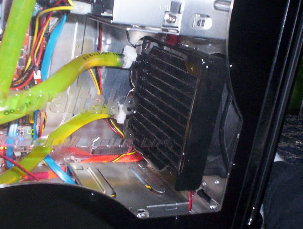

    Just updating on a couple things I did, and I'm also adding a lot of new pictures. I'm now using a Fan Master to control my Sanyos and I cut a big hole in the front of my case for better airflow through the radiator.
    That's all of them for now :D

    Nice work, Doomsayer, and that should help a bit, but I would mount the radiator fan behind the radiator so that it sucks the air through, rather than in front so that it blows the air through. you will find that knocks another degree or so off your temps.

    You might consider flipping your radiator 180 degrees so the barbs are on the outside.
    No performance increase but it would make the tube routing a bit more elegant.

    You mean turning it so that the barbs are right near the window? I dont think i can do that because the rad will get in the way of the window, and I dont think it will look any better anyway. I'm just debating on whether i should change the order things come in my loop, or move the T line to a different part of the loop. IDK! I just wanna do something that will make the inside of the case look as tidy as possible. Any ideas from the crew? I know Nexxo is all about making stuff look professional. THIS CASE NEEDS MORE MODS!!!
