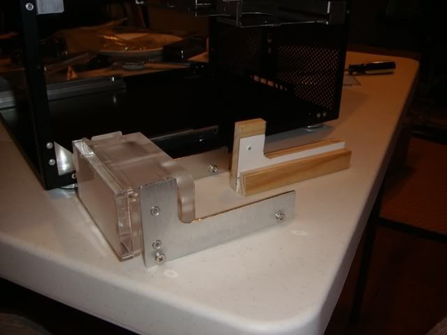

    Here is a pic that shows one of the brackets I made with the "paper doll" mockup mounted on the router template I made. I wanted to have matching brackets so making a master template made sense.

    Looks pretty good. Did you round the edges of the alum by hand or with a power tool?

    That is the beauty of using a router, the corner fillet radius is the router bit radius. The template can be terrible in the corners because the bearing on the bit never sees it. So I use a table saw to give me nice parallel and perpendicular edges and I don't care about the back cut. The bracket unbolts off the template as you see it minus the tapping for the rail screws. All I do is use a file to break the sharp edges.

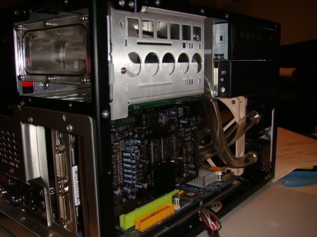

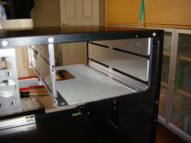

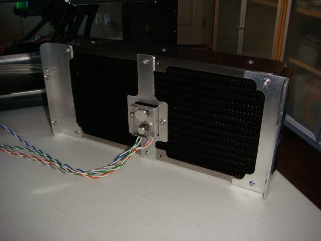

    Here are some more pics:
    All the brackets were made on my routing table. I wasn't going for looks, mostly function. But I didn't want to complete the job knowing that it had crap brackets. I also didn't want to butcher the case completely so with the exception of the 3.5 drive bay. I can put all the original parts back in.
    The tubing was just used for mockup purposes, I uses Norprene in the end. Also, the routing changed slightly from the pics in that GPU waterblock & radiator inlets are on the bottom and the outlets are on the top.
    The reservoir is my problem in that it is too small for the flow and the bubbles never clear. I think I have a fix for that, I'll be testing my idea out when the parts come.
