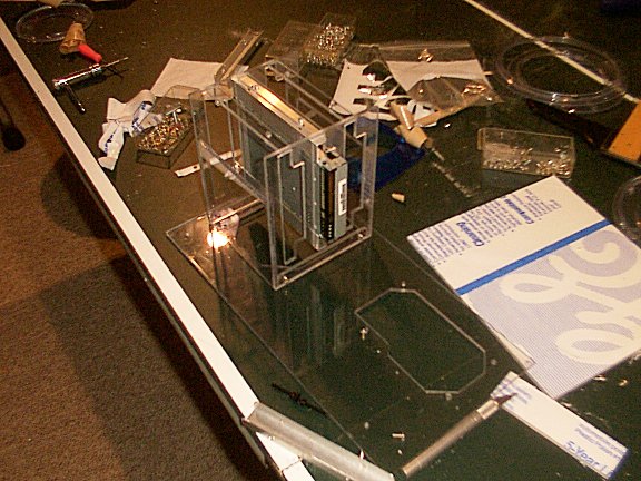

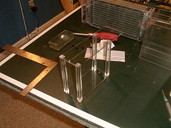

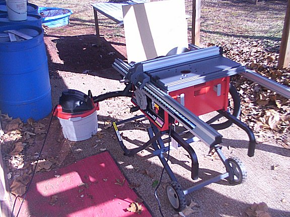

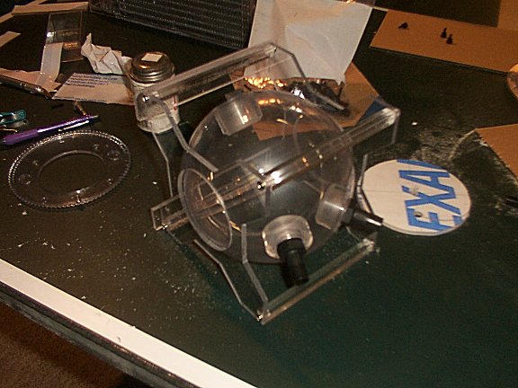

    The finish line is eerily close after how much progress I've made today. Here's what took place in a 7-picture update. I got my table-saw setup outside the basement door with the shop-vac in tow to eat all of the dust it produces.
    And my entire day was fueled by orange soda.
    The first part I needed to make was the pump/shelf support. Luckily the new table saw is accurate to 1/64th-inch because as originally glued together it was soooo tight fitting with the rest of the parts that I had to cut 1/64th-of-an-inch from each side so that the other parts can slide in place.
    It supports the weight of the shelf and will eventually hold the pump as well.
    The drive cage now slides in nicely without getting stuck.
    This turned out nothing like I was anticipating but the end result actually works better than anticipated. This single bracket allows the reservoir to be remounted within at different angles so that even if the case is reconfigured the reservoir will remain right-side-up.
    And slides into the case like so.
    And that's what I managed to do in 8 hours today. On the agenda tomorrow are the 3.5" drive cage, and tackling the finishing touches on the outer panels that I've already cut to size. Should be interesting but I'm hoping to be 99% or 100% done before the end of the week.

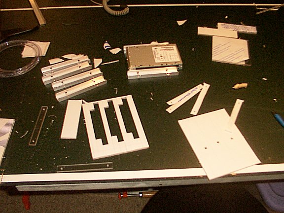

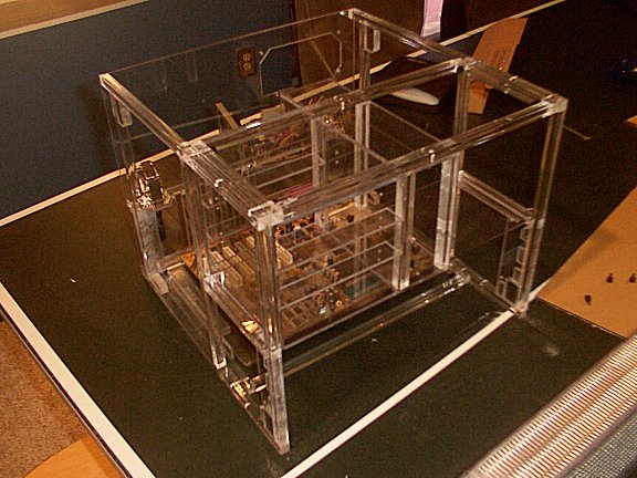

    Only a little bit of progress today because I'm moving kind of slow. The faceplates are done and the panel for the switches and indicator lights is almost done. I just need to do some drilling and tapping so that all of the parts mount to the frame. As-is they fit snugly because the tolerances are so close on the parts.
    The 5.25" drive cage and reservoir frame can both be swapped AND rotated 90-degrees in either direction to allow for different standing configurations for the case itself.

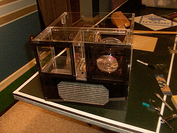

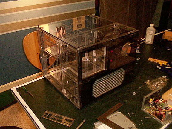

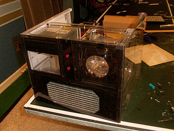

    Lots of progress, AND set-backs today. I'm not where I wanted to be, but I am very close. The front is finished. I also added some reinforcing tabs to the 5.25" cage so that the drives only need screws on one side to be secure.
    And the frame is even more reinforced than before.
    And I got the 3.5" drive cage well underway before my last remaining scrollsaw blade broke 2 MINUTES after Home Depot closed. :(
    So everything is done except for that and the soldering I need to do on the switches. Which means more progress will come on Tuesday, when I plan to be finished with all of the machining.

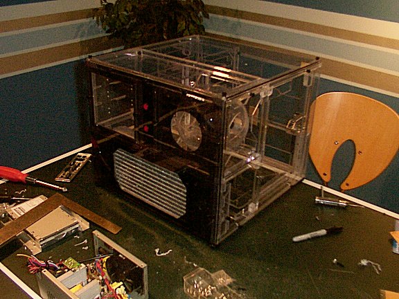

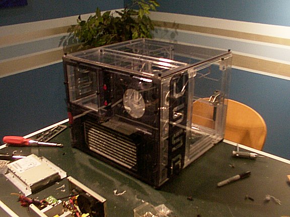

    The case itself is complete. There are two remaining details I was unable to finish today but all the crucial pieces are completed. First I finished the 3.5" drive cage/duct.
    Then there were handles to add to the sides, and a heap of holes to drill and thread for affixing all of the various parts to the frame.
    Thursday I need to visit a small local computer parts store to buy .100" pin header socket tails to finish the power and reset switches, and I need to get a good measurement set to add the mounting holes for the pump. Those will be the finishing touches. And after those are added I'll be back with much clearer and more detailed images. Ones not taken with my crappy cheap-as-free camera. :rolleyes:

    The color is up to the client, but I atleast now it going to be some kind of UV reactive dye. We discussed it a long time ago but I don't remember what color he was going to go with nor do I know whether or not he changed his mind since then.
    And here's the only reasonably priced source that I've found for acrylic hemispheres ranging in sizes from 3/8" to 6".
    http://www.kitkraft.biz/catalog/6_Clear_dome-p-2550.html
    You'll need a step drill bit in order to make the holes and some acrylic rod to make the threaded inserts.

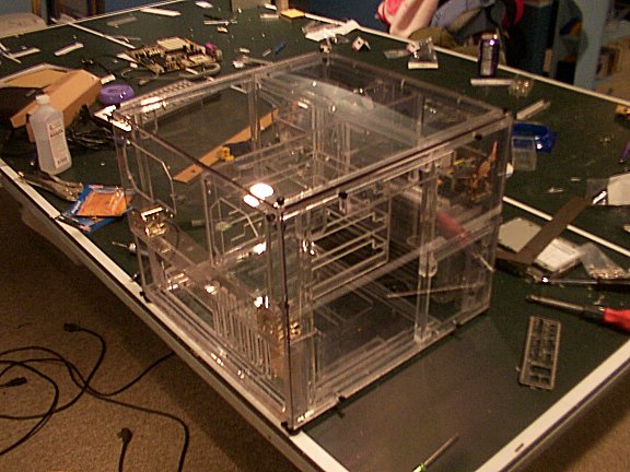

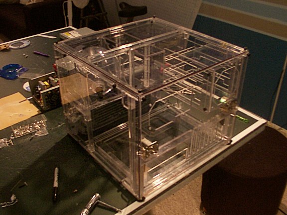

    This case is finished. I added the remaining details like pump mounting holes and wiring the LEDs and switches and now this project is being handed off to the owner.
    All subsequent updates will be provided by DeViL_909.
    I'd like to thank everyone for their patience, support, and feedback. Especially DeViL who's been trying to get this made for 3 years now.
