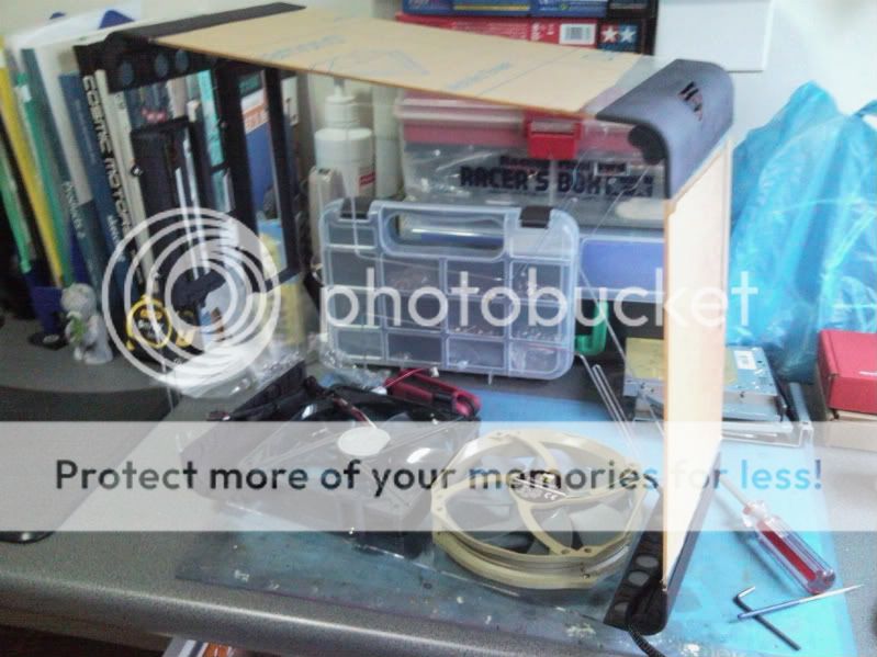

    Just a quick update. I began assembly this morning and am I psyched!!
    Quick snap with my phone camera.
    Those twin 140mm fans sure looks huge in the case!

    Looking good :thumb: also is the GPU going to be using some kind of slot extender? I must have missed the info regarding that :duh:.

    Thanks! Ya I'm using a flexible PCI-E riser. :)

  17. jrs77
    jrs77 Modder
    17 Feb 2006
    3,487
    103
    Spotting familiar language in the packaging of the glue :lol:
    It's a shame that the two fans are not the same model tbh. Looks a little bit messy this way.
    Would look really cool with fully transparent fans I guess :brrr:

  20. Waynio
    Waynio Relaxing
    20 Aug 2009
    5,712
    211
    :D I bet, but it turned out sweet :clap:.
    Why the different fans though?
