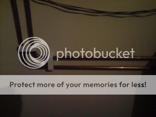

    As some of you may know, and as I mentioned in the Minecraft thread, I had a slight and unexpected issue with condensation on this cooling system. In fact, the issue was so slight that water droplets hung like pearls on a string along my coolant pipes, and that is not something you want to enter your computer room to. So, finding the PC crashed at boot sent chills down my spine, and I promptly shut the system down, turned up the room heater and gave it a few days to dry out properly before starting it again. Luckily, nothing seems to have taken lasting damage, and I have now spent a few moments redesigning and stregthening the system against condensation.
    So here we are.

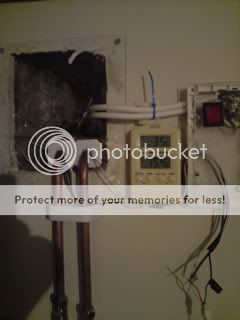

    This picture shows where the coolant pipes enter into my computer room, and right next to it is a thermometer. The top reading shows current coolant temperature, and the bottom reading shows room temperature.
    This next picture shows the coolant pipes going down my wall and bending towards my computer. Imagine these holding heavy water droplets...

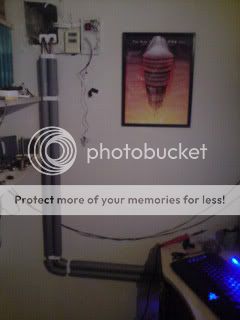

    And finally, this next picture shows where the pipes terminate into tubes that lead coolant into, and out of, my computer.
    On the following picture I have clad the pipes with tight-fitting pipe insulation, and only the part where the pipes curve down my wall is still naked at this point.
    And as you can see here, already water droplets have started to condense on the pipes. The system has not been running for long at this point, and I immediately clad also this part of the pipes.

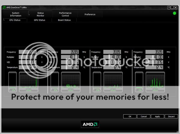

    Next I am showing the current reading from AMD OverDriver to give an idea as to the effectiveness of this cooling system. I know I can push this chip further, but this is the point I
    m currently at. Oh, and coolant temperature has climbed to 6.3C, and I have shut down the radiator fans...

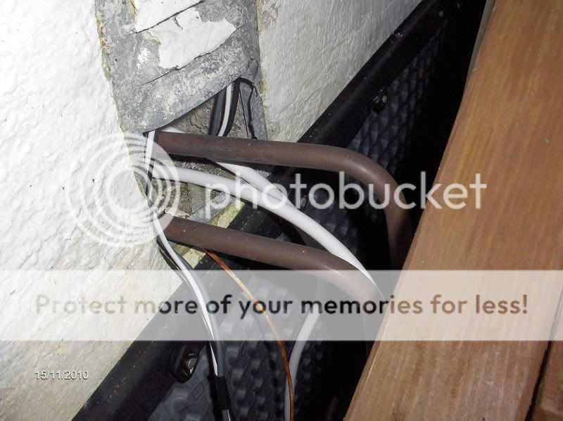

    Okay, so this is the point the pipes go through my wall. Luckily the computer room has a wall vent situated perfectly for my purposes. :D
    And here are two pics showing the tank, radiator and pump assembly sitting under our terrace staircase. I have protected the fans from the elements as much as possible while still retaining airflow. The pink hue from the coolant is due to 2liters of antifreeze, and the pump sitting in the middle of tank is an Aqua Medic Oceanrunner 3500. :D
    The insulation job I did on the pipes has worked wonders by the way, however the point where the pipes bend from the vent and down my wall is still bare as I cannot insulate this part. I can live with condensation forming there though, so it's not a big issue.
