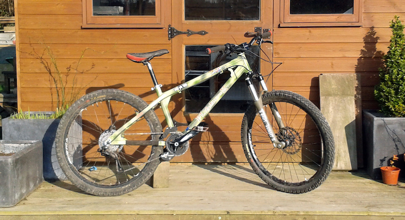

    Mine at the moment, can't wait to get back home from uni now and ride!
    Bought a bike years ago and it has slowly been upgraded, not a single component is the same now.
