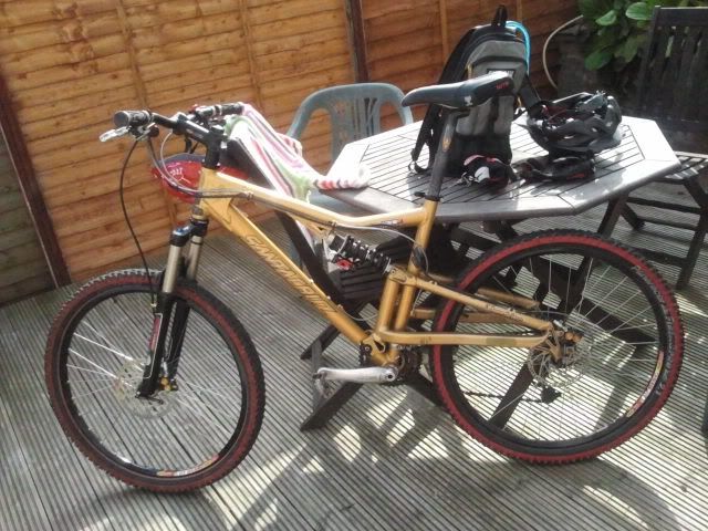

  5. dullonien

  6. steveo_mcg
    steveo_mcg What's a Dremel?
    26 May 2005
    5,841
    80
