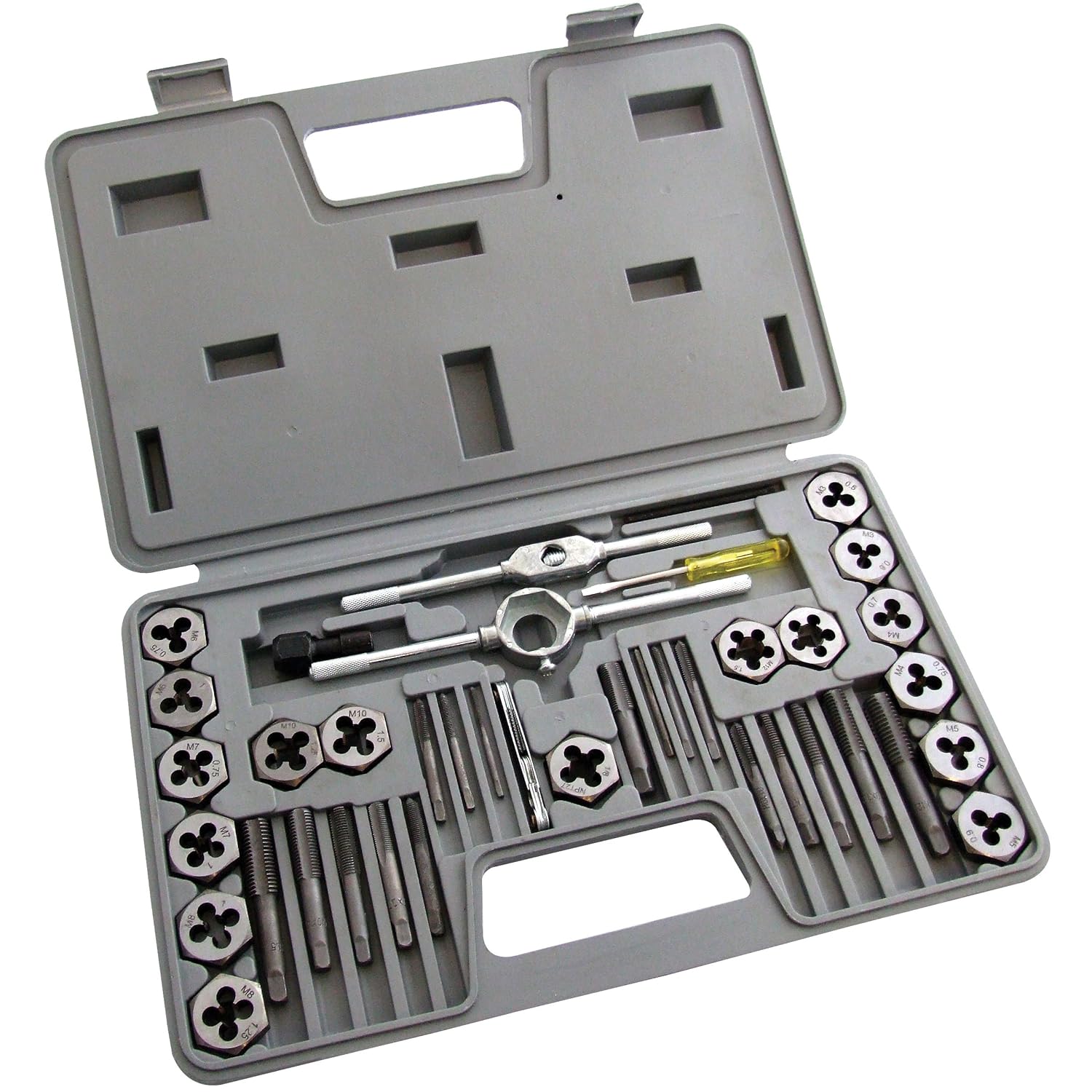

    Does anyone know if this kit would work?
  7. Big_malc
    Big_malc Minimodder
    7 Sep 2010
    1,626
    83
    6/32 unc tap
    M3
    tap wrench / spanner at bottom of page.
    If you go for the sets of taper second and bottom can be expensive but in plastic and ally change of breaking are very low if your slow and gentle but works out about £35 for m3 , 6/32 and a spanner
    If you wont to cut costs just use a second or a taper for about £7 as the thread will set in it fine work out about £20 for m3 , 6/32 and a spanner

    Through bolts+ bic pen section standoffs.:thumb:
    If you really want to tap, I'd recommend getting something decent with a corresponding drill bit. I've never had the smaller, cheap, Chinese made taps to work right.
