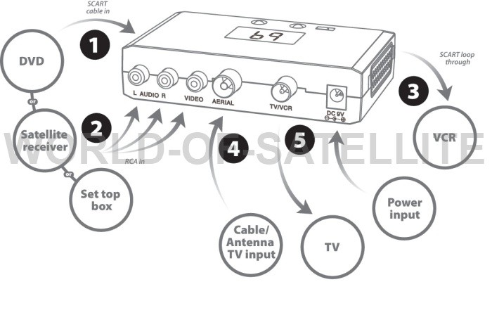

    I keep seeing these but they look to be the opposite of what i need:
    Would that take the RG6/RF input and let me use the scart loop through as an oupout (scart>composite/left/right)
    Any ideas?

  9. saspro
    saspro IT monkey
    23 Apr 2009
    9,462
    284
    That wouldn't take the RF input. It only outputs from comp etc to scart on passthrough and modulates to RF for the TV.
    I'd give the VCR another try
