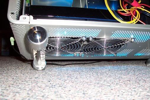

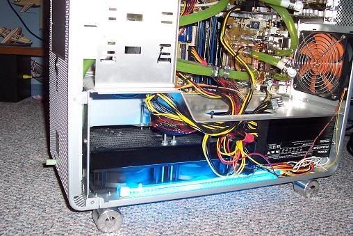

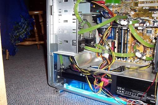

    Here's how I did mine:
    There's basically no space between the radiator and the PSU, as it's the Antec Phantom 500, which is extra-long. Still, it all fits. The radiator is held in place by six very long bolts that run through case, fan, and radiator.
    The front fan is gone, and the radiator goes just about as far into the hole as it can. The two pumps are side-by-side in the bottom CD-rom bay. I'm going to really isolation mount them... some day.
    And, seen from below, the huge ugly hole in the bottom of the case. The fan grills are on there for a reason, those fans can take a big chunk out of a finger at full speed.
