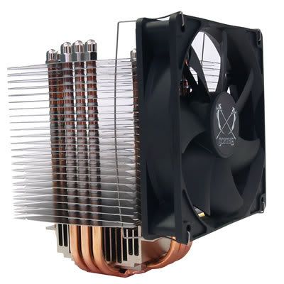

  16. Hazardous
    Hazardous What's a Dremel?
    21 Jan 2004
    2,614
    I agree... especially if you intend OCing! The Scythe Ninja Plus [Rev B] is another good 'un... albeit a big/heavy bugger of a thing....
